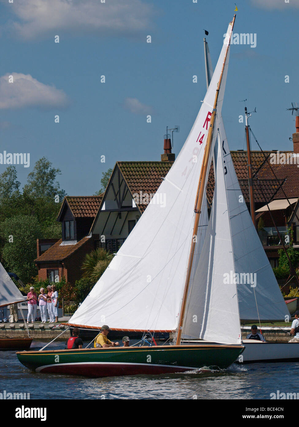

    Bamboo spars were used for many years in the UK for many classes of boat until the source of bamboo in China stopped at WW2. Some classes moved to wood and some to Aluminum. I know of classes of racing boats up to 23Ft and weighing around a ton that used them. They lasted a long time when kept undercover out of use.
    I'm believe this class did, http://c8.alamy.com/comp/BCE4CN/reb...rt-at-three-rivers-race-at-horning-BCE4CN.jpg
    and know this class did, http://www.yachtsandyachting.com/photos/thamesarater/2004upperthames1.jpg.
    Though they weren't as extreme in mast length then.
