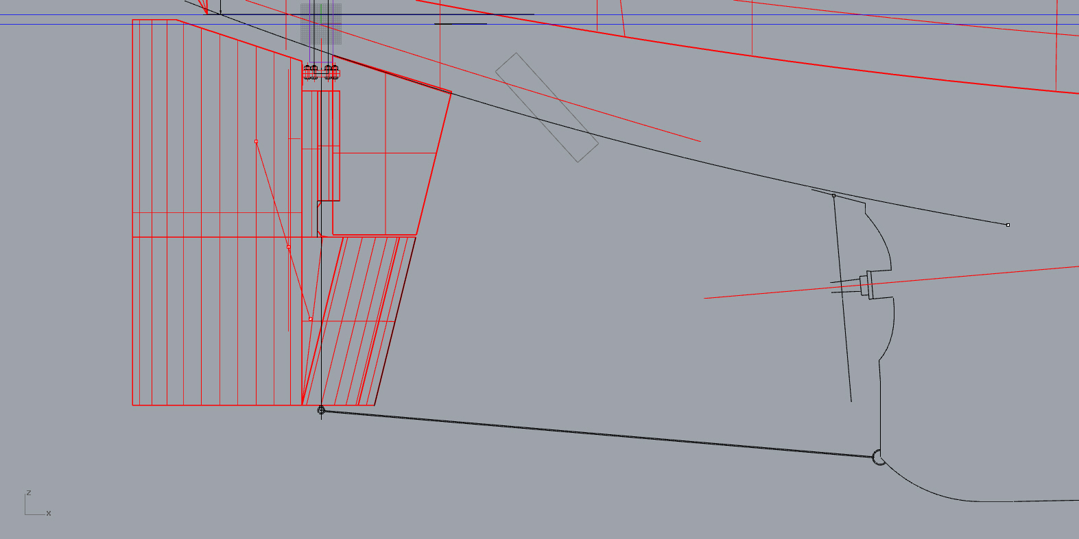

    No intention of changing the keel - question was about the skeg / rudder because these need rebuilding anyway due to corrosion - so the opportunity presents to tweak and maybe improve the design.

    Yes. With a full skeg for a balanced rudder the skeg is a foil in it's own right and supports the heel bearing. Same as adding a balanced rudder behind a full keel, the gap needs to be around 30% or greater of the foil chord length ( rudder width) . There are a myriad of ways of designing the heel bearing support strut. I've designed a few that way, but more commonly the changes are to actually change an attached rudder to the design you currently have which is the best compromise of strength and balance.
    You can add a bit of rod as a line skid that attaches to the skeg, overlapping the hinge gap. But you really need a significant sweep in the LE of the whole assembly to shed lines.
    The better solution commonly applied is fitted from the keel to an articulating fitting on the hinge line at the bottom of the rudder. Small diameter steel rod, chain and wire rope are usually used .

  7. MikeJohns
    Joined: Aug 2004
    Posts: 3,192
    Likes: 208, Points: 63, Legacy Rep: 2054
    MikeJohns Senior Member
    Line guard general arrangement shown on a semi-skeg balanced rudder.
    As for balanced sailboat rudder supported by a full skeg: it's the same as any fully skeg supported rudder except the heel support is extended to create a gap of at least 30% of the rudders width between the leading edge of the rudder and the trailing edge of the skeg or full keel.

  9. MikeJohns
    Joined: Aug 2004
    Posts: 3,192
    It definitely works when overrunning a floating pot line or a set net and keeps ropes and lines out of the prop and rudder.
    A pot with a buoyed line has an anchor of sorts, a float and from the hull/keel enough friction to straighten the line up before it starts to drag past the hull. The float usually passes in contact with the vessel side or even partially submerged. It's the float that has the buoyancy to pull the line up quite quickly especially if partially submerged and can then lodge in the prop or the rudder. A line fitted apparently works well although I don't use it on my own boats.
    As for the semi balanced partial skeg rudder picking up lines, it might at full articulation of 35 degrees, but at 10 degrees or under with a NACA 0012 type section it's unlikely as there's too little portion ahead.
    The partial skeg in my drawing isn't sloped to shed anything, just to give a better planform.

    Very useful again, thanks. It had nor occurred to me I could do the keel cable from a balanced / horn rudder - but yes, if you take it from the line of the rudder stock it should work.
