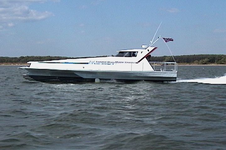

    We were flying along in one of the demonstrator/scale models we built when the control system had a malfunction that caused the craft to pitch up and literally "take off" from the water. It landed with a huge splash but quite stably..we likened it to a duck's landing. In pic below the foils are only supporting about 80% of the craft but we often flew with all three hulls clear of the water surface.

  12. BMcF
    Joined: Mar 2007
    Posts: 1,237
    Likes: 226, Points: 63, Legacy Rep: 361
    Location: Maryland
    BMcF Senior Member
    Those two vessels sure do look familiar... ;-)
    But to the back and forth regarding aircraft v. high-speed ferries; the discussion ignored a key factor that makes the comparison moot in many cases. The majority of successful fast ferry routes are not, or were not, competing directly with aircraft because no aircraft routes were present or, in many cases, even possible. Where fast ferries were introduced on routes where there was viable competition from an airline or even a conventional slow large ferry, they didn't fare well.
