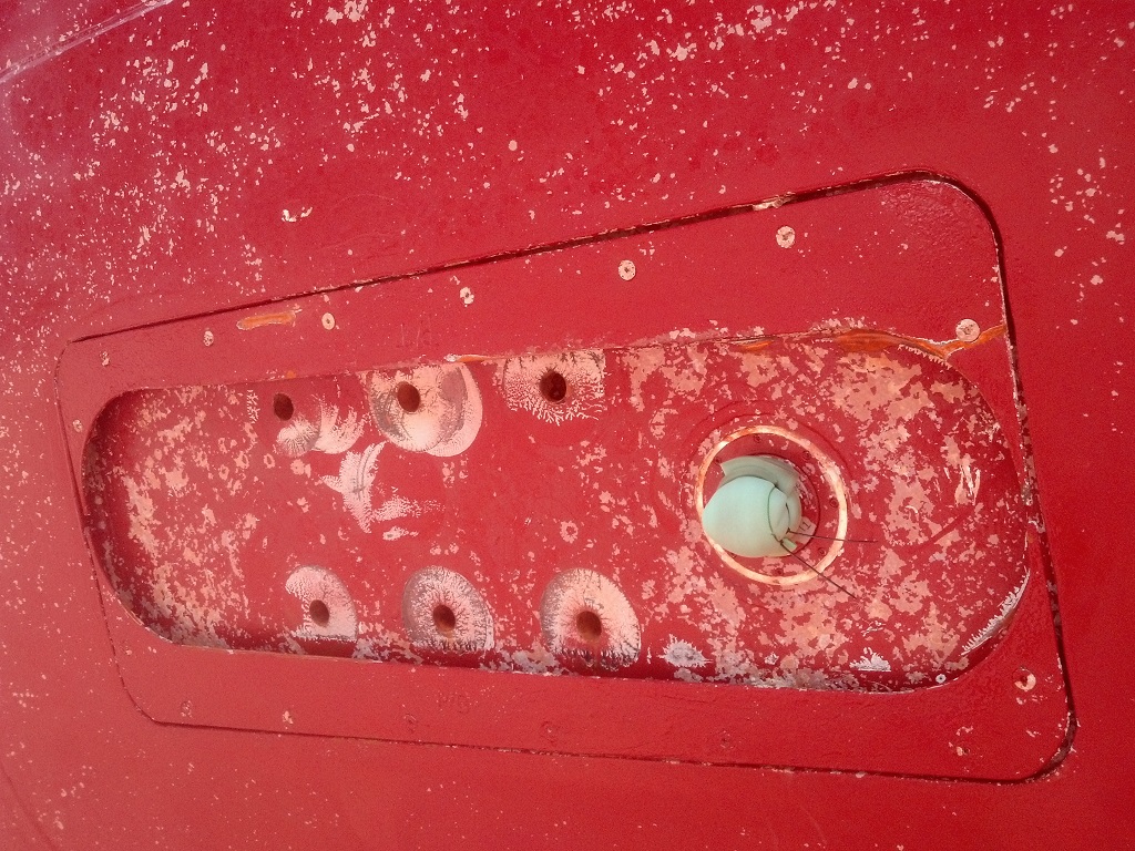

    In addition to Bill's commentary (that no cat's have flipped - commercial cats at least), the foundations for the foils are designed, well, that's how we design them, to break free under a given load.
    So all you do, is lose the foil - not the hull. The foils nowadays have a little GPS type tracker sender unit inside for locating and retrieval later.

    Actually that is correct..the foils are equipped with an acoustic "pinger" that is activated when the cover plated is ripped off a water-contact-activated battery embedded in the foil mounting flange along with the pinger. Then a locater is brought to the area where the foil was lost to find and, hopefully, retrieve the foil.Of course the "MOB" function of the vessel's GPS/Nav system is what marks the spot to start searching...assuming someone on the bridge had the presence of mind to hit the button. ;-)

    Exactly. And if all goes as designed, you are left with a foundation that is undamaged and ready to accept another foil. Like this one, for example... The stub of the broken actuator shaft is still in place in this pic.

    Neither of those would be practical when talking about the abrupt departure of an appendage that can weigh more than a ton that leaves a vessel moving at 40 knots at the moment of separation... ;-)
