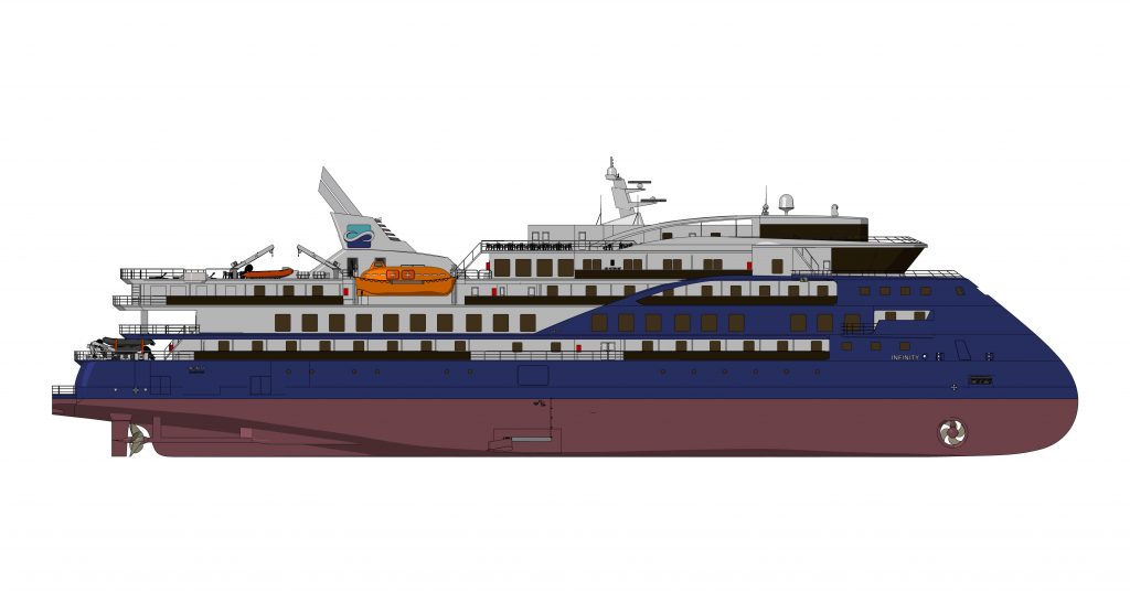

    Tz3dcom, just to add, the bow you show in post #1 is a chined modification of the Ulstein Group Asa X-Bow (TM). It is not an axe bow ( File:Verschil tussen een conventionele (441) en een bijlboeg (442).JPG - Wikipedia https://en.wikipedia.org/wiki/File:Verschil_tussen_een_conventionele_(441)_en_een_bijlboeg_(442).JPG ) or a ram bow ( File:USS Zumwalt (DDG-1000) at night.jpg - Wikipedia https://en.wikipedia.org/wiki/File:USS_Zumwalt_(DDG-1000)_at_night.jpg ). In both the ram or axe bow, the configuration of the waterlines above the DWL is linear whether the stem is vertical or sloped aft. Your bow appears to show distinct tumblehome which is the key feature of an X-Bow (TM).

    Those are all still atlantic bows, the designers are just playing games with the cutwater to get more LWL in minimal (SS 2-3) sea states. In the significant event, those bows function just like a typical flared atlantic bow, which is much different than the shape proposed by Tz3dcom.

    Hi Jehardiman,
    Thanks for your more comments. But I don't think my bow is a X-bow ,because X-bow without the bulbous bow and chin line.
    You can see below section of my bow ,It's different to the X-bow.and I think it's a new hybrid bow design. It may work wellin most seaway . About the wave slap to the forward window.I also do not think it's a problem ,because today a lot of low profile sail boat with forward window and without the Atlantic bow. as well as the function of this yacht is recreation , not the racing as sailboats.

    I agree, my examples are not in tune with the proposed concept.
    As regard this concept for relatively small boat : only one nose down a little harder in the trough of a wave can be sufficient to bring disaster, i.e. greenwater impact on the very exposed wheelhouse windows. The question is whether the behavior of the ship facing rough sea is healthy and predictable enough in relation to this risk, can the captain regulate his speed facing the sea with a safety margin, whithout the one brings an Atlantic flare bow ?

    I would suggest to get some boating experience prior to start designing boats. This will help understanding those questions about bow.
    Unfortunately, these days many people with very limited boating experience jump into yacht design... and straight to superyacht design.
