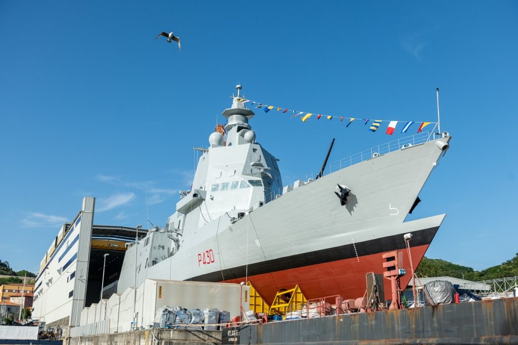

    after that Italian Navy ship with what is basically a "double bow", I'm thinking maybe a quadruple bow "sawtooth" might be about right. Idea would be to get a mix of wave piercing and wave defection but always having defection as the last operation to next too much spray coming over the bow. Double the number of points of bow in pic.

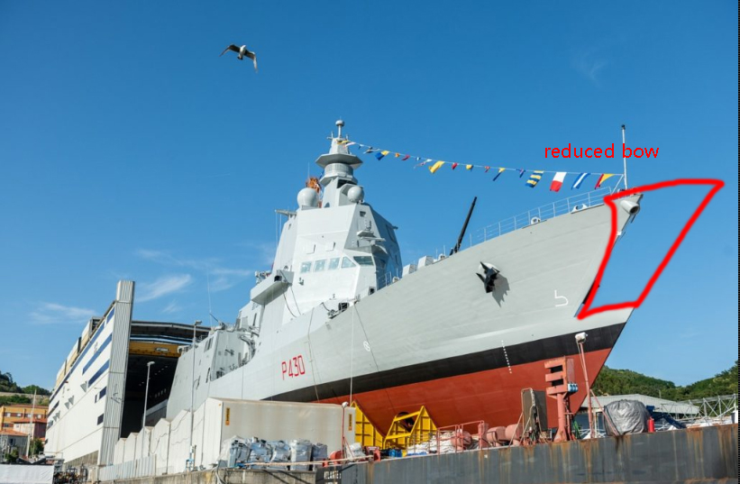

    What I understand that the design objectives of double bow is to reduce the weight and resistance from the bow.
    Maybe a big bow and foredeck are not neccessary in this type of navy ship as they always work in any weather and no worry the spray coming over the bow .

    Location: China
    tz3dcom 3D
    So serious .... has any example to prove it will sink the vessel ? as we know many warships with this type bow a hundred years ago. My understanding is that the increased bow part will provide the more buoyancy, more longer waterline and less the resistance. of course It will make the deck more wet.

    Tz3dcom, while I understand that neophytes come to this site to learn, I abhor people coming who have yet to do due diligence in their studies.
    You are incorrect, the bow type of the pre-dreadnoughts and dreadnoughts was a ram bow, not an X-Bow (TM). If you had done due diligence you would know the difference and you would understand the issues with your forward lower deck windows is similar to the massive damage and down flooding experienced by the forward casemate guns in those ships and why they were converted to Atlantic bow in the inter-war.
    Again, this show a lack of due diligence to Naval Architecture that borders on negligent if this vessel was built. The forward windows can experience loads of between 2,000 and 10,000 psf due to wave slap because the bow provides less buoyancy. Take a look at an X-Bow (TM) and notice the height above WL and the extent of solid structure aft of the cutwater.
    Note that my comments are not to single you out, but you threw yourself up as an example of my previous saying that "there are many things that can be designed that should not be built, and many things that have been built that should not have been designed".
