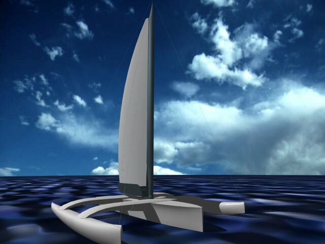

    Dick Newick did a study for a 36 foot sailing unmanned tri for a client but it wasn't built. It featured deck solar panels for power to control the onboard sailing and navigating systems. The design is called "Relationship" and used the main hull from his Echo 2 design.

    The study drawings for Relationship can be acquired from the Mariners Museum in Newport News, Virginia.

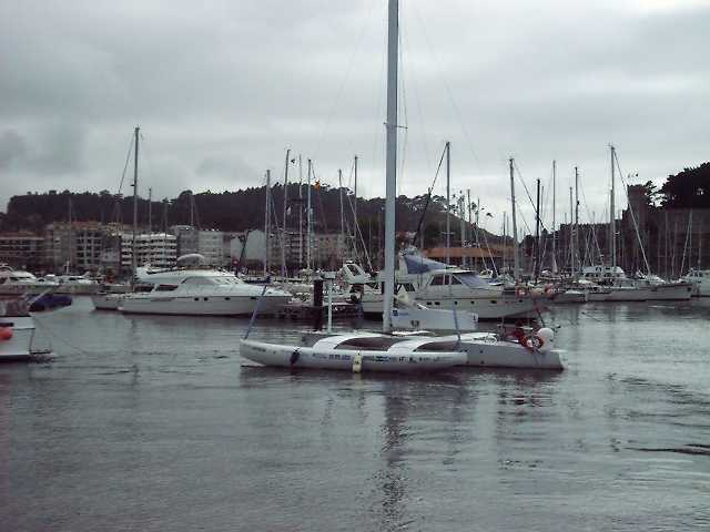

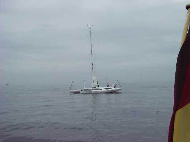

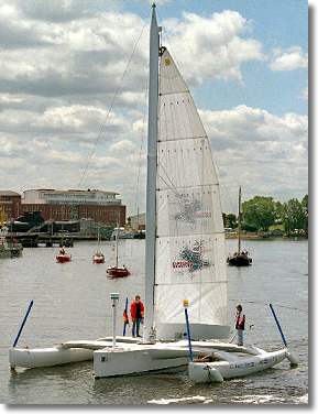

    I didn't notice this thread earlier but as a big fan of Dick Newick's design's I tried to trace the trimaran of the Relationship Project several years back in the hope it would be a hidden treasure lying somewhere unused, unattended.
    There were then a lot links with articles of which only a few still work plus I still have a couple of, not so great, pictures.
    Probably the most chance of getting information should be contacting the University of Furtwangen in Germany cause it was a pretty big project back then with lots of publicity, even uproar (unmanned vessel at sea), also with coverage on Dutch television.
    To my knowledge the project stranded somewhere at the Canary Islands but succeeded to sail to the Canaries. I don't recall exactly if the trip to the Canaries was in fact unmanned.
    After a couple of unsuccessful attempts to cross the ocean the project was finally abandoned.
    Cheers & good luck with your project,
    The links:
    http://relationship.m-fink.de/index.html
    http://relationship.m-fink.de/wsm.szczecin.pl/indexen.html
