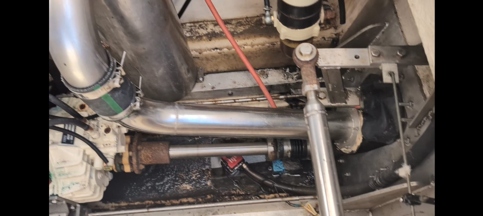

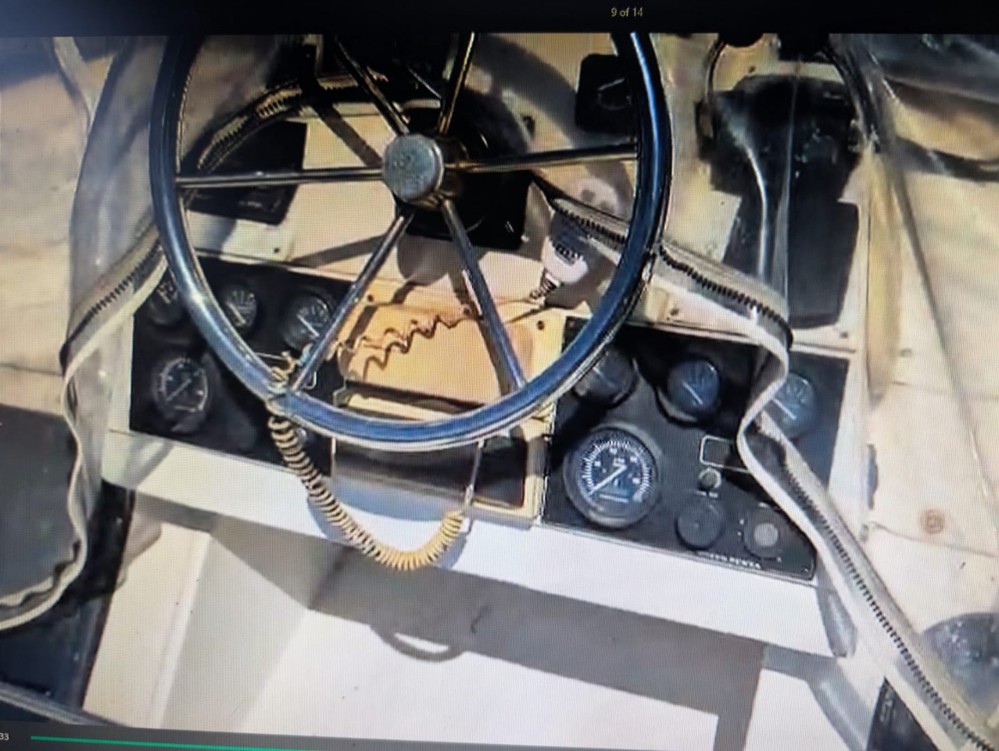

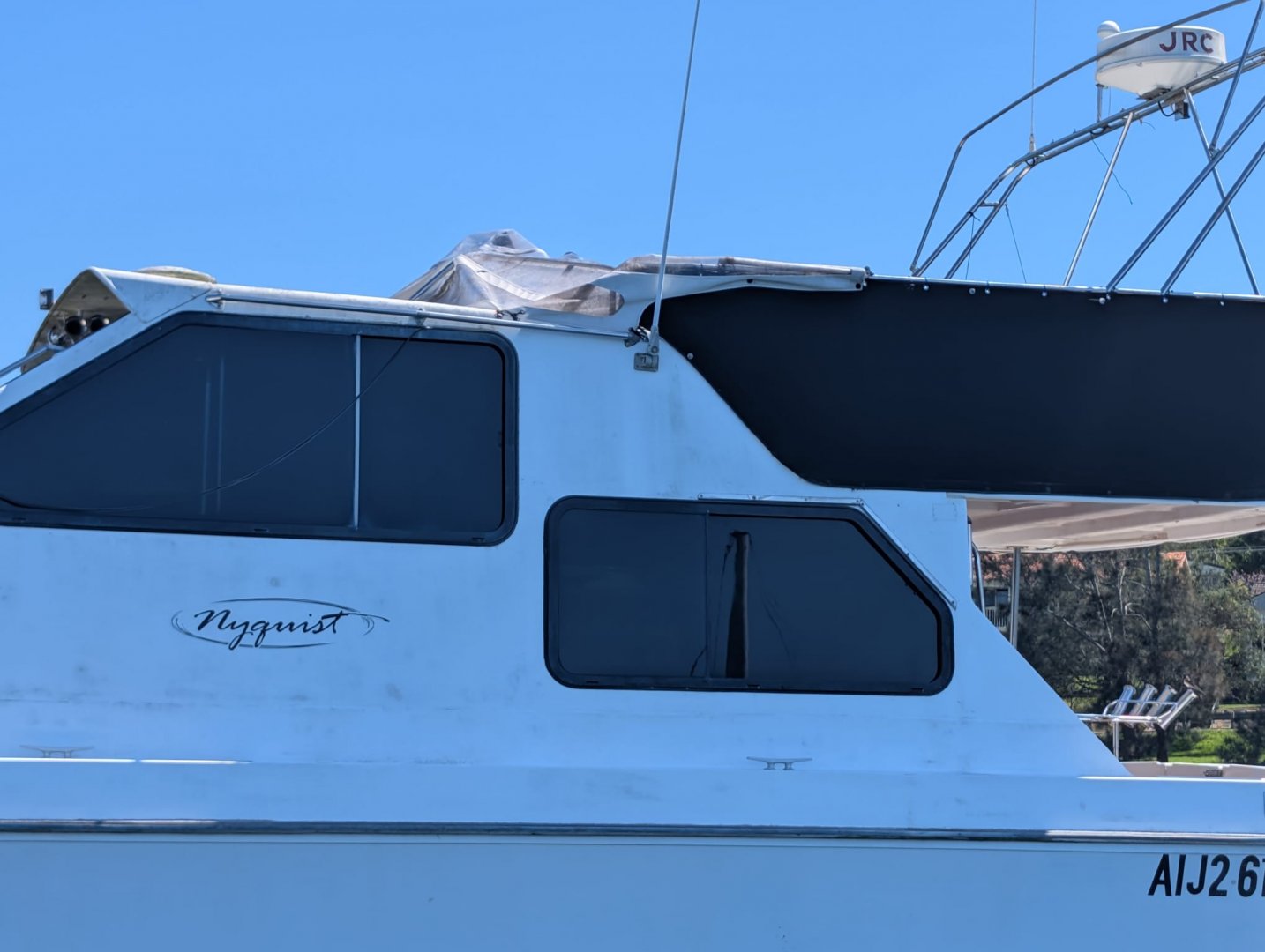

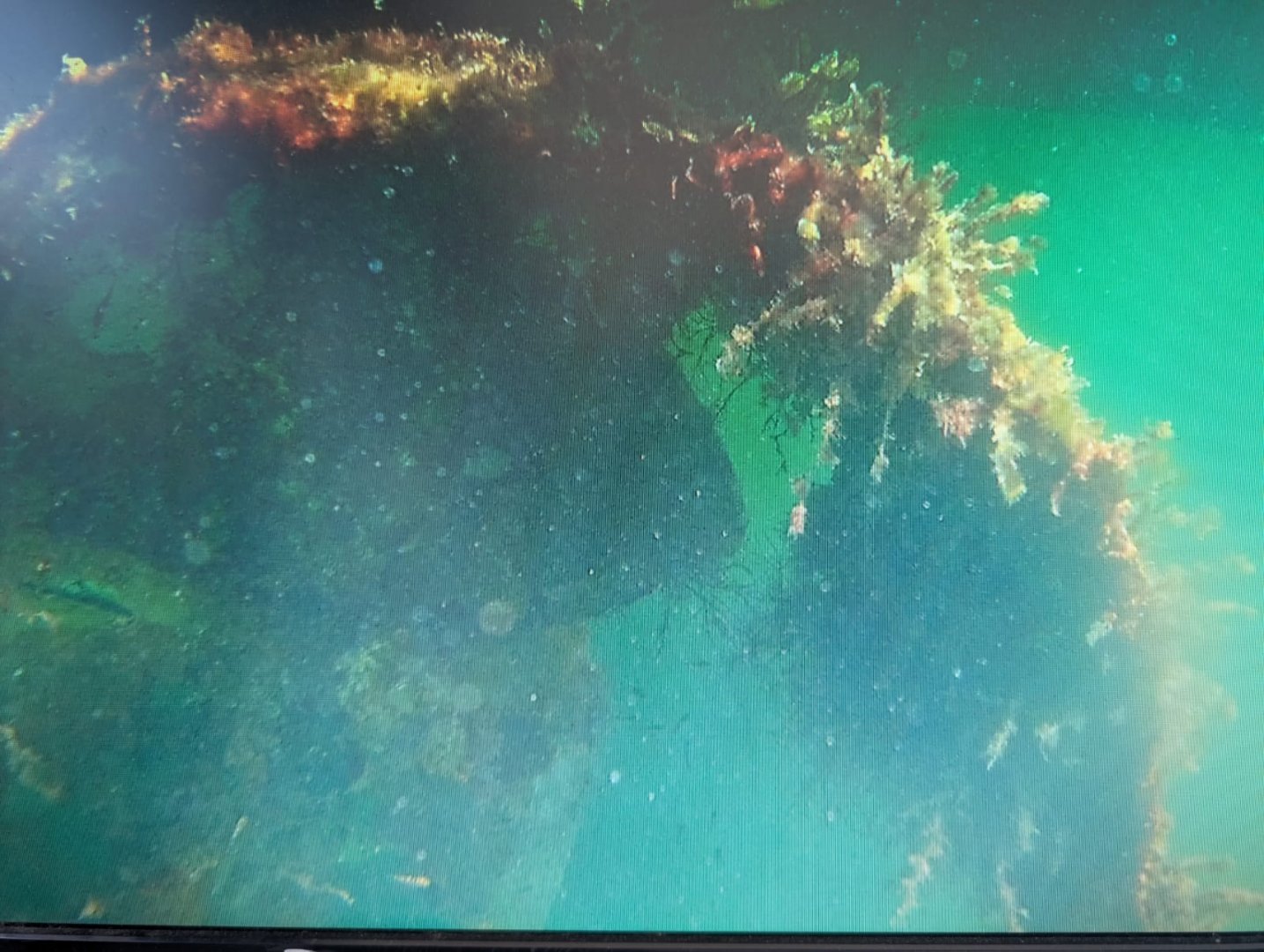

That is a shame to find out the true condition of the boat after going to so much time, effort and expense to go and have a look at it.
It can't be very good for those Arneson drives to be covered in weed like that - I guess the boat has been in the water a long time, and there are probably doubts as to if there are any zinc anodes on the Arnesons.
There are more power cat fish in the sea - Oz does seem to be happily cat crazy - so I hope that you can find something much better soon.
I hate to think how much a pair of replacement Arneson Drives would be for this cat!
How much are they asking for the cat?
Have you had a detailed look at it in person yet?
Maybe you could inquire as to what spares (if any) would come with the Levi Drives?
And maybe even commission a survey - if you are happy doing your own assessment of the hull, a survey of the machinery and drive train could be useful.
