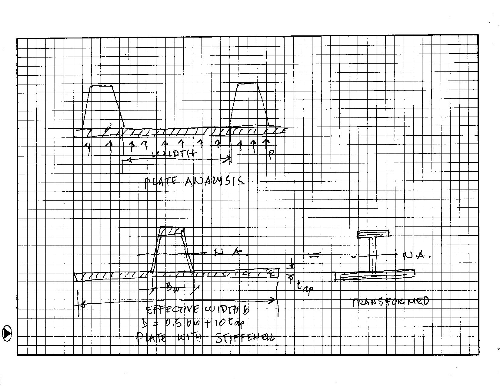

  6. rxcomposite
    Joined: Jan 2005
    Posts: 2,754
    Likes: 608, Points: 113, Legacy Rep: 1110
    Location: Philippines
    rxcomposite Senior Member
    You must consult Lloyd's or Marine Composites.
    When analyzing plate, use only the width of the plate from the base of the stiffener.
    When analyzing a stiffener with attached plate, the effective width is used as shown in the drawing. The section must be transformed (idealized) into a simple H beam with a wide flange at the bottom. The web is the total thickness of both sides. Height is measured from the top of the attached plate/tabbing and the bottom of the top flange or cap. For accuracy, the stiffener tabbing is also included as shown in the LR diagram.
    Plate with stiffener is the most difficult to program in Excel and has been a challenge to me.

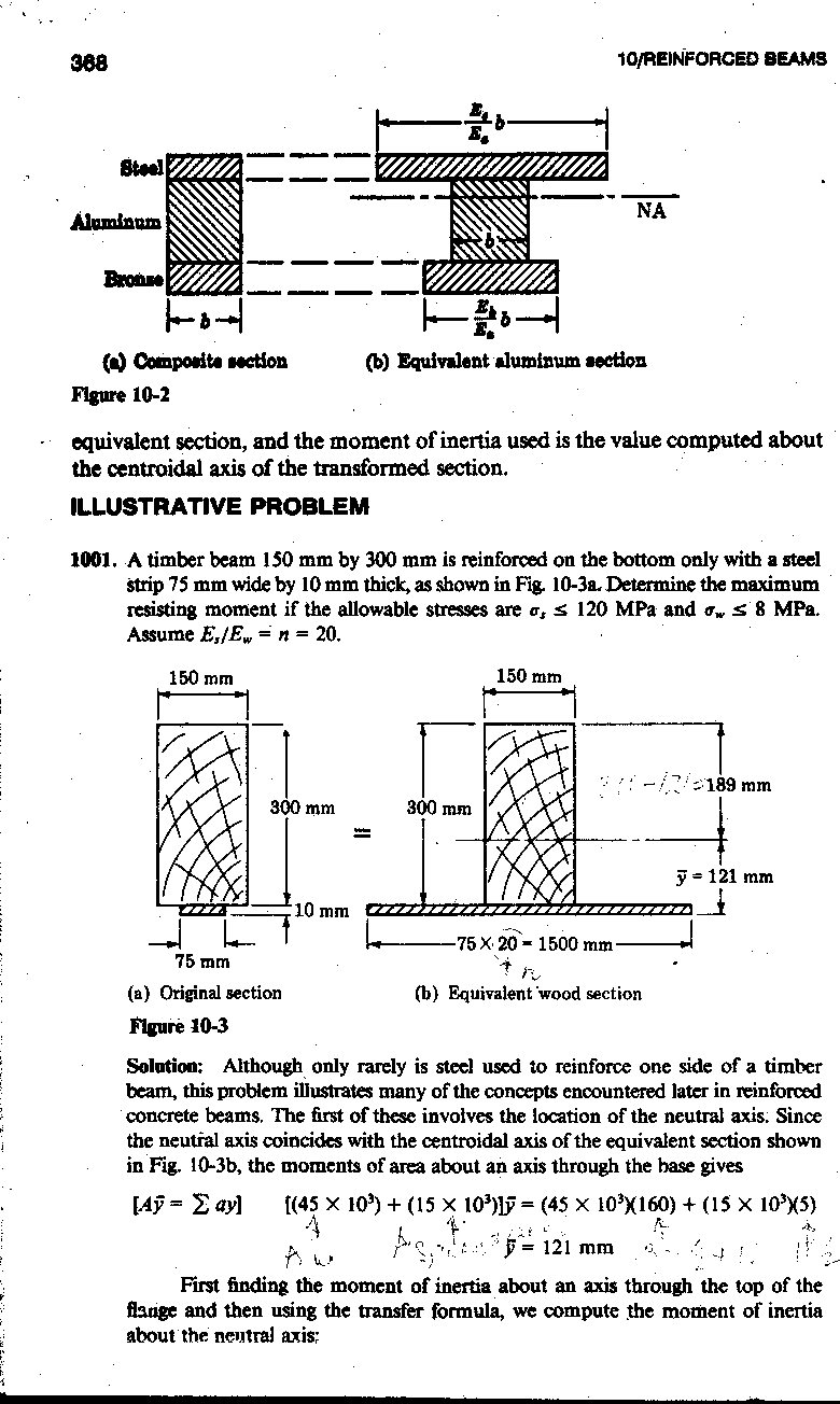

  8. rxcomposite
    Joined: Jan 2005
    Posts: 2,754
    Wood can be analyzed also as a reinforced beam. See illustration as it appears in Strength of Materials by Pytel and Singer.
    Clue. Use the ISO method of tabulation for sandwich construction and substitute wood properties for the core.

  10. rxcomposite
    Joined: Jan 2005
    Posts: 2,754
    I wonder why you missed it TANSL.
    In table H4 of ISO 12215-5 (stiffener with attached plate) the effective width is defined as 20 tp + 70.
    In LR rule, it is 0,5bw + 10tap
    In USCG it is bw + 18t
    Class rules may look deceptively similar but each has their own approach and when not followed to the letter may produce erroneous result.
