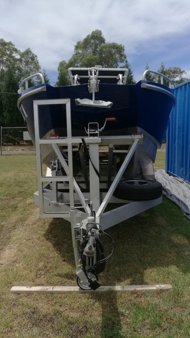

    Hi all,
    I bought an asymmetrical 5.2m powered catamaran from a naval architect design in Aus.
    I had issues were the port side bow of the boat would lean or dig into the water and any speed over 20 knots so i spoke to a few naval guys and recommended i change the motors to have a port side counter rotational motors, after doing so i still have the same issues and nearly a year later and these issues are still bugging and after 5 different boat mechanics and a naval engineer no-one can help me diagnose the issue and i am ready to scrap the boat in the junkyard.
    The original motors were 2x evinrude 75hp etecs and now i have 2x mercury 90hp Command thrust counter rotation long shaft.
    If there is anyone that can assist me diagnose the problem i am more than happy to pay for someones service just to fix the issue... 20170721_092818_2.jpeg 20170721_093028.jpeg 20170721_093103.jpeg

    Welcome to the forum - sail area is rather small but never mind ;)
    Could you post photos of the bows looking aft so we can see how asymmetrical this boat is?
    Also, can you indicate where the DWL is with boat afloat & stopped?

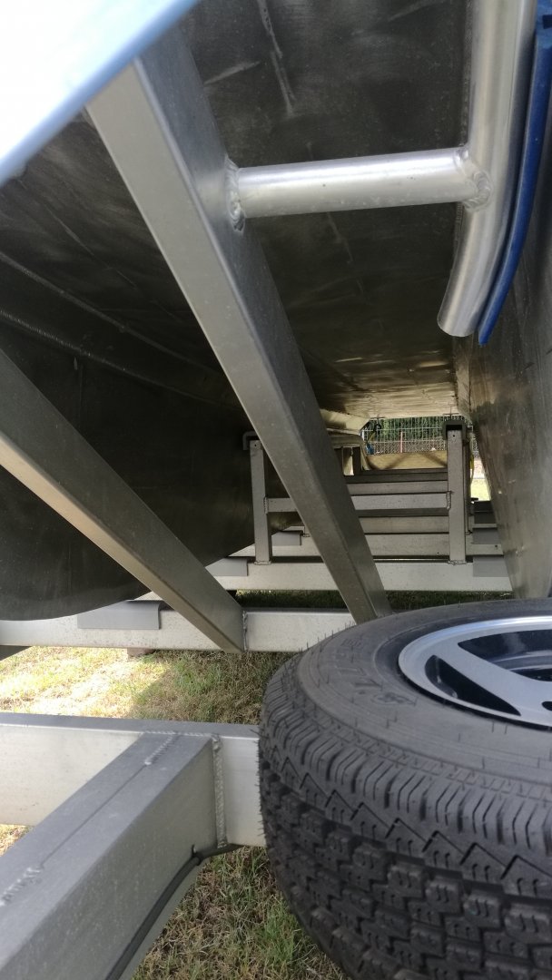

    Hey guys thanks for all the replies, I have been on holidays and only just returned. I have attached some photos of the boat. There are only 2 boats like this designed and built in Australia. The naval architect is Chris Tucker from ctmd.com.au but they don't offer support.

    Marshall_79 Junior Member
    Underneath

    Front view.
