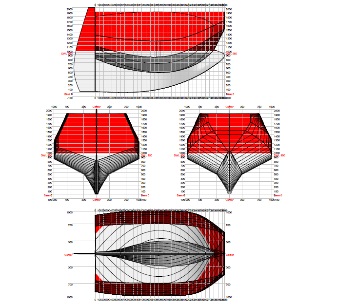

  3. WindRaf
    Joined: Oct 2014
    Posts: 343
    Likes: 5, Points: 0
    Location: Italy
    WindRaf Senior Member
    the weight of only hul steel ten is 0,4 ton with fram ( 16 square m, two different thicknesses)
    more the deck, more the interior, more the rudder, more mast, sail and equipment
    more ballast
    total empty boat 0,85 ton
    displacement with 75% load 1,5 ton (skipper, water, wine, alcohol, food ...)
    full load, in is water line, 1,75 ton
    draft
    0,8 m empty
    0,95 m 75% load
    1 m full load

  5. WindRaf
    Joined: Oct 2014
    Posts: 343
    Likes: 5, Points: 0
    Location: Italy
    Manie, my calculations are correct.
    Here we have a different system of work: before draw and draw, then the boat is built in a month.
    1.75 ton will be his total displacement at full load.
    For the sail is still work in progress.
    I have a guy interested in the project, but still did not find the sponsor.
    Even for this here's a different way to proceed.

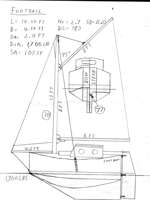

  10. sharpii2
    Joined: May 2004
    Posts: 2,046
    Likes: 206, Points: 63, Legacy Rep: 611
    Location: Michigan, USA
    sharpii2 Senior Member
    Actually the D/L ratio of a boat has little to do with its windward performance.
    It's the shape of the hull, the effectiveness of its lateral area, the amount of windage vs. sail area, and the efficiency of its sails, that rules the day.
    lighter boats can actually have more trouble going to windward than heavy ones under certain conditions. Swedish life boats, designed by Colin Archer, had D/L's well north of 500, but were known to tow stricken boats tow windward, out of trouble. They had huge long keels with outside ballast.
    The advantage of greater length is that it gets you more potential speed, as the speed potential of a displacement hull is a factor of its waterline length.
    A boat with a 12ft waterline, for example, is potentially ten percent faster than one with a 10ft waterline. Over a long distance, this advantage really adds up.
    Here is a proposed design of my own. It has a loaded displacement of 1700 lbs, giving it a D/L of 780. I doubt it would have much trouble sailing to windward.
  11. WindRaf
    Joined: Oct 2014
    Posts: 343
    Likes: 5, Points: 0
    Location: Italy
    Yes, a 10 ft boat for ocean voyages is an extreme challenge.
    First of all it is an extreme design challenge.
    I'm fascinated by this.
    Obviously a boat of 14 ft would be a measure with possibility very different, and the design of a 14 ft would be less extreme and with different performances.
    But 10 feet is a challenge in the challenge. Is it easier to draw a 100 ft, than 10 ft.
    Ten feet oceanic has inevitably big beam, very heavy and destined to sail, for most of the time, with the wind from astern.
    This influences the philosophy of the project.
    Interestingly, the design of the Manie boat, sharpii2 and mine, are very similar in general layout.
    To compare the sail areas of different boats there is a simplified and fast formula: divide the area of waterline for the sail area.
  12. Jamie Kennedy
    Joined: Jun 2015
    Posts: 541
    Jamie Kennedy Senior Member
    Thanks for the thoughtful replies. I am both fascinated and horrified. I thought the Colin Archer Rescue Ships were around 500 or less but the fact that they can tow to windward, in adverse conditions no doubt, is very impressive. What makes the Around In Ten so challenging is not just the 10 foot limit but the payload requirement for food. Even some of my worst baking makes for rather poor ballast. I like the idea of 'making hay' in more moderate winds and sea states. I will have to experiment with this I suppose. I have an old CL12 in rough shape in the backyard I could mess around with, see how it might sail even when loaded to the gills. Both of your designs seem very sound to me. Ultimately I would like to try something similar some day, with a storm rig and working sails for rough conditions and when sleeping, and more sail and perhaps a trapeze or hiking seat for making hay on fair weather days. I don't think the underwater plan would have to change much on fair weather days as I would have more speed to generate lift, but I suppose raising a centerboard or leeboard so I don't trip or roll over it might make sense. I accept the idea of designing for downwind or across wind most of the time rather than designing for windward sailing as you might on a river, while still retaining as much ability as you can to enter harbours and beat off a leeward shore and so forth. I assume the rudder and rigging can exceed 10 feet as long as they do not effectively increase the waterline length or even the pitching. I think I would like to try something like the Vertue 25 of Laurent Giles, only beamier and perhaps deeper. It is 11000 pounds, but lets say 12000 when loaded for a crossing.
    So...
    LOA 25 feet >>> 10 feet takes us down to 4800 pounds
    BEAM 7.2 feet >>> 6 feet takes us to 4000 pounds
    DEPTH 4.5 feet >>> 2.25 feet takes us to 2000 pounds
    I think that might be a good start. I like the aft hung rudder on a full keel.
    I would love to go deeper rather than beamier, but sea biscuits aren't great ballast.
    I also like the cutter rig, but I think it could be a gunter like the mirror dingy.
    I wonder how it might go to weather in a gale with just a storm jib and self steering vane, and the gaff and boom stowed on deck of course.

  13. WindRaf
    Joined: Oct 2014
    Posts: 343
    Likes: 5, Points: 0
    Location: Italy
    Jamie Kennedy, this is my designe
