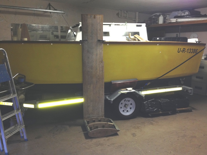

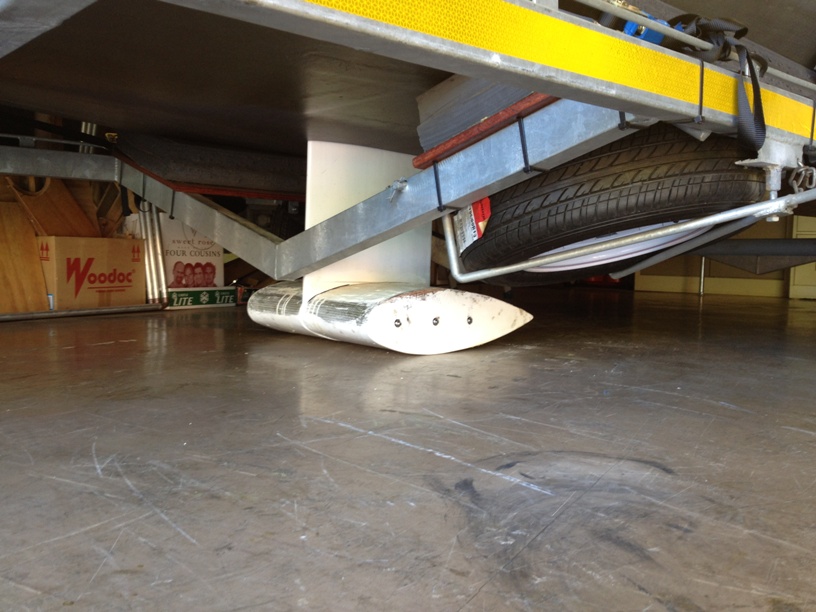

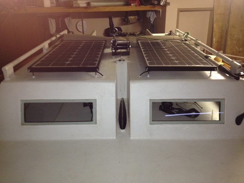

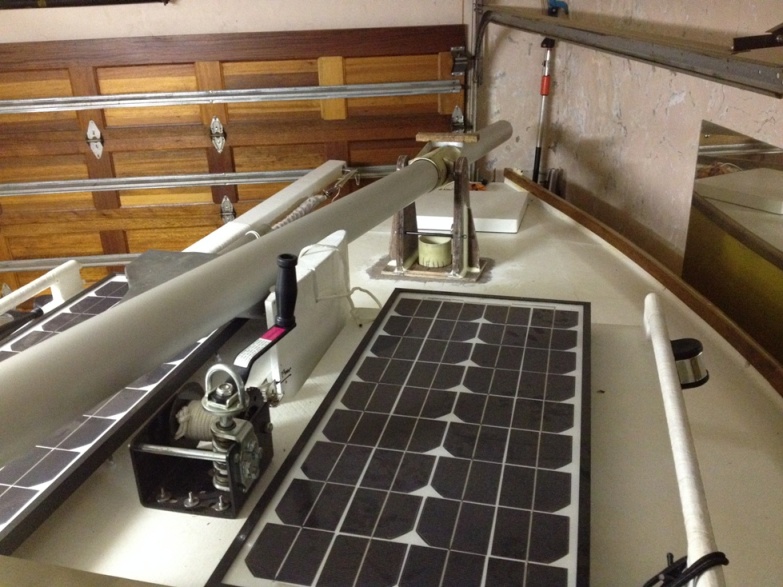

    Just for general information.
    Any form of sliding centre boards or swing keels are a pain in the butt.
    Especially for someone that is a "cruiser" and not a racer.
    Fargo has a sliding keel with a bulb and one day when I have time again I want to change that to something fixed.
    I originally did the sliding keel to be able to "beach" easily and for the shallow draft but found it to be more trouble than it's worth.
    In my opinion if you want shallow draft go for 2x bilge keels. Something fixed never moving or swinging.

  2. Jamie Kennedy
    Joined: Jun 2015
    Posts: 541
    Jamie Kennedy Senior Member
    Nice work Mani. Thanks for the photos. Point taken.

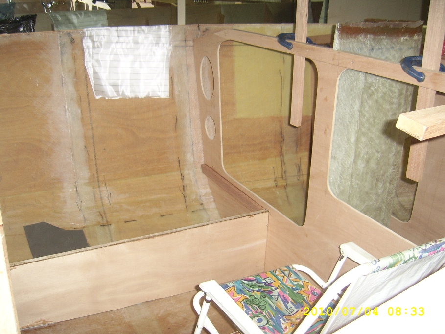

  5. Manie B
    Joined: Sep 2006
    Posts: 2,041
    Likes: 117, Points: 63, Legacy Rep: 1818
    Manie B Senior Member
    oh and I must add because the trunk has to be in a very specific position your interior design is around the trunk so your interior design is actually compromised
