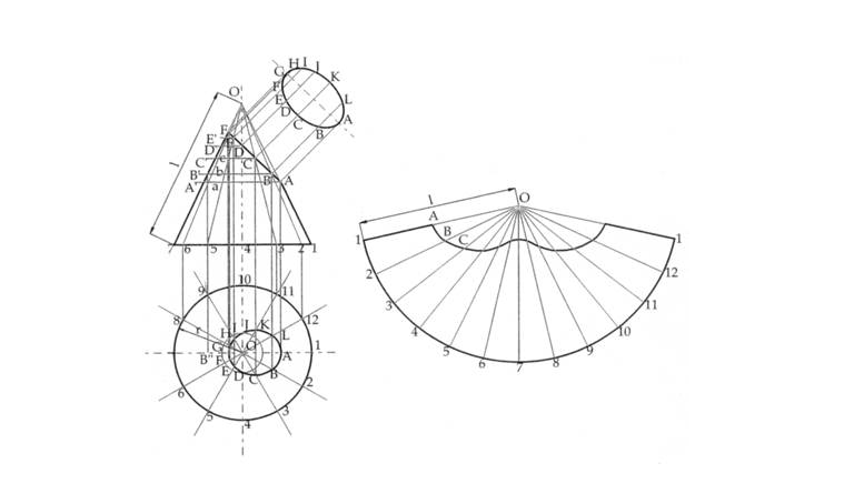

    ah, I forgot, this is a tapered development

    That's about lofting a "slant frustum-ated right cone" in general and not specific about your boat, the picture is widely spread over the web.
    I've looked it up in Italian for you, study it well, you might learn something from it . . :idea: - -- link -- link --
    Just for info for English readers, in the quote a Google Translation of the part about the lofting of this "slant frustum-ated right cone", but beware automatic translations make mistakes especially when it comes to jargon . . .
