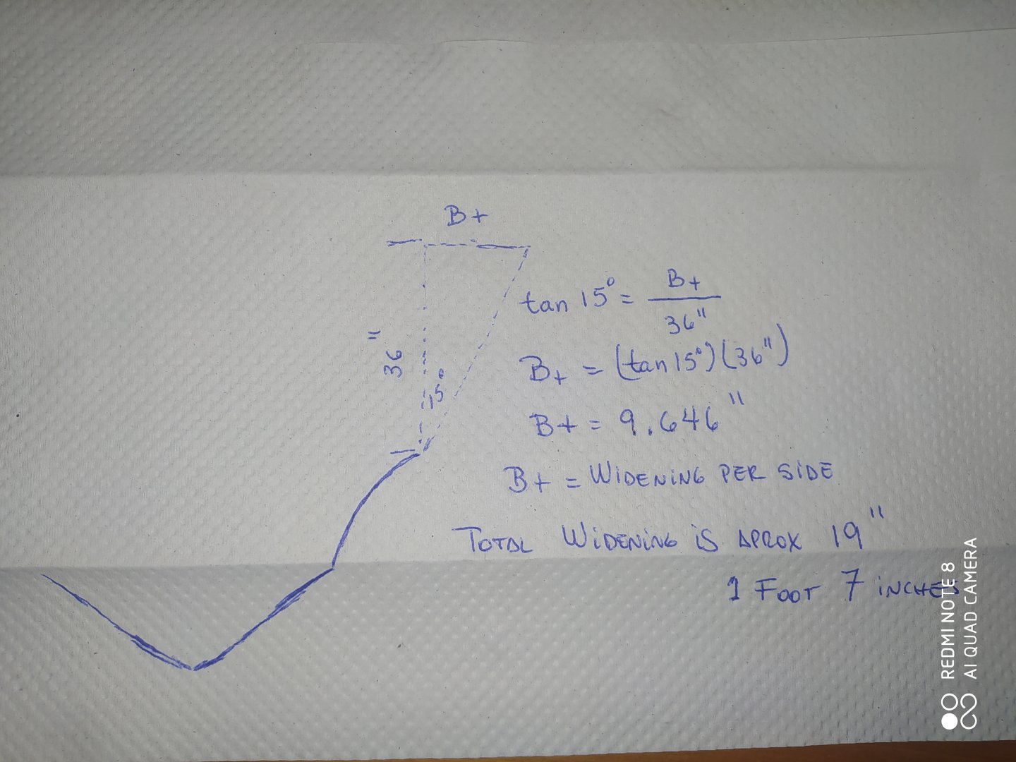

    Hi for everybody in the forum, I'm sure that is a huge job, it is to be complete in no more than 2 years, this hull is 1/4" thick at the sides, I will gonna do thicker (3/4"), extend to 32' (now 24') in lenght and 9.5@10' (now 8') in beam to get something like this

    Lengthening the boat is doable, especially if the chines are parallel, but widening opens up a whole new challenge.
    How will you accomplish this?

    Of course that lengthening and widening is a whole Challenge, but if You use the board edge and go up outside 15° along the hull sides (stbd & Port tack).
    Right now the hull is about 1/4" thick, I gonna add after lengthening and widening a extra quarter inch thick getting 1/2" hull thick after that install stringers and transverse supports and finally 1/4" extra fiberglass layers resulting in a 3/4 thicker hull, of course 3 times the weight. Well this hull is for a Fishing Boat, not a pleasure boat with a 200 HP inboard diesel engine with 18"x 18" propeller with a kicker 175 HP outboard engine.
    See the picture for widening
