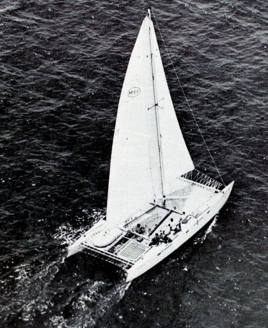

    If I remember correctly Hugo Myers' Sunbird was around 28 feet, 8.5 metres and it predated the Tennant Great Barrier Express from here, so we took great notice of the design - and it was open wing deck, canoe hulls, a smaller version of 44 foot Seabird, which was the real breakthrough pioneer. Now Sea Bird was also designed to take a small cuddy between the hulls but was sailed/raced without this attachment ... and guessing, the same thing could have applied to Sunbird. Seabird had a 3/4 rig, rotating mast and guessing again, Sunbird would have had similar rig ... so what I'm saying, the design is still very modern although it came from the 1960's.
    Kind of interesting that New Zealand multihull designers were thinking very much the same thing as Myers and Skip Dashew from the US, also there was a Hawaiian connection here too; David Barker even named his 40 foot open wing deck 40 foot cat, Sundancer, then later his 57 foot version Sundreamer.
    So new sails and that Myers' design would be right up with the play today. Good stuff always lasts.

    Okay, Sunbird 393 looks very much a 40 foot version of 44 foot Seabird (I had the name wrong thinking it was the 8.5 metre) with open wing deck and fine canoe hulls. Here is the 44, also an earlier fast cruiser version 39 foot named Eunike
