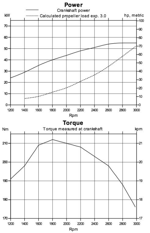

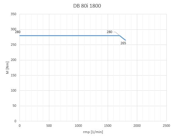

    Maximum Torque from the beginning
    This should be of interest:
    Attached the engine power- and torque curve of a "75 hp" diesel D2-75.
    Compare this with a 50 kW electric shaft drive motor "DB 80i" which offers maximum torque from the beginning. At about 1700 rpm the maximum power is reached which is why torque goes down.
    May be we have some prop experts who can comment on this?

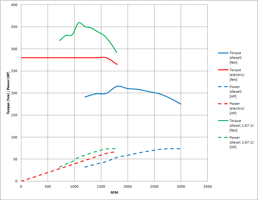

    Graph 1:

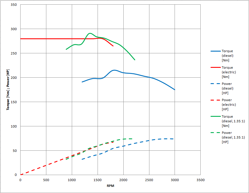

    Graph 2:
    (the diesel torque curve appears bumpy because Excel has connected the discrete data points with a polinomial curve - but it is just a visualization issue).
    You can observe following salient points:
    1. The shape of original torque curves is actually comparable for both engines. The diesel engine has a torque which is apparently highly variable in the original graph, but flattens a lot when placed on this graph. The torque variability (min-max) of this diesel is within 15%.
    2. The electric motor works in a lower RPM range. But it gives a nearly the same maximum power.
    3. When a hypothetical 1.67:1 reduction gear is clutched to the diesel motor output shaft, the max. power occurs at the same RPM for both engines, and the diesel gives a higher torque then the electric motor. That is the effect of the RPM scaling.
    4. When a hypothetical 1.35:1 reduction gear is clutched to the diesel motor output shaft, the two torque curves become pretty much identical. In this case, the diesel gives the max. power at a slightly higher RPM, and the rest of the power curves is exatly identical to the electric one.
    5. Finally, the electric motor is more suitable for boats which need to operate at trolling speeds, since it has a speed modulation which starts from zero. In order to obtain the same capability, the diesel requires a trolling valve to let the prop spin below 700-800 RPM in these graphs.

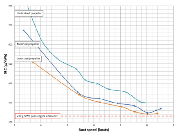

    Then if you compare the fuel consumption for that same diesel, you can see why diesel electric is an interesting proposition. At anything other than full speed, efficiency is reduced dramatically. The amount of fuel needed to make one mechanical KW doubles below about 5kn (in this example). Not really an issue for long distance boats that run at one speed the whole time, but interesting for boats that vary their speed a lot.
