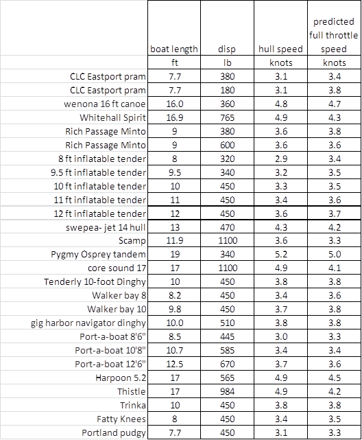

    Hello J, Thanks for your feedback and questions. This is really helpful to me. First, to answer your question, our 47% efficiency is measured as thrust x speed divided by input watts and it has a tolerance of +- 5%. My measurements are in a dynamic test tank where speeds and thrust are measured simultaneously and of course input power is also measured at the same time. I also have a thrust-measurement mount to the side of a boat so that I can measure speed using GPS and thrust. This setup is useful for creating full-power thrust-speed curves. The energy into the charger, inefficiencies in charging a LiFePO4 battery are not included because you're not charging while running and so it seems irrelevant in use. After all do you measure the BTU content of fuel in the HP rating of a gas outboard? But charging efficiency is relevant to folks with a mother ship who charge aboard. For them I can say that the energy out of the battery is about 80% of the energy from your house bank (if you use a 150 watt inverter and our charger). I measured that too.
    I started this thread to clarify the misconception that E outboards are dishonest about their statements of equivalency because I am interested in being up-front and finding the best way to communicate performance in a way that folks can accept. I frankly cringe at people asking me what lb thrust or hp it provides. Because the rpm x torque vs thrust x speed characteristics of electrics are so different from gas. I have been in this game long enough to formulate an understanding of equivalency but now that I've had this opportunity to bounce it off you guys, I learned that the word "equivalent" comes across as misleading. That's an important learning for me and I hope that other manufacturers are listening too.
    What I can still honestly say is that the input power rating for a well- designed electric outboard can be lower because the electric does not need to be over-rated to the same degree as gas outboards, and that the propeller efficiency is much higher , at least at displacement speeds. Now, I am still left with a need to figure out how to say that in an acceptable manner.
    I always felt that the best way to communicate is to tell people how fast and how long the EP Carry will run on your boat and under what conditions. So here is a short list of actual speeds to make the point. I am surprised that other manufacturers have not produced a database like this for their motors too. Note that boats over 600 lb generally do not achieve hull speed with our motor. But for normally loaded boats under 13 ft, it generally exceeds hull speed so that you have reserve for weather and waves... Does this seem a more honest communication approach? J
