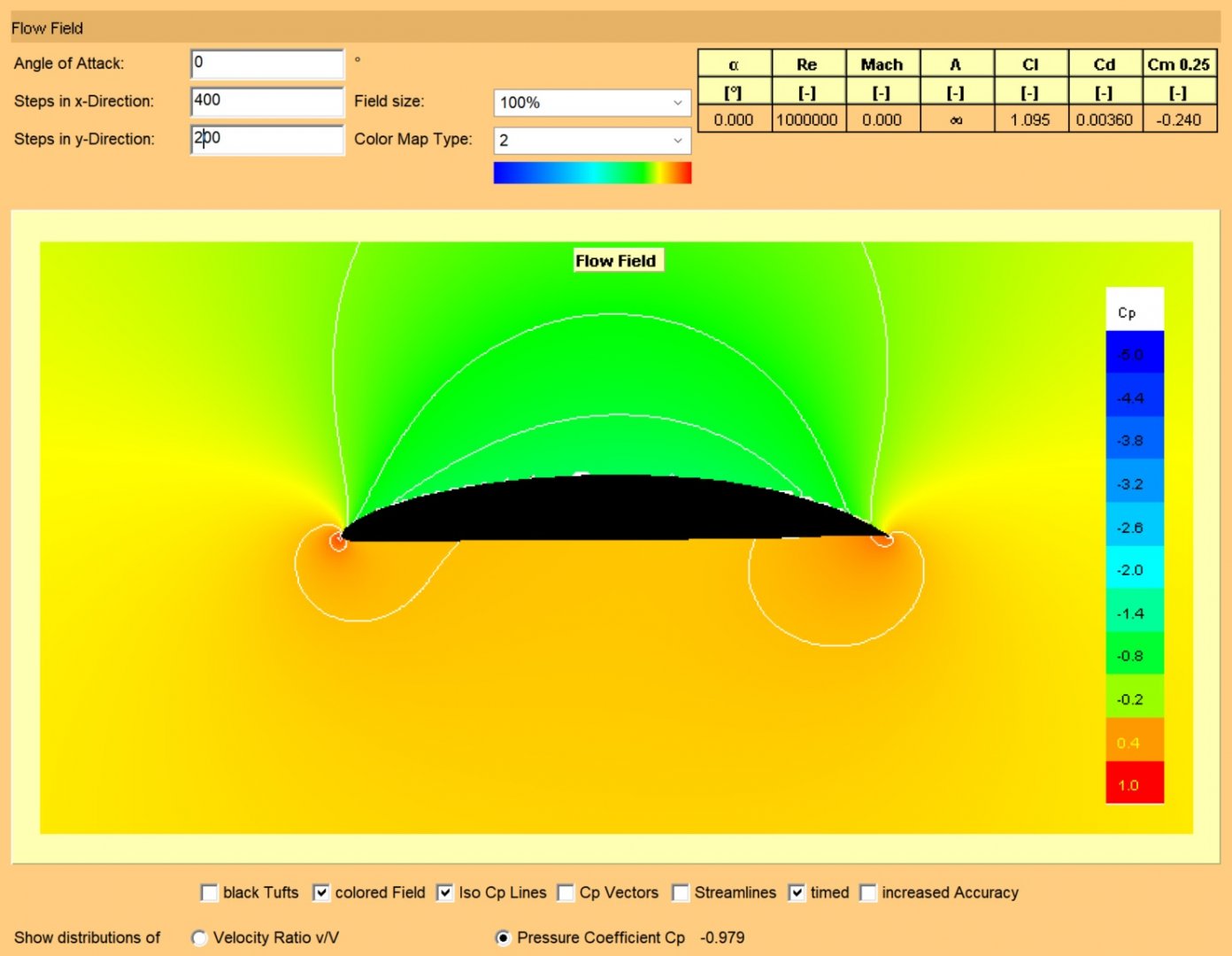

    I should probably just keep reading and learning but I'm impatient and wanted to post this anyways :)
    This is the NACA 16-1012 foil with the ridiculous L/D of 303 at 1 megareynolds and angle of attack = 0. Interestingly when I change just the number of points the foil is generated from the drag increases from 0.0036 to 0.0075. My guess is there is a numerical instability that pushes the algorithm to assume non-laminar flow. But even that has still a L/D of 147 and a good aspect ratio and drag from struts shouldn't reduce efficiency that much. The pressure peaks Cf seem to be between 1 and -1. Does Cf=-1 mean cavitation?
    I'd love to know what is wrong with this.

    It'd think it's the other way round (software assumes unrealistic laminar flow along the whole chord): the extremely even pressure distribution on the suction side seems to indicate that the turbulent transition is missing.
    Yes, results that change drastically with resolution are a clear indication of numerical artifacts - this is why you'd run mesh sensitivity studies in CFD for example.
    Guess you should check these figures with an other code or method, not only to confirm the high L/D (147 would already be among the top), but also to make sure that it is not a section that relies on extreme concentrations of suction that would drive you into cavitation way too soon. Who'd want to see his nice wing eaten up by bubbles within minutes ? :)
    btw NACA 16-1012 sounds weird: the 6-digit series usually have numbers starting with 6. It's not a 16-012 either (NACA 16-012 (naca16012-il) http://airfoiltools.com/airfoil/details?airfoil=naca16012-il is symmetric). ... ??

    The NACA 1-series was their first attempt at designing airfoil sections using an inverse method. The "6" in the second digit indicates the pressure distribution rooftop goes back to 60% chord. In retrospect, they were trying for too much laminar flow and the convex pressure recovery lead to early separation at the trailing edge. The 6-series sections, with their more modest rooftops and linear pressure recovery distributions were more successful. The NACA 1-series has found application, however, in propellers (where maximum Mach number is an issue) and hydrofoils (where cavitation is an issue).

    It's more or less a "random" example I stumbled on while playing around in javaFoil that had way too good to be true L/D ratio.
    The "1" in NACA 16-1012 vs NACA 16-012 stands for the "Design Lift Coefficient=1" in javafoil. So the lift is around 1 even with angle of 0. Definitely an odd bird and probably a numerical fluke.

    I still don't get it Dejay: Naca 16-012 looks like below in airfoiltools.com and on the UIUC database, that's not the foil in your pressure pic.
    If you post point coordinates or the right airfoiltools link for your 'weird' one i'd be curious to throw it into Hanley's Multisurface Aerodynamics or CFD :)

    Here are the points for the NACA 16-1012

    I guess it's similar to the "NACA 66-1012". The "design lift coefficient=1" basically pulls up the middle of these two foil and makes the bottom flat.
    There is a little bit in the JavaFoil User manual on page 9
    But please, don't invest much time in this on my account, since it's really just a random airfoil I played around with. I have yet a ton of reading and learning to do and other tasks before I can seriously approach an addon hydrofoil that might work for a low-powered cruiser powered by solar panels :)

    No big deal actually, i was just curious because even your 147 L/D figure was fairly high, and Tom said these 1-series aka 16-series can do well in terms of cavitation avoidance.
    Here's the 3Dfoil output for a quasi-infinite span at 18kn in saltwater. (Span : 100m mirrored, meaning the LD is that of a 200m wing, and lift ist for one half of this wing. Chord = 1m):
    Coefficients @ AOA = 0.00 Deg.
    Lift Coefficient: 0.821
    Side Force Coefficient: 1.01E-16
    Vortex/Total Drag Coefficients: 0.00111/0.00565
    Lift-to-Drag Ratio: 145.36 -- That's pretty close to your 'resonable' figure isn't it ?

    if you go down to a reasonable span (5m mirrored for 1m chord as an example), things don't look quite as sexy, but not bad either:
