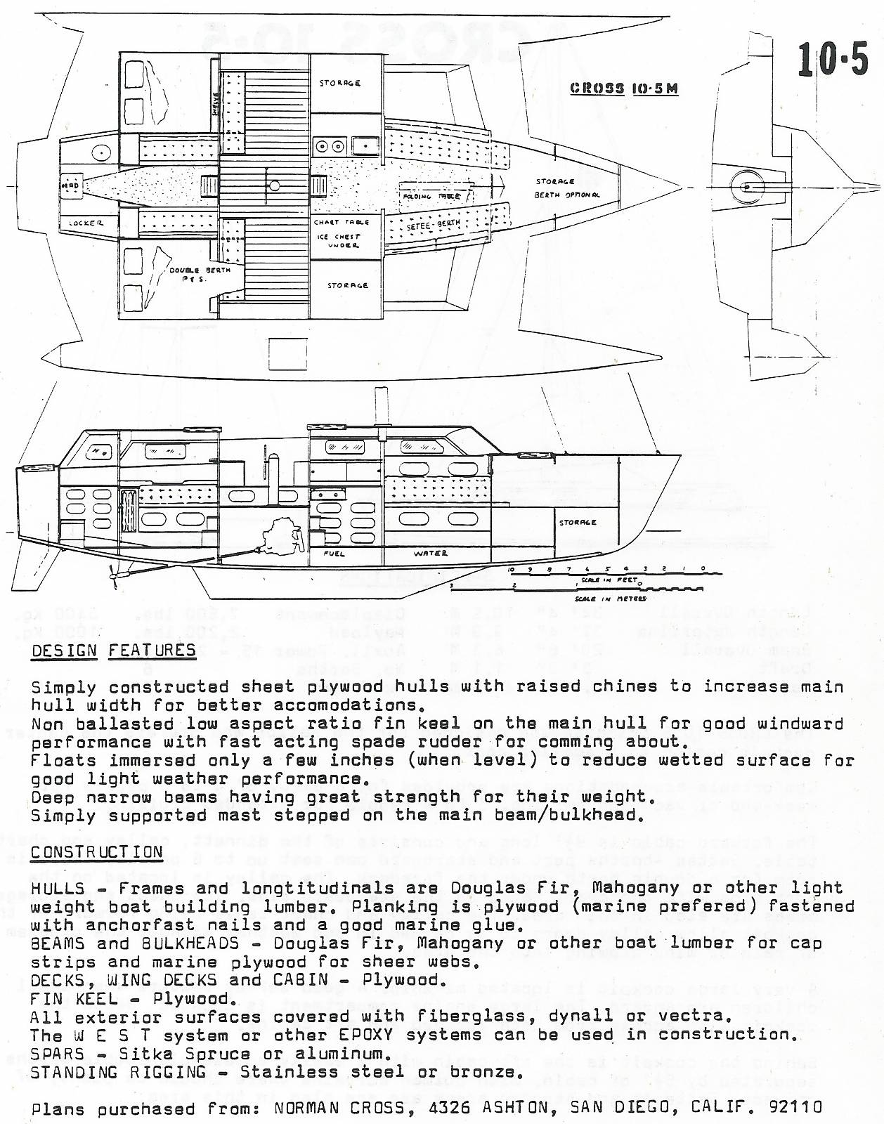

  14. cavalier mk2
    Joined: Mar 2010
    Posts: 2,123
    cavalier mk2 Senior Member
    Here is Norm Cross' version of a economic 34' centercockpit cutter rig cruising tri. The single chine construction is more straight forward then the Searunner and the keel skips the elaborate centerboard trunk and bracing. Norm had the same conclusion about berth direction and the head is astern so this ticks my boxes for this style of cruiser. The lower V angle will carry a load better than a CC and the chine above the waterline reduces turbulence while putting the elbow room where you need it.
  15. cavalier mk2
    Joined: Mar 2010
    Posts: 2,123
    On another note the 31 and 34 Searunner could be adapted to the same sort of interior as the Cross. On the 31 I'd put the table in the first sitting room section with the galley in the old dressing room. Astern going aft the first section would now have the start of the bunks with the feet still extending under the cockpit. The head would go in the after cabin section saving that trip to the pointy end. The space is pretty similar flopped around.
    The 34 takes more head scratching, I'd do it in a similar way with a shorter cockpit forward to give a bigger table area. The galley in the old dressing area keeps the cook out of the traffic pattern.
    Both boats could have some sort of nav area using wing space in the forward cabin table area with a bit of thought.
    You wind up loosing the converted dinette bunk in both boats but some sort of bow bunk is possible with the head moved astern. For something wide perhaps it could extend into the new galley area at night.
