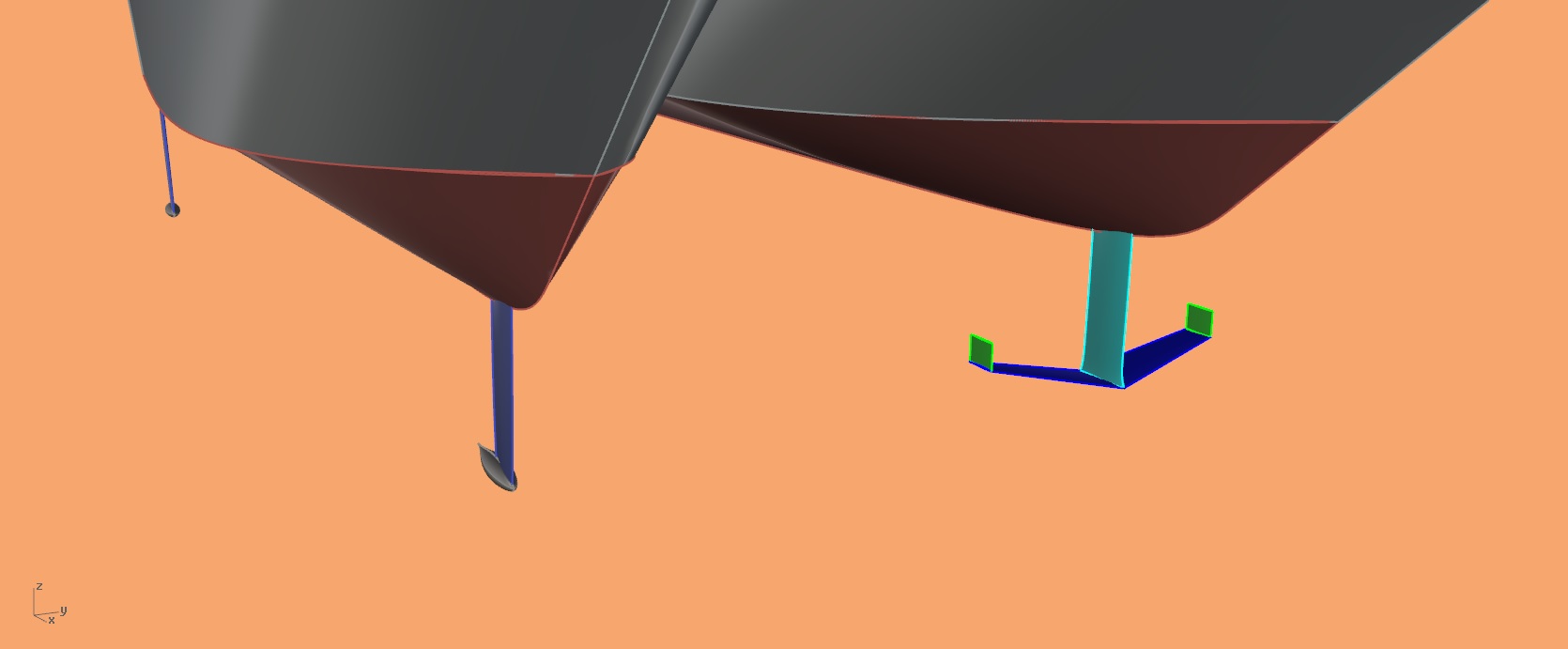

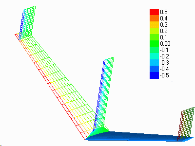

    I am currently looking into designing hydrofoil boats in the rhino software. Mainly a fully submerged and a surface piercing (V shaped) one. I've done the draft design for the fully submerged hydrofoil as attached below. Now i have no idea on how to create the V shaped one. This is for my fyp project and any form of help will be greatly appreciated! An example of a V shaped foil for my design is attached below too

    I do not understand what your intentions are because the 3dm model has foils totally different from those of the .gif file. Do you want to create a new "V" shapes hull for your foils or do you want to place your foils in the fyp3.3dm hull?.
    I do not know whether to think that what you want is, once the foils are created, to add a hull that need still be defined. This would be, precisely, the opposite procedure, and therefore very wrong, which must be done. What some do is define the boat, so that it complies with several requirements and then design the most suitable foils for the boat.

    Your fully submerged "foil" has an elliptical cross section. It appears that you created the "foil" as an ellipsoid. An ellipse is a terrible shape for a hydrofoil section and will not function properly. Your first step should be to learn about the basics of hydrofoil sections.
    Once you know what a hydrofoil section should look like and have selected a good section you can proceed to create the foils in Rhino. First step will be create the desired section as a planar curve. Position a copy of the section with the desired chord at the root of the foil, and another at the tip. Then use Loft to create a surface between the sections.

    You can also use sweeps, might be easier to control but first get the exact shape right

    What i did was that i went into the maxsurf software and took the default workboat as my hull and the foil from the default yacht and combined them both together. My intention is to use the same hull and implement a surface piercing and fully submerged hydrofoil designs separately. Next, I'll be doing a resistance analysis on both of the designs in maxsurf. To answer your question, yes i just want to place the foils in the fyp3.3dm hull. Sorry I am not experienced in Rhino as I did not attend any course on the software before.

    The foil was initially a bulb like shape from the default yacht(as attached below - yacht.3dm) in the maxsurf software. I also took a default workboat as my hull and combined it with the foil(fyp2.3dm). I then tried to make it look like a wing, but it seemed to become an elliptical shape. Sorry but i do not have any prior experience in Rhino as I am still learning on the software. I am still trying to figure a way to go about creating the foil configurations.
    My plan is to get an existing foil and implement in on a monohull, whereby i will have 2 separate configurations - fully submerged and surface piercing hydrofoils. I will then import these 2 models into maxsurf resistance and do an analysis on them.

    Attached below is my initial fully submerged hydrofoil configuration. As you can see, the foil looks like a bulb which i took from the default yacht (yacht.3dm) file.

  14. bhnautika
    Joined: Feb 2006
    Posts: 849
    Likes: 55, Points: 38, Legacy Rep: 571
    Location: australia
    bhnautika Senior Member
      File size:
      56.8 KB
      166
  15. Jakenewcastleuniversity
    Joined: Mar 2018
    Posts: 9
    Likes: 0, Points: 1
    Location: Singapore
    Jakenewcastleuniversity Junior Member
    YES! This is exactly what i want. Do you have it in a 3dm file? If so, the only thing left for me is to just scale up the foils
