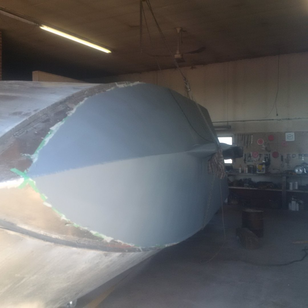

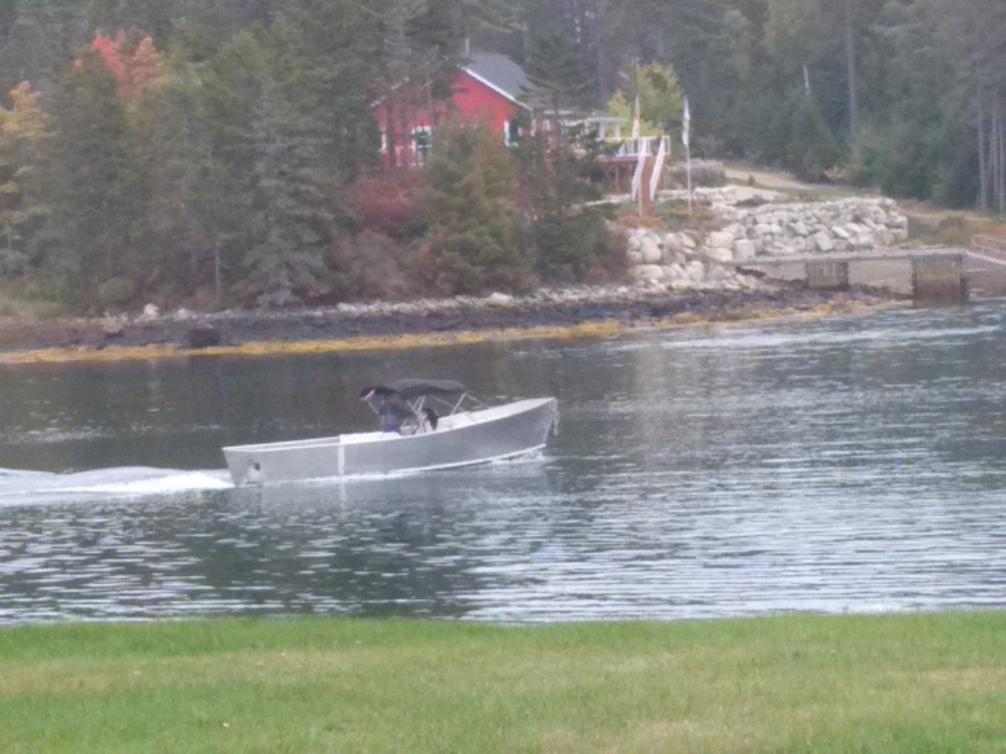

    IMG_20160417_101202.jpg IMG_20160626_154059.jpg IMG_20161009_101142.jpg IMG_20160417_101023.jpg IMG_20160417_101202.jpg IMG_20160626_154059.jpg IMG_20161009_101142.jpg IMG_20160417_101023.jpg IMG_20160417_101023.jpg View attachment 146667 IMG_20160417_101202.jpg IMG_20160626_154059.jpg IMG_20161009_101142.jpg Thanks for the replies!
    I guess i could use it for bouyancy (had not thought of that). Other than that, no - i don't see any other benefit myself, if there wouldn't be some performance gain. Re: bouyancy though, I struggled alot in the last couple of years with the decision to add foam (or a combination of foam and plastic bottles, etc) and finally decided not to add either.
    I think the chance of hull breach / holing is very low, and we are not typically too far from shore, and normally tow a zodiak. The way the hull frames and stringers are planned out and built also does not allow me to easily weld airtight cavities, due to weep holes, frames not weld directly to the hull, etc.
    Here are a few more pics from construction and in the water.

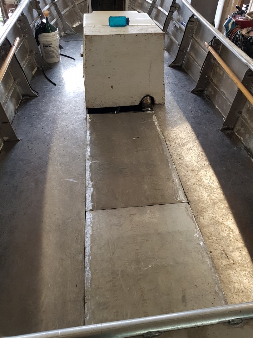

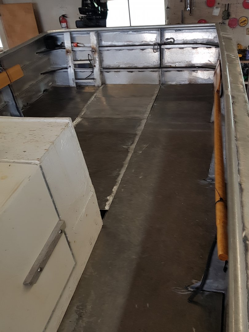

    Northeaster Senior Member
    A couple pics of the new aluminum floors. I cut out a roll of vinyl garage flooring with checketplate pattern to put down on the bare aluminum, as it is slippery.. note. I would have used checkerplate but that meant buying new sheets where this was leftover from the hull build..
