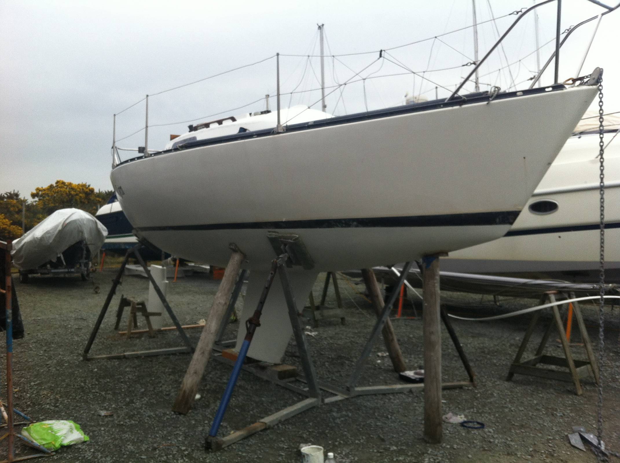

    Take a look at my small boat in the attached pic. The literature claims that this boat weighs 1200 lbs. A sister-ship was weighed on a highway scale and her weight was calculated to be 1710 lbs without outboard and gas tank, cruising gear, anchors, etc. The keel ballast is 300 lbs of lead.
    Now add an outboard motor on the transom, a gas tank and battery in the lazarette, and 2 adults in the cockpit. The boat's centre of gravity is nowhere near the keel. It's probably somewhere in the cockpit.
    The Bible tells us to pack additional gear close to the keel to minimize the gyradius and to prevent excessive hobby-horsing. For this little boat, are we better to store gear in the quarter berths? Under the cockpit? In the lazarette? Or as far forward as possible to correct the trim of the boat?
    It's hard to keep the transom from dragging in the stern wave.
    What are your thoughts?

    Just looking at the picture I'd guess that storing gear under the window and keeping the crew as far forward in the cockpit as possible might go a long ways toward fixing the trim. I'd try not to separate(fore and aft) the gear and the crew any more than absolutely necessary.

    Many of these small boats squat when loaded with an outboard, tank and batteries aft. You could load as much gear and supplies close to the bow and sit forward in the cockpit.

    If the boat is squatting, the load should be as far forward as possible. To minimize pitching, the load should be as spread out fore and aft as possible. If you concentrate the load in the center, the ends will be light and tend to move up and down more.

    Its always a compromise with boats, but I'd sort out the trim first and put the weight distribution strictly second. If you're heavy in the ends you won't go upwind through waves as quickly and you'll hit the waves a bit harder, but to mind better that than dragging a fat stern through the water all day.

    Locating mass close to the center INCREASES a boats ability to raise it's bow over waves. It is something you should do if you don't like how your boat is plowing through waves. You appear to have the opposite problem and that area frequently has a sharp chop. I sailed many times from cedar point to put in bay. It gets terrible on weekends. By all means, move some mass forward. It will change the trim bow down and increase the rotational inertia. Note -it is not certain that it will reduce pitching, only that it will reduce the natural frequency of your boat. If the wave frequency is closer to this reduced natural frequency (depends on waves, heading, and boat speed) it can increase amplitude. You can test it by sending one crew to the v berth while maintaining a heading, better or worse? If it's better pack some weight under the v berth.

    What should appear the most logical solution is that all added weight in a small boat should be located, longitudinally, as close to directly over the keel as possible. Any weight added to the ends will upset trim and promote hobbyhorsing. That's just a fact of physics.
    Further, all weight added to a boat should be as low as possible. I added two relatively large flexible water tanks and two Group-24 batteries to my Hunter 25, one of each under each main-cabin settee berth. Depending on how I load the water tanks, this amounts to 300-odd pounds right in the very best possible place-- and, though substantial, this goes far to stabilize the boat in the water and minimize the effect of (much less) weight in the ends. (In effect the tanks are water ballast-- but let's not get into the myth that having only water ballast is in any way better than having positive stability in a proper weighted keel.)

    All small boats hobby horse in chop. Hobby horsing is a function of the resonant oscillation frequency of the hull being close to that of the waves you are driving through. A finer bow entry is likely to exacerbate this a bit but that's not the cause. the cause is that the boat is light and has weight in the hull and not the board.
    That said, I would not go rejiggering the centerboard unless you really know what you are doing. because the CB trunk is designed for the loads that CB is going to put on it. lets say the CB is 3' long so by adding 100# of lead to its bottom, you would be able to get rid of the 300# in the bilge. BUT you would also have more than tripled the lateral loads on the board and the CB trunk. so unless you are going to re-engineer and rebuild the whole CB trunk stay away from that change.
    what I would do is
    a) move the battery forward into the cabin. and re--run your running lights to it there. If you are using the battery to start the motor - stop and get a different motor
    b) get the smallest motor possible. The Tohatsu 2.5hp should drive this thing at pretty much hull speed anyway. and that weighs less than 40#. Then I would store the remote tank forward in the cabin.
    c) when sailing, unmounts the outboard and put it down below (easy with the Tohatsu)
    d) put nothing. Not one thing. Not even a water bottle, in the lazarette.
    But basically, its a small boat, with a somewhat pinched waist. and no weight in the keel, She's going to hobbyhorse not much you can do about it. there's a reason more modern daysailer designs like the Viper use a vertical cb with a torpedo of weight at the bottom.
    1) its lighter
    2) its more RM for the same weight
    3) it increases fore/aft angular momentum dramatically and thus reduces pitching.
