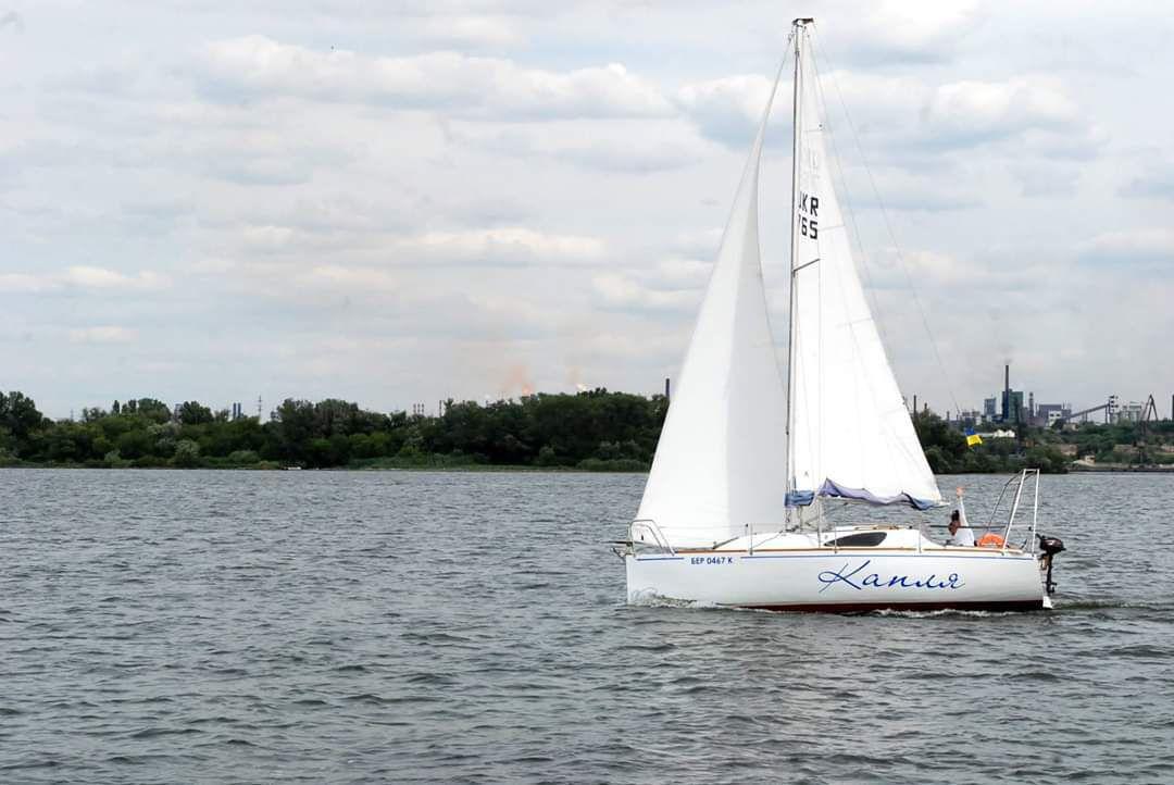

    Run at 1.8 kW video:

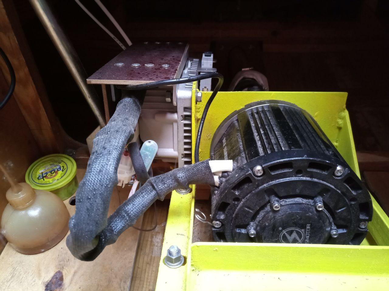

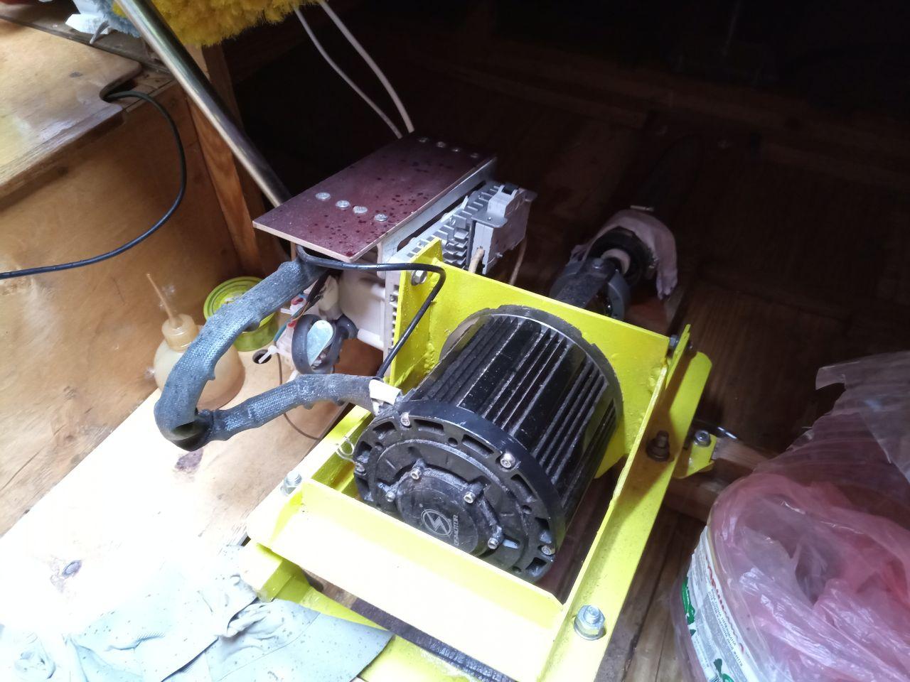

    Boat and drive specs:
    3 kW electric motor QS 138
    Kelly controller KLS 6022H
    36V 180Ah Lithium battery, battery topic by this link
    Boat weight 1800 kg
    Boat LWL is 6.5 m
    Electric drive weight including battery: 55 kg
    Discharging:
    Clear weather tests:
    1.8 kW - 5 knots
    1 kW - 4 knots
    500 W - 2.7 knots
    200 W - 1.6 knots
    Upwind 15 knots, 30 knots gusts:
    1.8 kW - 3.5-4 knots
    1 kW run - 6+ hours at battery.
    Charging:
    Shore power - 1 kW charger, 6 hours from "empty" battery state
    Solar charge - 250W, 5 summer days from "empty" battery state. Charge from PV using MPPT controller.
    Cost of all electric things: wires, connectors, fuses, electric motor, mppt controller, motor controller, electric drive, solar panel and lithium battery ~ 3500 USD

    Thanks! Yep, it may work as full solar boat, but boat owner don't want to remove sails.
    This is first boat I converted to electric drive except my boat.

    Dejay, thanks! Motor controller support regeneration, but for such small boat regeneration can give very small amount of energy, like 50W at 5 knots and will produce a significant drag. So I suggested boat owner to use a folding prop and he used it. For sailboat displacement 3000+ kg regeneration has the meaning.
    Boat owner don't like to remove mast because he like sailing. At this boat electric motor is auxiliary engine, main is sails.

    You forgot the most important detail is the propeller. Inboards are terrible efficiency because the propeller is too small. Almost all sailboats today have very low efficiency of propeller alone is less than 30% and the stuffing box wastes a lot too.
    I have a larger boat (33ft trimaran) and I can motor 2 knots using 120 watts. I have a large carbon fiber propeller and built my own mppt:
