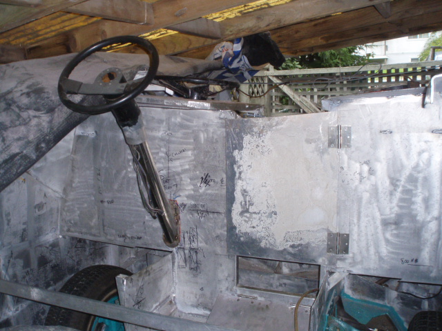

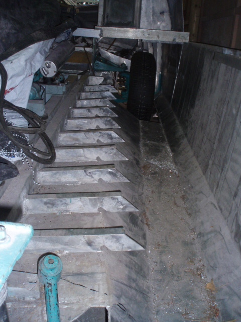

    latest photos of my project.I may have to add trim tab/tanks at transom to get stern draft down and compensate for mid engine weight

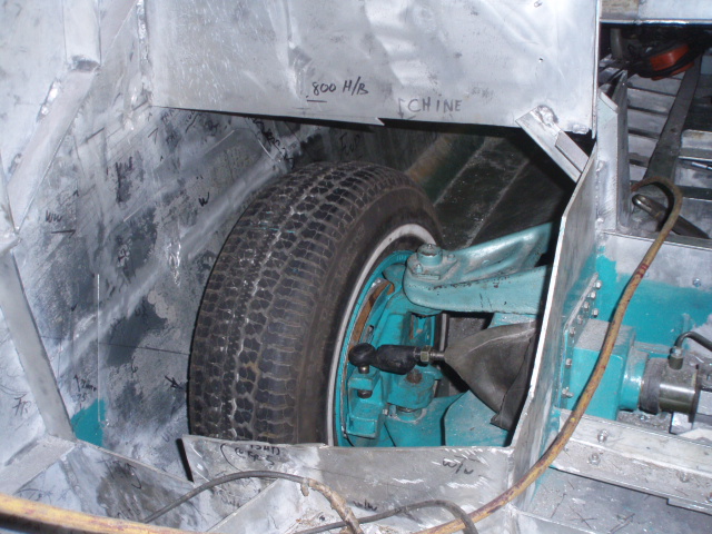

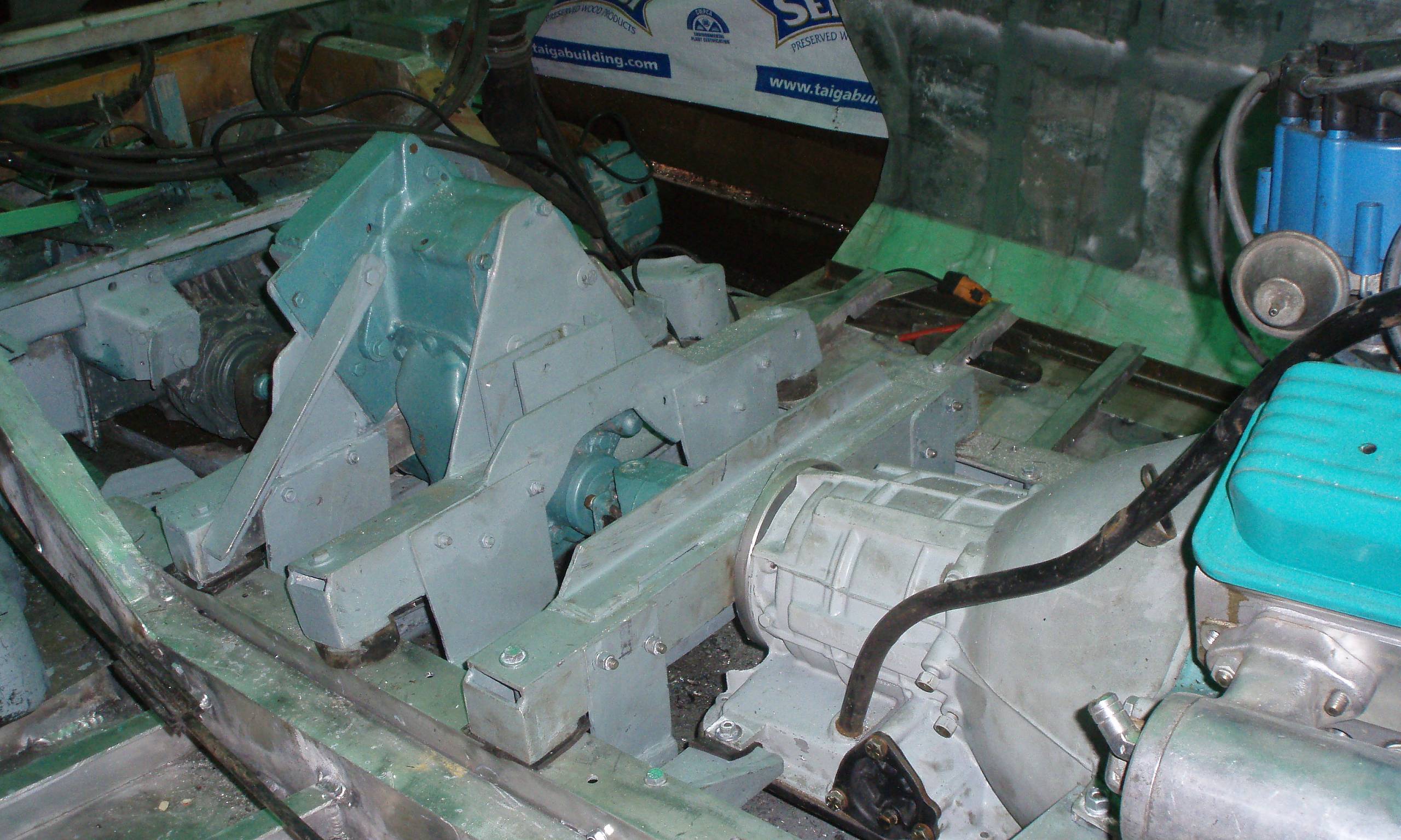

    : some photos for you . it is a 350 V8, powering a shirty power glide, driving a dana 18 transfer case, that shifts between rear axle and jet drive

    photos of amphibian drive train for SQUIDLY?
    photos of drive train. 350 chev, shorty power glide, dana 18 transfer case, jet drive

    but what about the drive to the (I'm assuming only rear) wheels?

    The rear drive axle is in the photos squidly. If it was me i would put an outboard on the back and just use the v8 for the road. It is a great project. Looking forward to seeing it finished.

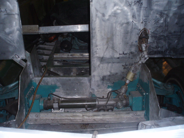

    Leaks/seals

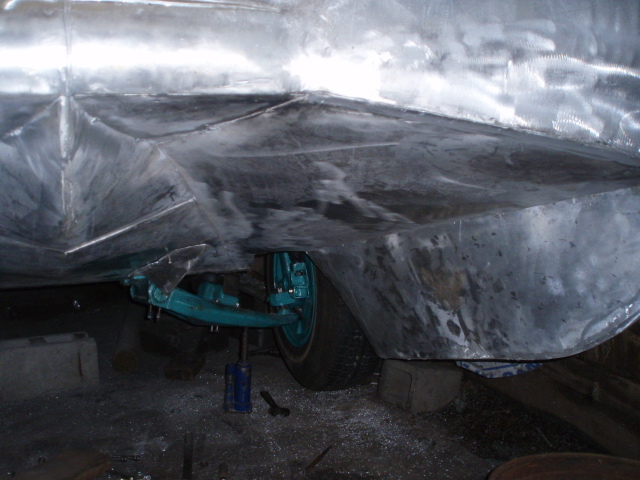

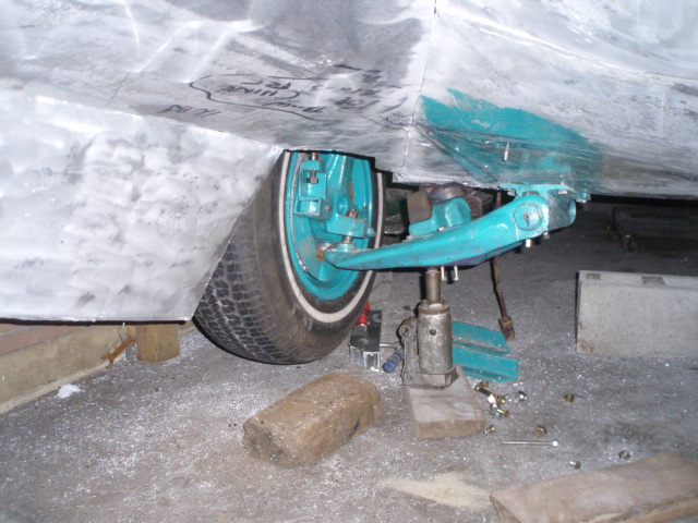

    the rear axles are live, (independent style) the differential center section( Cadillac suv) has a fabricated sealed tunnel with boots ,the live axles have stuffing boxes(like inboard shaft seal) and are also rubber booted to tunnels like power rack and pinion style Also the tunnels can be pumped with low pressure air to hold water out. same for power steering rack
  12. rick gray
    Joined: Dec 2012
    Posts: 87
    Likes: 4, Points: 8, Legacy Rep: 30
    Location: port coquitlam B.C.
    rick gray Junior Member
    power rack ands pinion /axle seals

    I wasn't making a prediction - just considering the downsides based on experience with trying to waterproof complex machinery. Stuffing boxes and boots can be problematic.
    But while we are on the topic, have you planned to stick enough flotation in to give positive buoyancy - at least during initial testing?
