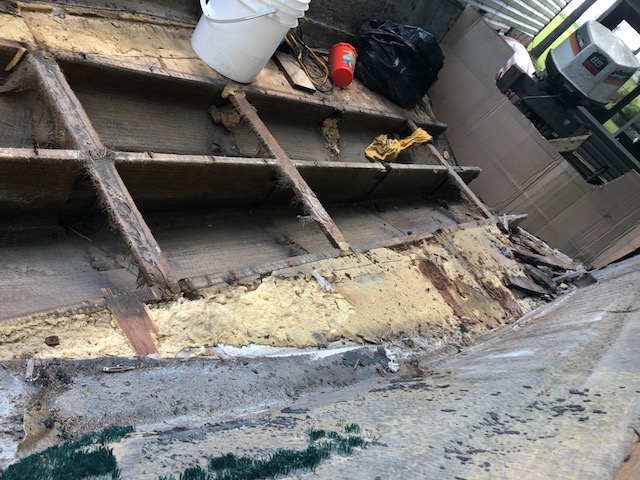

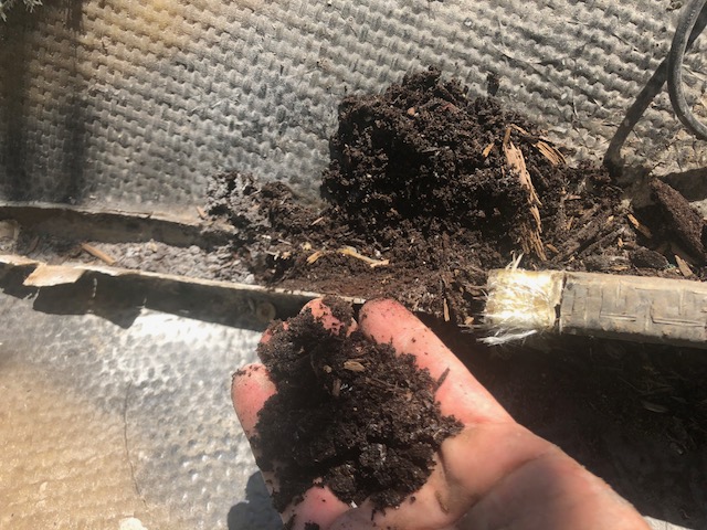

    hi, i recently replaced the transom on my 1987 Mako 224 i cored out the old wood material with a arbor bit and refilled core with trk2000, built up inner and outer transom with 4 layers of 1708 with poly laminating resin, and thought i had everything smoothed out pretty well, but after applying the 2nd and 3rd gelcoat layer, i can see that alot of the weave is showing thru in areas, And im unsure as to best solution. Do i sand off the gelcoat and add a surface layer of resin to fill in the weave more ? add another layer of 6 oz. cloth, then gelcoat ?
    or is it ok to simply keep adding more layers of gelcoat until the weave is filled in. i know gelcoat shouldnt be that thick, but what is considered acceptable ? I'm pretty sure i should not add a resin layer over the gelcoat to fill, then gelcoat over that again ? any help is greatly appreciated.

    thanks for reply's, i have been applying gelcoat with a short nap 4" roller and layers are going on fairly thin, rolling it out so no lines, its leaving a slight stipple, but i know thats un-avoidable. id have to say depest part of weave may be 1/16 to 1/8" max i already have rolled on 4 layers of gelcoat, sanding between layers to knock down any high spots and have been having issues where after just a min. the nap starts pulling off roller and gets stuck into work, where i have to pick it out and try to re-roll over it without making a mess of area, coats 3-4 filled in weave quite a bit,so as long as its ok, will keep adding more coats, will prob. stop after next 2 coats and call it a day. i did spread some epoxy/aerosil mix that i had extra from another project into the thickest weave parts as filler, will sand and give it 2 more coats of gelcoat today if weather holds. thanks for all your advise. will try to post pics tomorrow a.m. then on to next project, rebuilding dash....

    darkened some of the pics to show more contrast, let me know what u guys think - thanks
