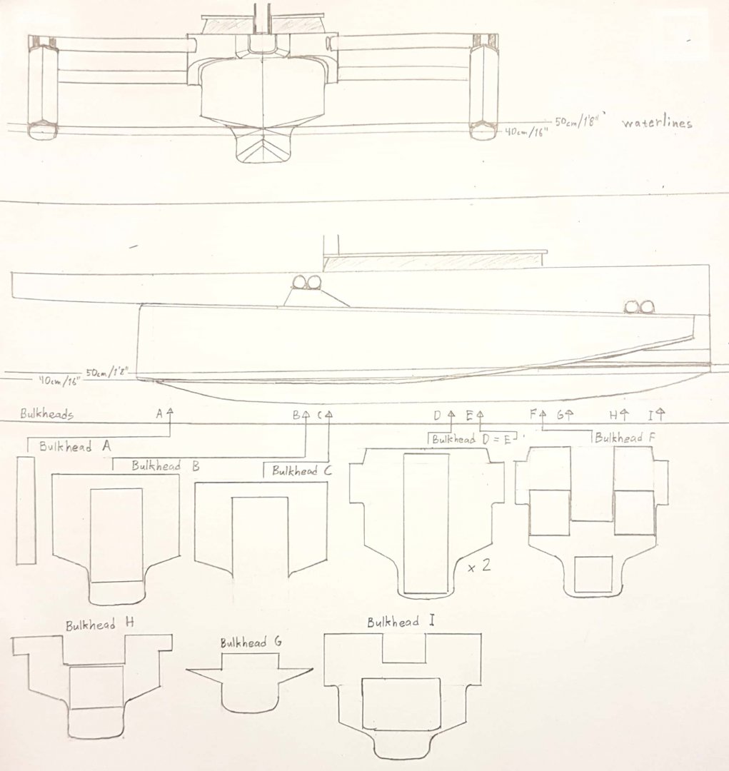

    I have made some preliminary drawings of the athwartships bulkheads on the waterline sketch. Trimaran 1 waterline and bulkheads_1.jpg

    MrMillard , I understand your beam requirements now , and de-mountable is a plus in my mind . Another question is why not bring your forward top beam ( b,c ) to top of deck elevation , I cant tell if the Alu. beam,s are one full tube,s running from ama to ama ?

    @rberrey. The forward crossbeams are ~5cm/2" beneath the deck line in the drawings to allow for a flat deck in addition to a molded toe-rail. The crossbeams are not continuous, that is why there are 4 holes. The beams slide past each other when the trimaran is folded. The amas are demountable too, but only for storage or shipping.

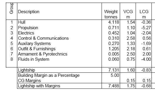

    or a Group 4:
    or Group 6:
    Finally finishing with your summary:
    Makes sense?
