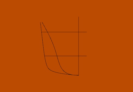

    bhnautika Senior Member
    Yes here are two deck heights and sections bow and mid

    Laax Junior Member
    Ok i've understood the principle!
    I think that if i want to achieve more beam in the lower deck i must have the room as high from the waterline level i can.

    Laax the Palmer boat is a totally different hull form and material to the Admiral so the hull structure will be totally different so comparing them would be difficult.
