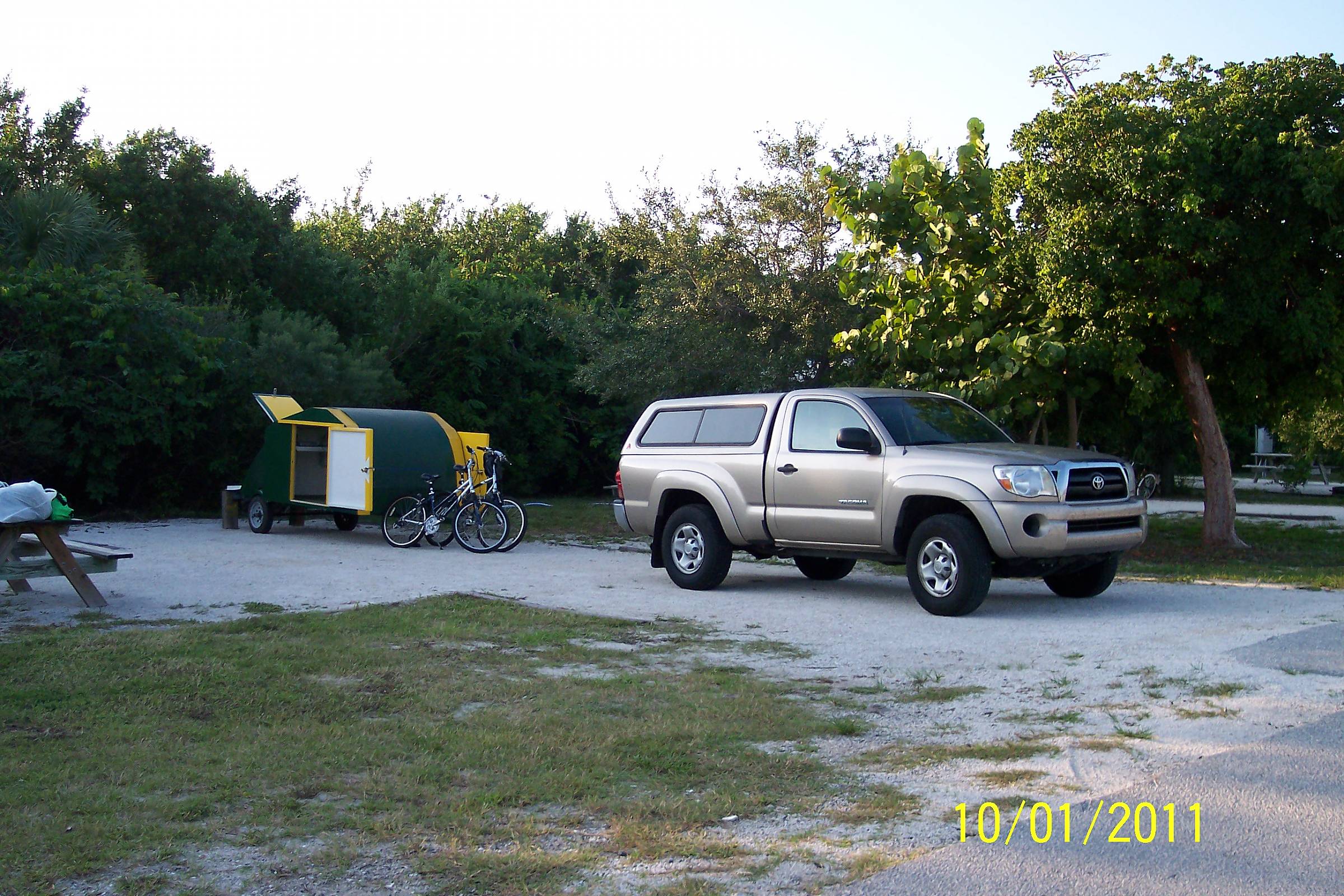

I like the Terra Cruiser but opted for the teardrop for reduced drag when towing. It is tight inside but comfortable with a queen size mattress. I am about to partially rebuild it with some minor improvements.

That's a neat teardrop. I've seen lots of cool teardrop designs at the Teardrops and Tiny Trailers forum. I've got to have a "standy" though. (And now I'm crazy about a sailboat plan with 4 feet of headroom... go figure.)
Thanks. If you look closely, you will see it is built on my old 14' boat trailer which I bought used for 200 bucks. The superstructure resting on the trailer cost about a thousand bucks counting the a/c and microwave oven.
Unfortunately, I built it before I discovered T&TTT forum.
