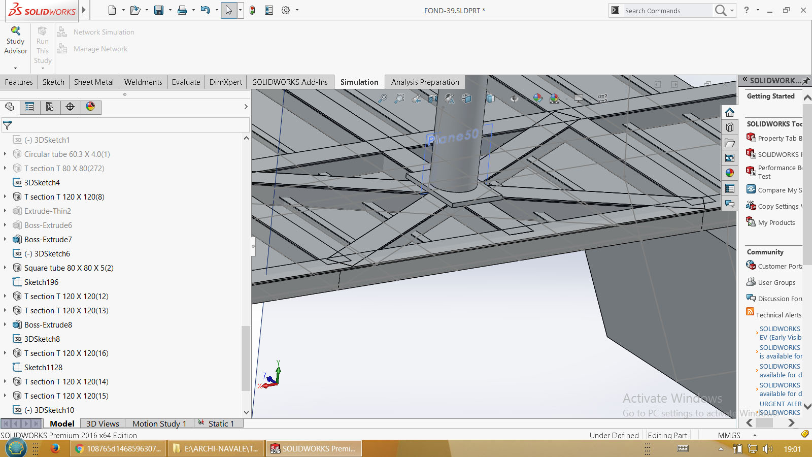

    On the fisrt picture my first try (for now just have 120mm T bar hight on botom and 80mm T bar on top)

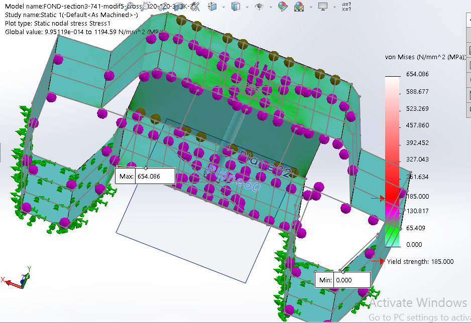

    look like the floor beam is more importand than the roof on my first simulation
    i am tring to make some simulation under solidwork
    but i am not a specialist of this software..

    In your case I'd forget that software and any other, I would place an additional beam below the pillar and calculate it subjected to a point load at its center. It is a very simple study of a beam in pure bending.
    The difficult thing is not that, but calculate the compressive force on the pìllar. Can you do that?
    The whole study we are taught in the figure is very nice but is useless as you have only modeled the plates, regardless of reinforcements and reinforcements are precisely the ones who will bear this load.

    the beam did not show on the result
    the model is (see picture) it is the botton part, the top part is similar

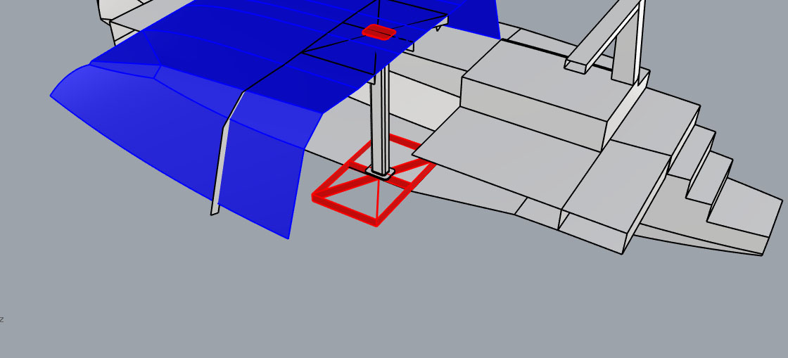

    on this picture
    http://www.boatdesign.net/forums/at...9398-alumium-catamaran-mast-roof-design-1.jpg
    blue part is the roof, in simulation thickeness = 5mm
    in red the grinder(the mast is bettween the to main grinder) now Tbar 120mm
    bellow the pillar round tube 200mm*10mm
    then grinder again Tbar 120mm
    bottom plate thickeness = 5mm

    Then it is very straight forward. No 'simulation' required.
    Since the two decks are connected by the pillar, all you have to account for is the transfer of shear load. Since the two decks that are connected shall act together as one (like any truss/link-span) and thus be very stiff, but, it will only do so, if you have sufficient shear area to transfer the load from the pillar to the supporting structure at the ends of the decks. If there is insufficient shear area, then the pillar shall attempt to penetrate the decks when under the mast load.
    Then after that check, you need to ensure the connection at the ends of the deck - where this shear load is transferred - has sufficient shear area itself. Otherwise this shall fail.

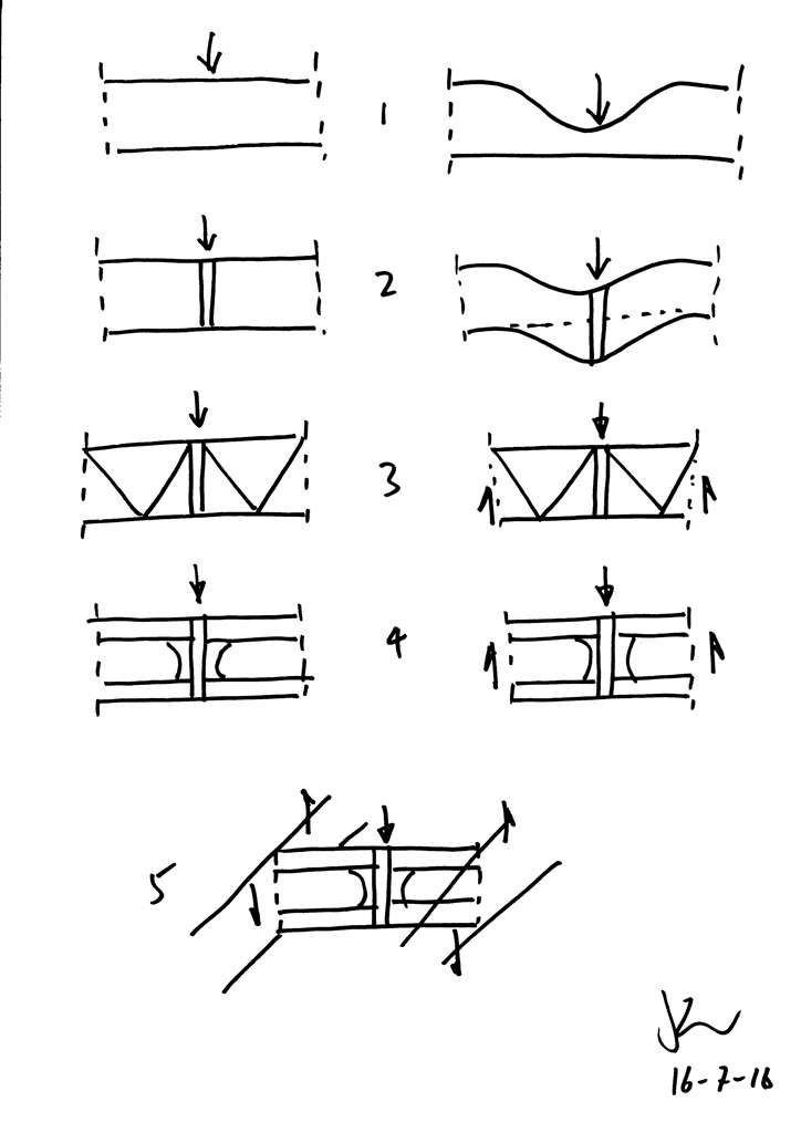

    Then you should not be attempting this. You should pay a naval architect/structural engineer to do this for you. Get it wrong and the lives of those on-board are on you…
    See image below:
    You don’t need numbers…just understanding of the structural mechanics. Image 1, the 2 decks are shown on the left hand side, then apply the mast load. With no connection (or strength in the upper deck) the deck shall simply bend as shown on the right.
    2) place a pillar connecting the 2 decks, apply the load, if the decks are weak it shall penetrate the lower deck, if the decks have some stiffness then the decks shall deform as shown on the right.
    3) Now, place shear members (struts/tie bars/beams) connecting the pillar – where the load is being applied – to the 2 decks as shown. Once the load is applied as shown on the right, the arrangement acts as one structure and is very stiff. It then simply transfers the load from the pillar via the shear members to the ends.
    4) Same as no.3) except you now have deck beams doing the job, but a connection from the 2 decks is still required, shown by the curvy bracket. Result on the right is the same.
    5) Once the load is transferred to the ends, the attachments also need to absorb this shear load – are the ends stiff enough and have sufficient shear rea.
    That is it.

    in my simulation 120mm T bar Look OK with 100 000 Newton
