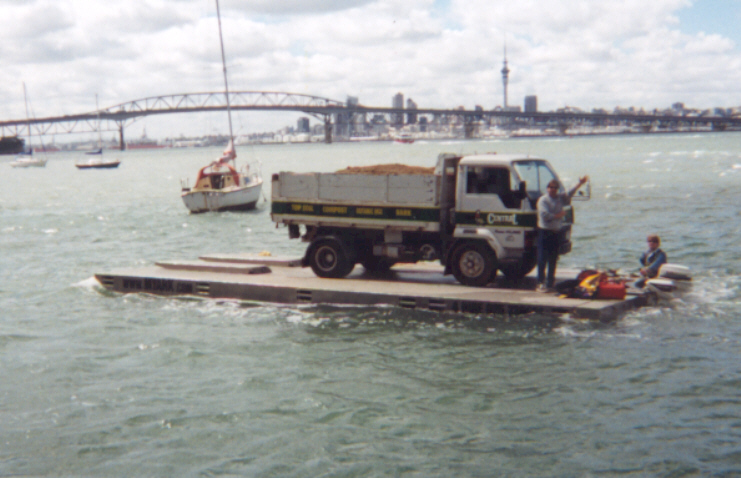

    From the look of the boat shape there is not much curve to be added so the simple answer is you do not to need to go thicker plate but add a series of stringers, say 4mm X 75mm in the regions you believe will be knocked with out side force.
    An example of a 10.m Myark folding trailer barge is a 4mm 5021 tread plate aluminum deck, with a 13 ton digger load on top which I placed 4mm X 60mm stringers 100 m apart and did not leave any damage with a 13 ton load on top but maintained the lightness I needed to be legally towed on road.
    I did place a 5mm hull bottom but that was because of a sharp object may puncture the hull when the ocean tied would go out leaving the barge sitting on top of rocks with weight on top need extra strength.
    The picture of barge weight is under 2000kg folded in trailer form.
