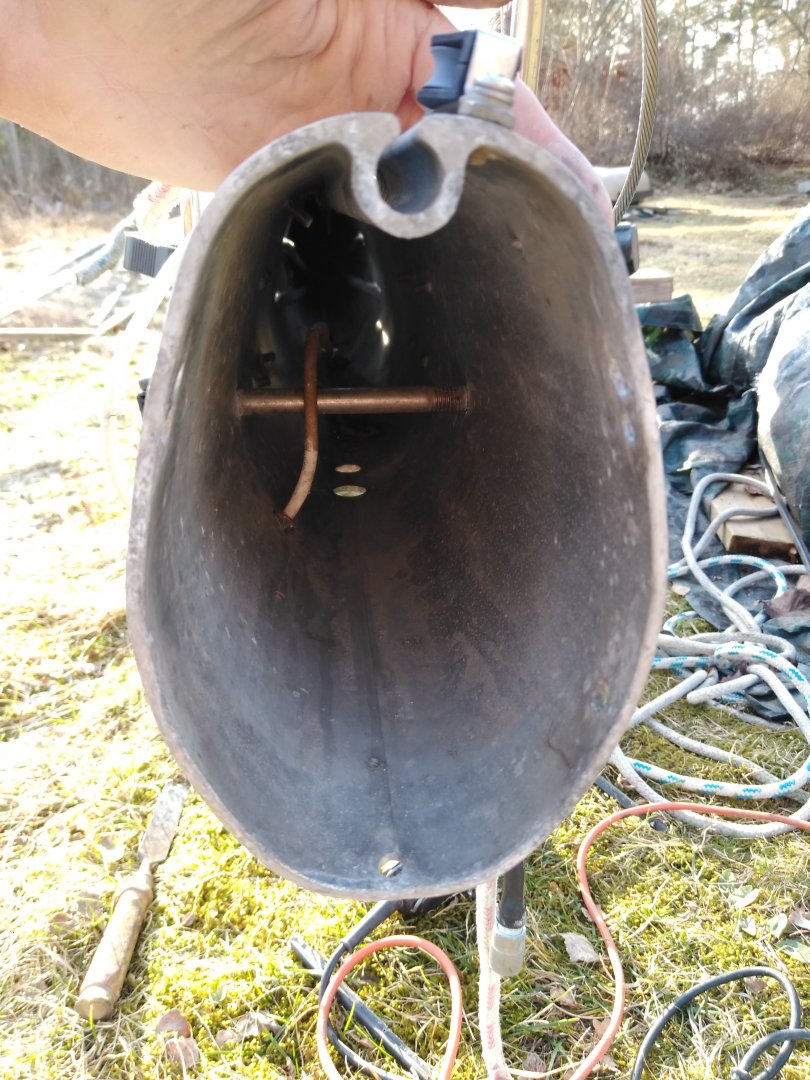

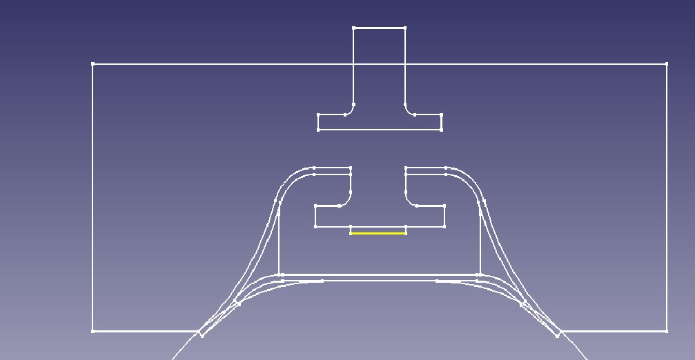

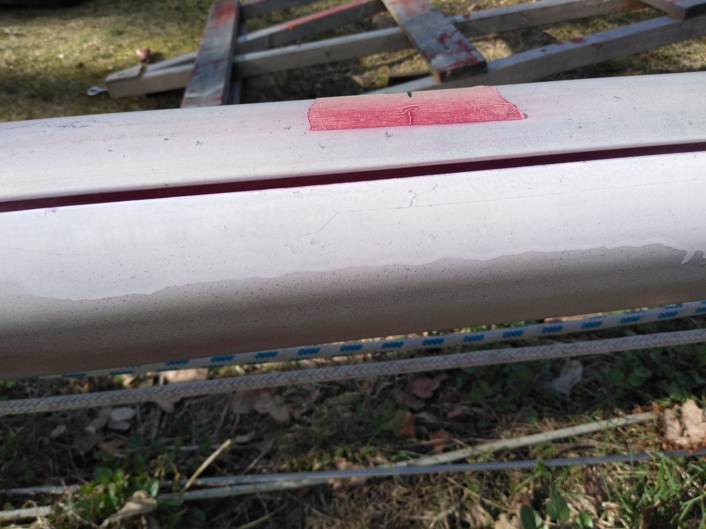

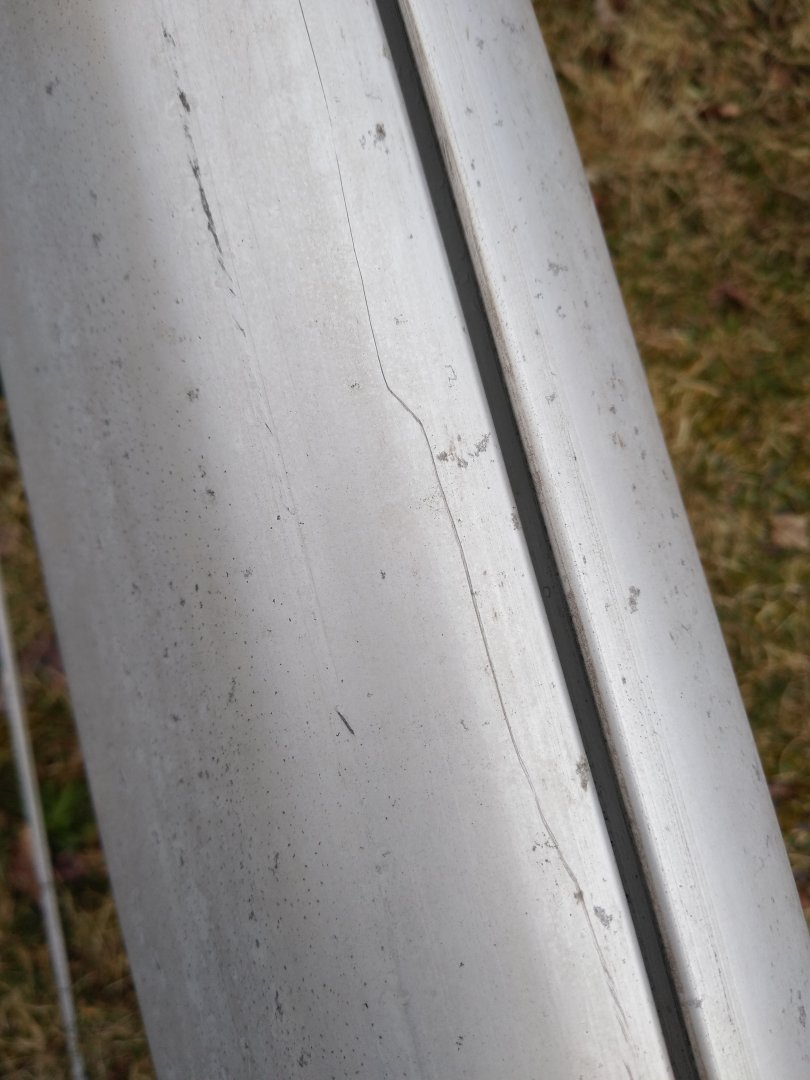

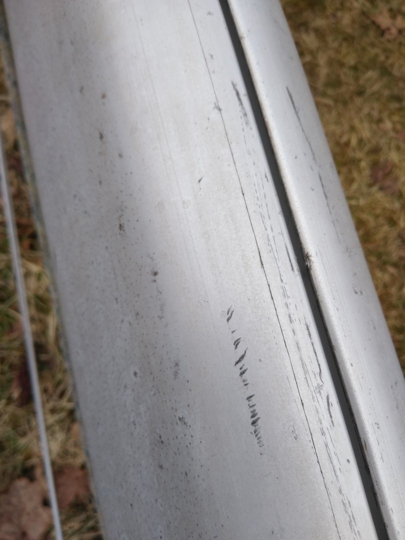

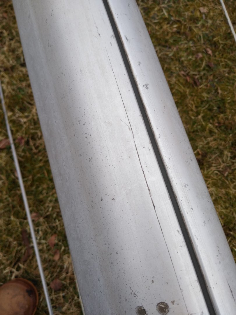

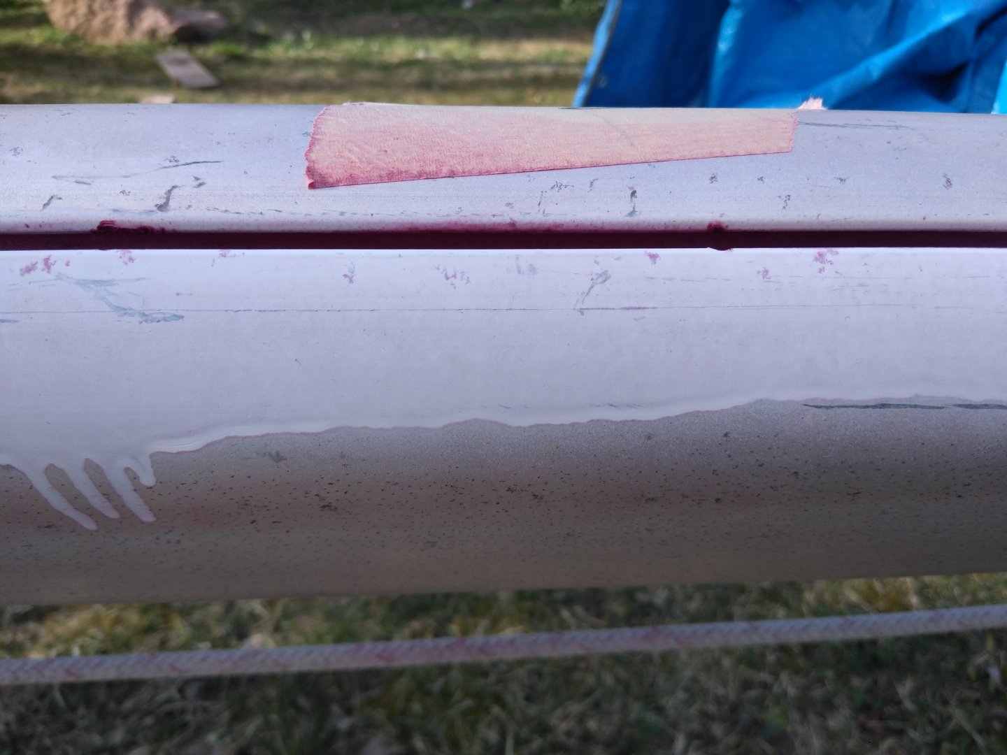

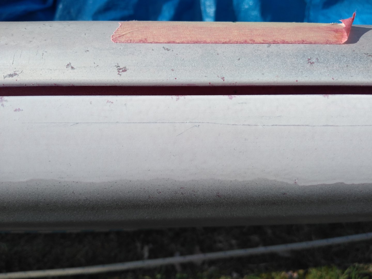

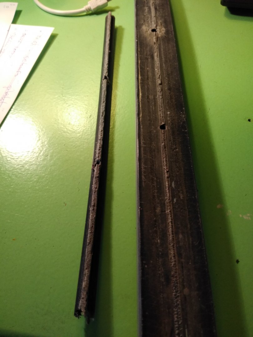

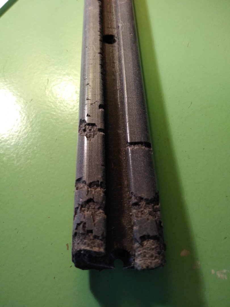

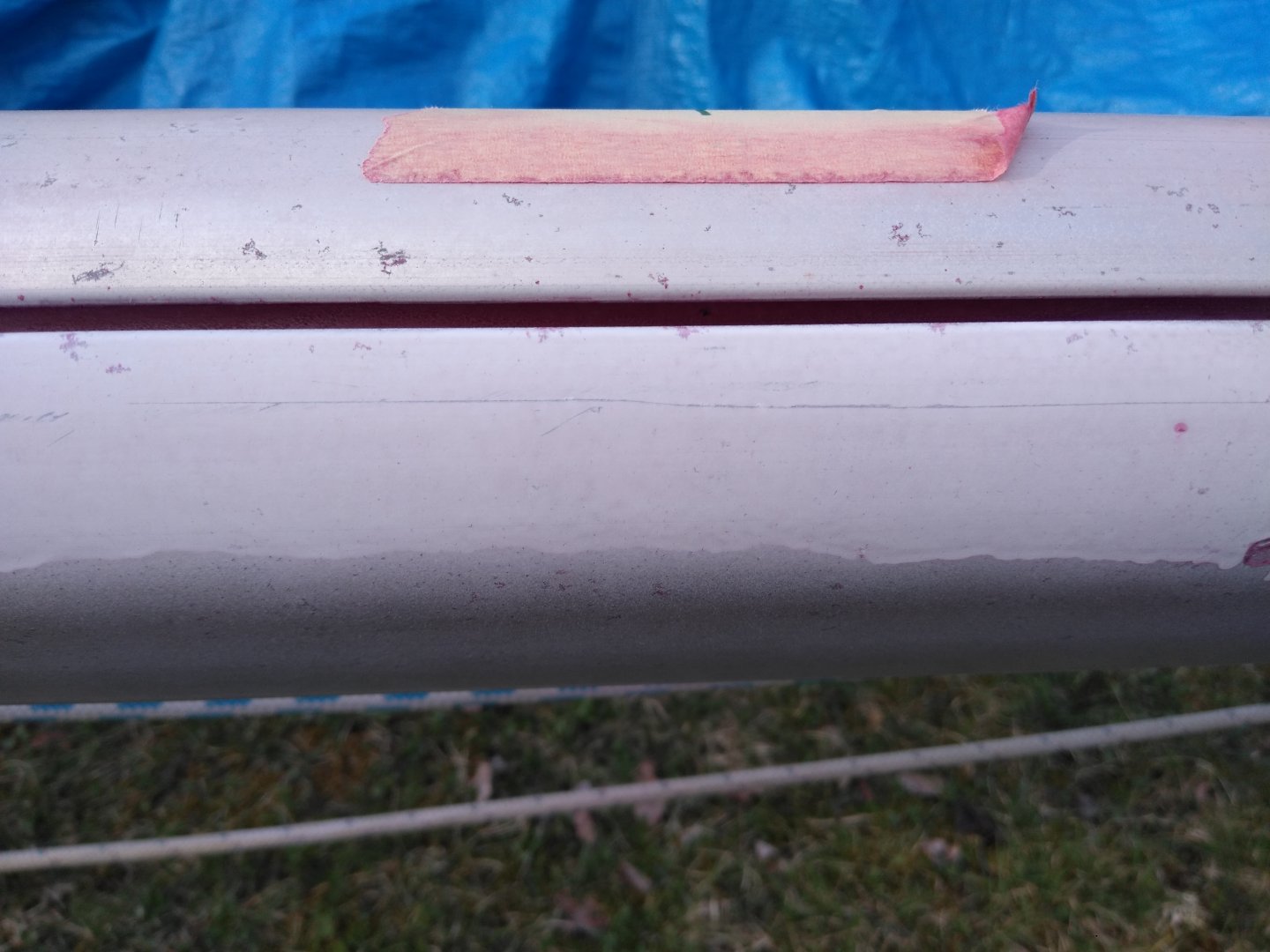

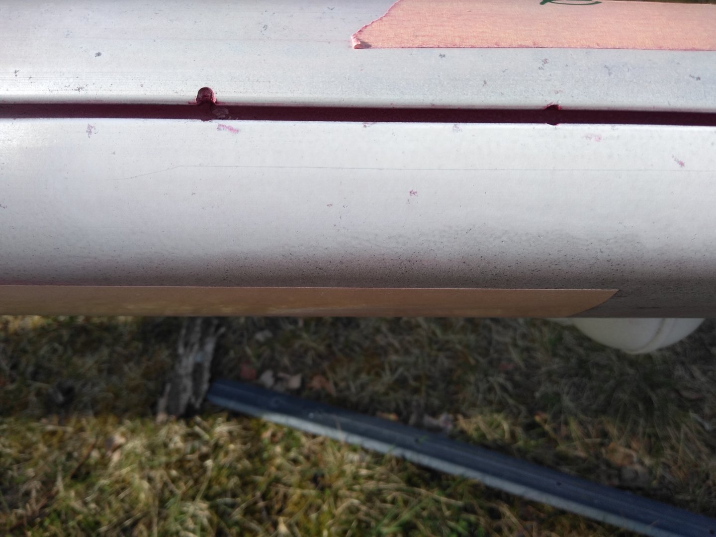

Hej, I would like to have your opinion about this situation.
Mast from a 20 year old Farrier F9 tri, rotating mast, length about 13 meter, setup from bottom to top: 1 m unstayed, 4,5 m stayed, spreader, 4,5 m stayed, connection front stay + back stays, 3 m unstayed to top, 5 cm bend over stayed 9 m, thickness aluminium: 3,7 mm

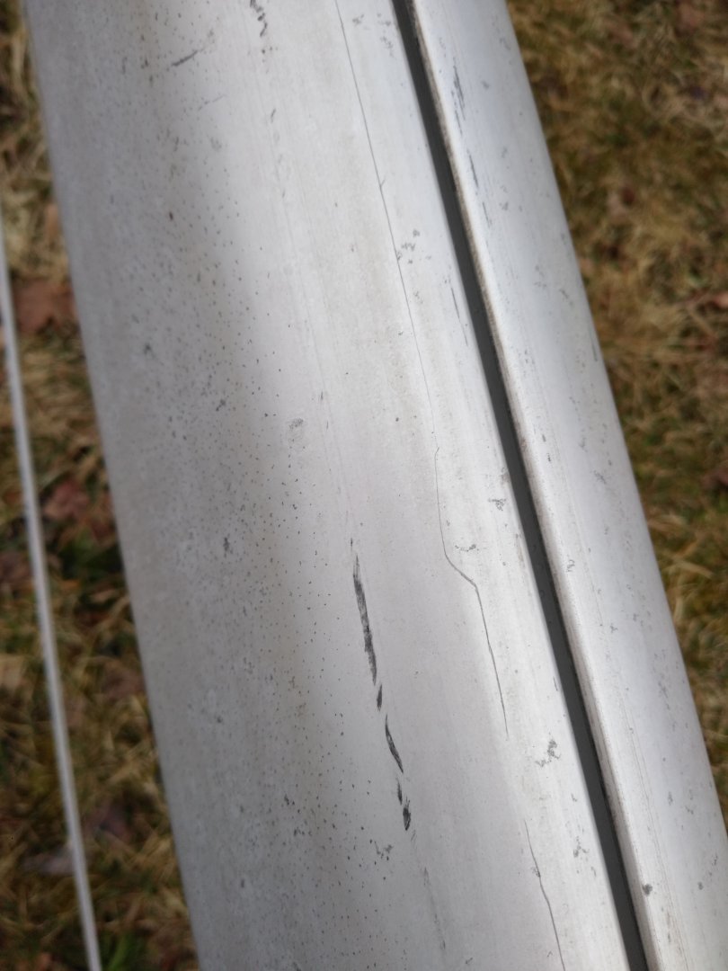

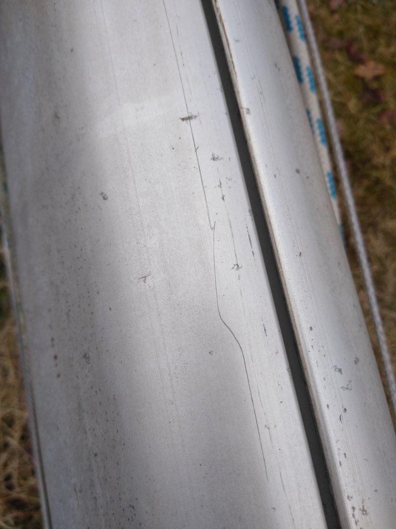

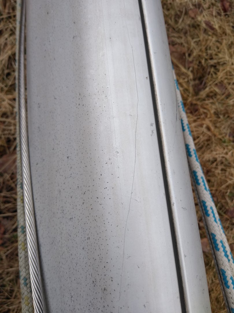

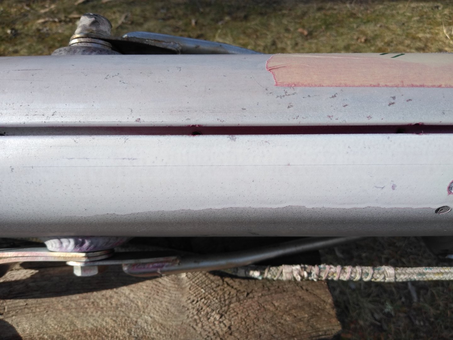

I removed the HMPE sailtrack and cracks?/scratches? now show mostly under it. In the process of making new laminate covered HMPE sailtrack, but not sure or the mast is OK. See pictures
- the crack/scratch is over most part of the mast, also the upper unstayed part
- only on one side of the original masttrack, in the corner of
- on some parts the surface is uneven at the different sides of the crack/ scratch
- searching on internet I was not able to find any pictures of identical situations
- I suppose compression and tension loads are more or less equal in aluminium so I can't explain why the backside
- Mast is not new but looks fine except 1 spot of pitting corrosion (20 mm2)
- Poured thinner over the crack/ scratch which runs of smoothly. Pushing a paper towel a few cm next to the pouring spot gets wet.
