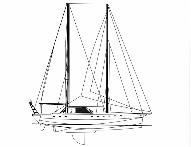

    I am currently looking for aluminum hull ballast options as well. One thing I had dreamed up was to pour concrete inside the keels (I am considering a twin keel design), then bolting on a lead bulb at the end. This would concentrate the weight lower, and the concrete inside the keels would keep the size of the bulb manageable.
    Any ideas about how this could work? Of course, the lead and the bolts would have to be isoloated from the aluminum with some HDPE or something...
    Here's the pic that got me thinking:
    http://www.boatdesign.net/forums/at...159817634-brewer-aluminum-design-g2612179.jpg
  5. cvzzr
    Joined: Mar 2009
    Posts: 5
    Location: Vancouver Island
    cvzzr Junior Member
    Sorry for posting again, but here's another pic that I find interesting and it may be relevant to the original poster:
    It seems that as long as the lead and bolts are electrically isoloated from the keel, it should be no problem, with the added benfit of a lower COG...

    Those bulbs at their aft end will be nasty for fouling anchor rodes. I had that problem before I ran a heavy flatbar vertically from the tip of the trailing edge to the hull. I now make the trailing edge vertical, for that reason. Experimenting with a piece of string and couple of keels on a board will make obvious what works and what doesn't . When you foul a rode there in a bit of wind or current it is very difficult to get it unfouled. Could be dangerous on a lee shore.
    On those keels, being more vertical, the trailing edge or flatbar should run slightly aft to where it meets the hull. This is another example of how what works well on paper and in the math, doesn't work out in the real world , or shows the importance of hands on cruising experience.
    The rudder looks as flimsey and fragile as they could possibly make it, and very prone to fouling.

    I agree with the fouling and rudder comments. This designer has a bit of a better setup on his 31', with the rudder skeg triangulated back to the hull via the propeller shaft skeg. I would change the design of the keels to eliminate the extension of the bulbs.
    I do like the idea of the bolt-on lead as it gets the COG lower, though. I would still want some ballast in the keels (concrete, maybe) to maintain some stability if one lost the lead off the bottom due to a severe impact or whatever.
    I am still considering your 36' hull, but I am finding that aluminum is relatively cheap right now, and I have some experience working with it having built a welded aluminum 17' skiff. I want to stay with the twin keel idea for the ability to keep a boat without moorage (it may be a little more crowded down where you are once I get a boat in the water :) )
