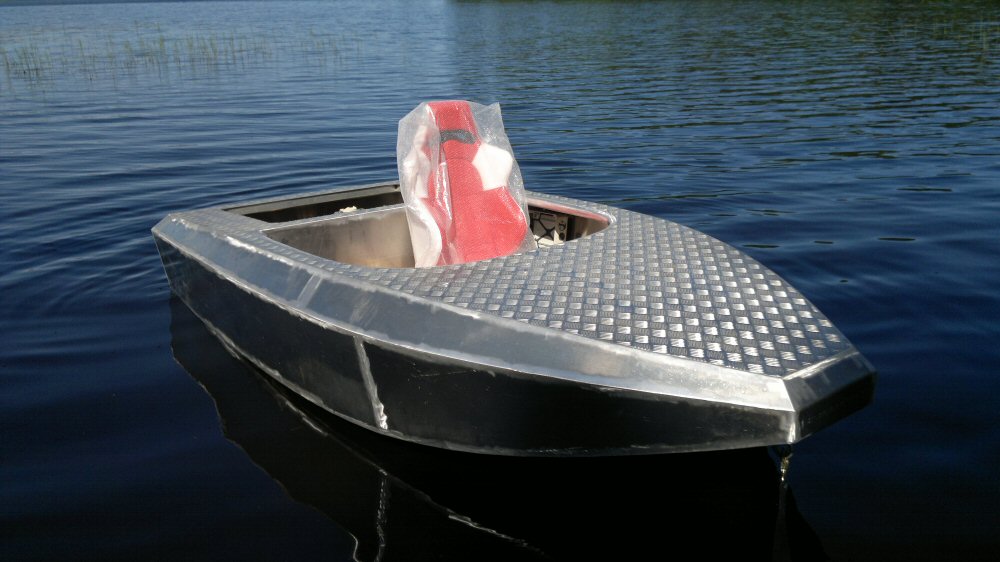

    that diamond plate decking looks interesting

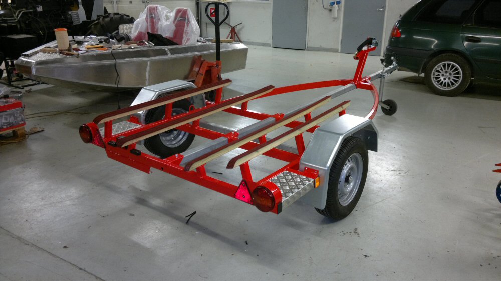

    Thought it is time to update a couple of images here too, it's been 518 days since last time after all.
    Made the trailer too.
    Test float, July 8, 2013
    The heat exchanger.
    Trailer painted and ready for registration.
    Yesterdays score
    cheers
    Lurvio

  7. Barry
    Joined: Mar 2002
    Posts: 2,045
    Likes: 640, Points: 113, Legacy Rep: 158
    Barry Senior Member
    Sweet looking boat
    The biggest concern area of concern that I would have is the engine compartment
    A marine engine has the distributor, and alternator sealed and spark arrested as well as putting a flame arrestor over the air intake so that if you get a combustible fuel mixture in the engine compartment, it has less chance of being ignited.
    Hard to tell where the air intake is for the engine, perhaps down the inside of the engine compartment. I would find a way to get this intake from outside the passenger area so that if you have an explosion, the flame front will not come into this area.
    You should have some engine compartment exhaust vents to keep vapors down in any case, and I believe that ABYC/US coast guard guidelines, which do not apply to Finland but are a good working set of rules, required the compartment vents not to be vented into the transom area.
    Alternatively, I would mount two blowers to exhaust the engine compartment, that run all the time the engine is running to lower this possibility. Two, only because if one should fail you have a second unit as back up.
    They are a very cheap insurance
    I would have changed the area ahead of the intake a bit so you did not have the front edge of the intake so close to the transition between the hull deadrise and the flat area.
    Normally, jet pump manufacturers want a flat area 2 to three times the length of the intake ahead of the intake. Does not mean that your config will not work but rather it might not be as good as it could be.
    How are you driving the pump, vdrive or belt drive?
    Want to see some youtube video when you get it running.
    Good luck

  9. Barry
    Joined: Mar 2002
    Posts: 2,045
    Barry Senior Member
    The coupling should be a flexible coupling for a couple of reasons
    First it is hard to get the flywheel and the pump intake concentric as well as parallel
    Even a few thousandths out of perfect alignment will load the pump bearings unevenly.
    The other item will be the odd bottom grounding that you might have.
    I am not sure about the ductility of your pump but we had a situation many years ago when a customer hit a rock and cause a deflection of the hull and the pump intake housing actually flew apart, sunk the boat, bad experience.
    A flexible coupling will lower some risks here
  10. Barry
    Joined: Mar 2002
    Posts: 2,045
    Barry Senior Member
    Another item
    I did not see lift strakes on your hull
    We used to install 3 inch by 5 angle lift strakes, one pair about 1/2 way in as well as turn down the chine by the same amount to the bottom of our boats
    Certainly we got some lift from these items but the biggest thing that we saw was an
    increase in steering. The strakes tended to cut the water and prevent the hull from sliding in a turn. If you have not ran a jet before, they turn best under power and will not turn if you back the power off. The strakes would hold quite a bit of the slip and if you turned and applied power the effect was dramatic
    Do not form a lift strake as the outside edge will be curved and this will actually pull the hull down due to the Coanda Effect
    If 3 inch by 5 inch is to aggressive, you could cut the 3 inches down to 2 inches. On a 12 degree hull we would use a 2 x 5 and on an 18 degree the 3 x 5 appeared to work best
    Of course the 5 inch is the almost flat portion and the 3 inch or 2 inch is the almost vertical leg.
    This piece must be welded on the hull bull length, as compared to being stitched so you do not lose the lift ability by bleeding off pressure. Some manufacturers stitch weld this on and leave the back of the strake open. This is almost counter productive for lift, though the steering help would still be there
