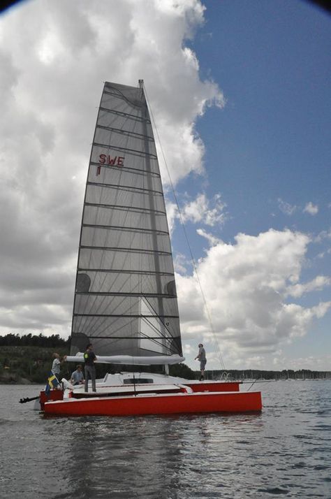

    Mark. Yes there have been some boats that have used a Wharram soft wing on a non Wharram cat with reasonable success. I cannot find the photo's on the web but it was about 30 foot full bridge deck cat and sailed successfully for a few years. Also if you want a real wing mast plan (stressform 6 PDF's) with full details go to Multihull Structure Thoughts thread on boat design net Page 5. The wing mast was designed for a 26 foot tri that would have a similar righting moment to a Prout Ranger. There are a few other ideas attached including a tri under the VPLP banner.

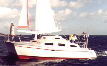

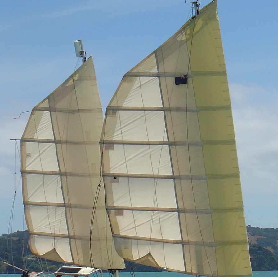

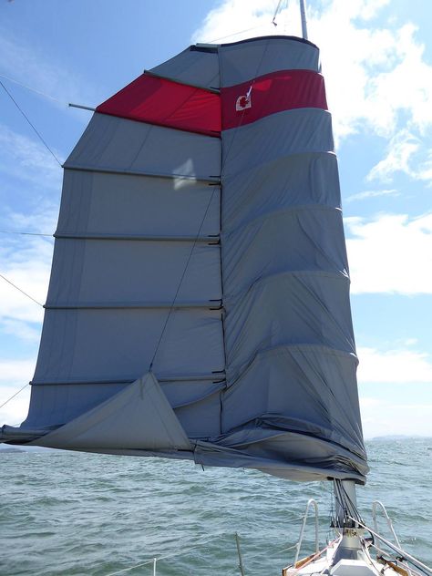

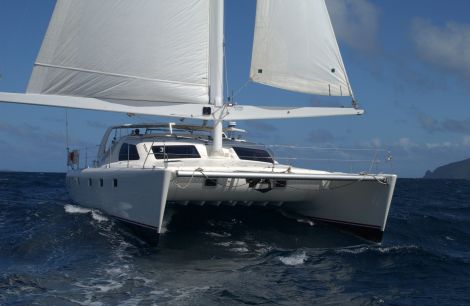

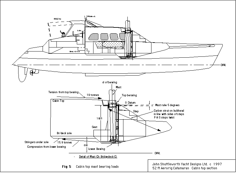

    Mark and Rumars. If you are prepared to do a little reinforcing of the cabin roof and wing deck area a single free standing mast on a cat is very possible as indicated by the photo's below. I am not suggesting an aerorig but a junk rig etc could be done on the free standing mast. I have limited information on the Hirondelle reinforcing structure. Also a comparison of a split junk versus a conventional rig is available at Bermudan rig vs Junk rig - Practical Boat Owner https://www.pbo.co.uk/seamanship/bermudan-rig-vs-junk-rig-17481
