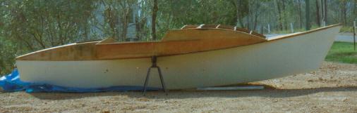

    F bomb. I was wondering what those floats were. I owned that center hull once I believe, below is a photo from when I bought it.... 2005 or something ?
    It is possible I do not understand what you are suggesting above. If it is to immerse both floats nd partly support the center hull than I'd imagine it would sail like a 60's tri which carries all 3 in the water, Horstman, Piver etc. So it would probably be a bit slow, but it wouldn't walk at anchor, which is a plus. The motion in a crossing sea might be a bit more cat like.
