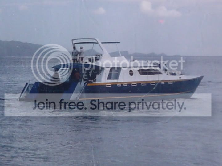

    Yes. In 1995-96, I collaborated with a fellow designer to construct an air-lubricated planing catamaran hull for a Barbados client. The vessel, named "Ocean Mist", was 18.25m x 8.0 x 1.00m, arranged as an eight-passenger, three-crew charter boat. It was powered by twin 400-hp Cummins through conventional shafts & props, and achieved 31.25 knots during trials.
    Her owner sadly was diagnosed with cancer a few years after delivery and, after a valiant struggle, passed away two years ago. The boat was sold prior to his death and I have lost track of it.

    Tom, what type of more objective testing and reporting would you like? The boat in the photo above is a shallow-vee planing hull form terminating in a flat after section bounded by rails, into which an air stream is introduced to reduce skin friction in the after part of the hull. Top speed of the hull exceeded calculated expectations for a non-ventilated hull by approximately 20%. I thought it a rather successful real-world demonstration of the principle. Too bad we didn't have an additional half-million dollars to build a similar conventional hull as a trial horse, I guess.

    Well Michael, some experts claim that air entrained water under the hull decreases drag and some say that it increases drag. I have read these claims but can't direct you to them. The boat in your example gave results with injected air but no performance data without the air. I don't think you would buy that without further data and I don't either. Your reply adds some information that would have helped (the 20%), but it's still calculation, not demonstrated. I don't have a dog in this fight, I'm just interested.
