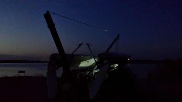

20 minute trailer sailer
It's has been 17 months, since I did any sailing, had surgery last year, so I never stepped the mast. I am surprised the aft mast is not equipped on a few trailer sailors, as I can launch, after 20 minutes of rigging. It took me 30 minutes to derig, in the dark. Single handed. It would be easy to do it in 10 minutes, with two.
The wind was 20 mph, the helm is super easy to balance out with the swing keel, moved forward, from last season.
Tacking through the irons, is smooth and steady.

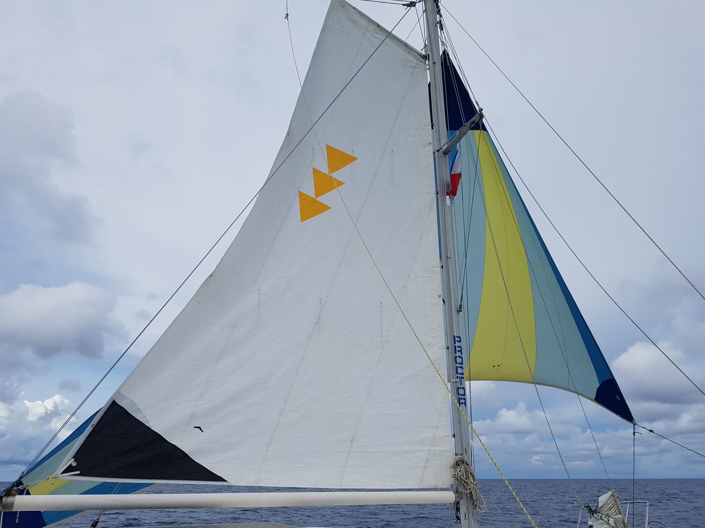

I want to relate a very pleasant experience I had with what I call a screecher.
I inherited the sail when I purchased the vessel and never had a big tall center mast to fly it. Being the experimental sort, I hauled it up the mast sideways. 20180703_151209.jpg
I apologize I have the gaff rigged main in the same shot. Notice the screecher "head" is out of view to the left in the photo. I had to secure it on the rear cleat on leeward ama. Before everyone starts yelling at me, let me first admit that yes this sail obviously was not designed to fly this way. This said, I was able to sail my vessel up to 8.5 knots on this sail alone. Wind was beam on and about a constant 15 knots. Yes, that is right, the mainsail was down and this sail, that I could pickup out of my storage locker single handed, powered a 65ft trimaran at 8.5 knots.
This was working so well I was thinking of making a larger one with a bigger foot so I didn't miss so much wind escaping below it.
The point I am slowly coming to is all about the cut of the sail used in an aft mast rig. I had Tasker make my foresail very much like a jib with a tall luft back end. What proved workable in my little experiment was a sail that came to a point down on deck level. Again what I so anxiously wanted was even more sail area up front.
And that brings me to the whole point of my post. Gollywobbler. There I said it. I just so much like using this odd word.
Follow the lines of my main sail and see the gaff pole. Now imagine that gaff pole is replaced by a wire leading up to a mast behind the boom. Also while we are at it. Ditch the boom. I've never liked booms!
I believe I am correct when I say, that after the addition of the second taller mast, my mainsail seen above would be a gollywobbler. The enter rig would be called a schooner.
But let's not stop modifications just yet. If I shrank the foremast and moved it forward, I could gain the sail area I enjoyed getting by using a separate foresail. If I was to approximate on my vessel, the foremast would be about 20 ft tall and located 10 ft behind the front chainplate. The aft-mast would only need to be about 45-50ft.
The whole point of these modifications is to maximizes the size of the gollywobbler. I believe this sail alone would be adequate for cruising. More speed could also be obtained by adding an inner stay sail connected to a boom, a very small foresail, and a stern sail.
