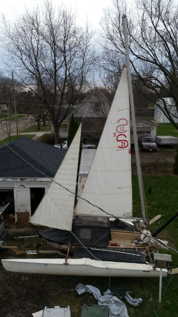

  10. markstrimaran
    Joined: Dec 2014
    Posts: 291
    Likes: 6, Points: 28, Legacy Rep: 28
    Location: usa
    markstrimaran Senior Member
    150% geona. aftmast, 24.5" Hobbie cat donor
    Just getting set up for the 2017 season. The debate continues. It's a 18" aft masted, trimaran, built to fish.

  13. markstrimaran
    Joined: Dec 2014
    Posts: 291
    Location: usa
    storm rig
    Early season rig,
