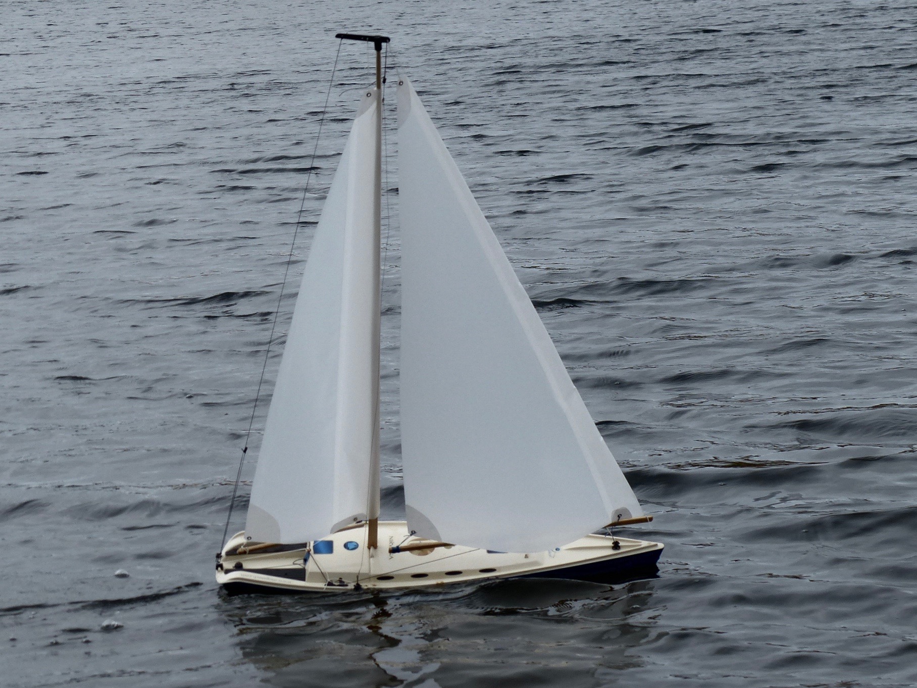

Converted my remote control "Nirvana" sailboat into an aft mast rig and gave it a test run today. Still a few bugs to iron out in the rigging, but first impressions were more than encouraging. Acceleration and handling are noticeably better. Top speed seems higher - I have never outrun the wind waves before. And doesn't look half bad either.
The mast is 100mm shorter than the original (on stand in picture) and the sail area is about the same overall. I have positioned the mast where it was most easily possible to do so and this gave a reasonable size for the smaller mainsail. Essentially the main is just a tool to reduce the drag on a bare mast and to provide the balance in the overall sail plan.
The 'main' is likely doing more than that as a helper,...but nice experimentation. BTW what are your sails made of?
I bought the sail material online from https://www.radiosailingshop.com.au/index.php?main_page=index&cPath=15 .
I got 5 metres of Poly362 NEW Poly/Mylar Film 36 Micron NOW 600mm Wide per metre (Poly362) for $AUD34.25
i'm thinking of making a longer sail for my Nirvana, to come past the mast like a 130% or so genoa. This will require altering my servo to become a fully revolving winch in order to sheet in around the mast. A bit like this fantastic and very expensive model boat from Stockmaritime http://www.stockmaritime.com/premiu...navi1=394&navi2=0&navi3=0&detail=2&lang=en_GB.
I've also sailed my model without the main and it sails just as well. It even has a weather helm contrary to what you might think. I noticed this as well on my 24' aft mast gaff cutter when sailing with only the two foresails (no main).
