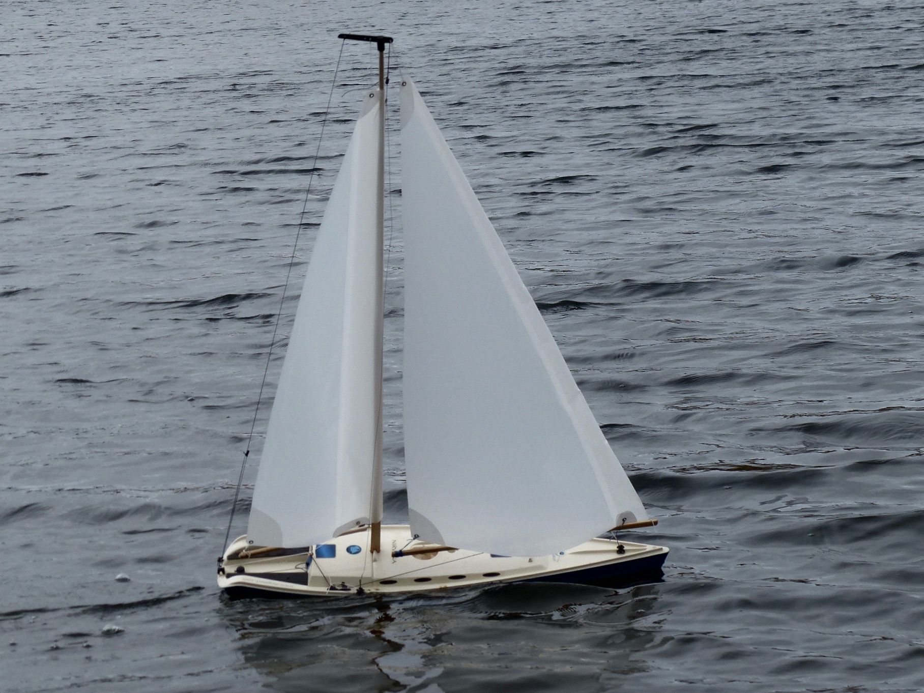

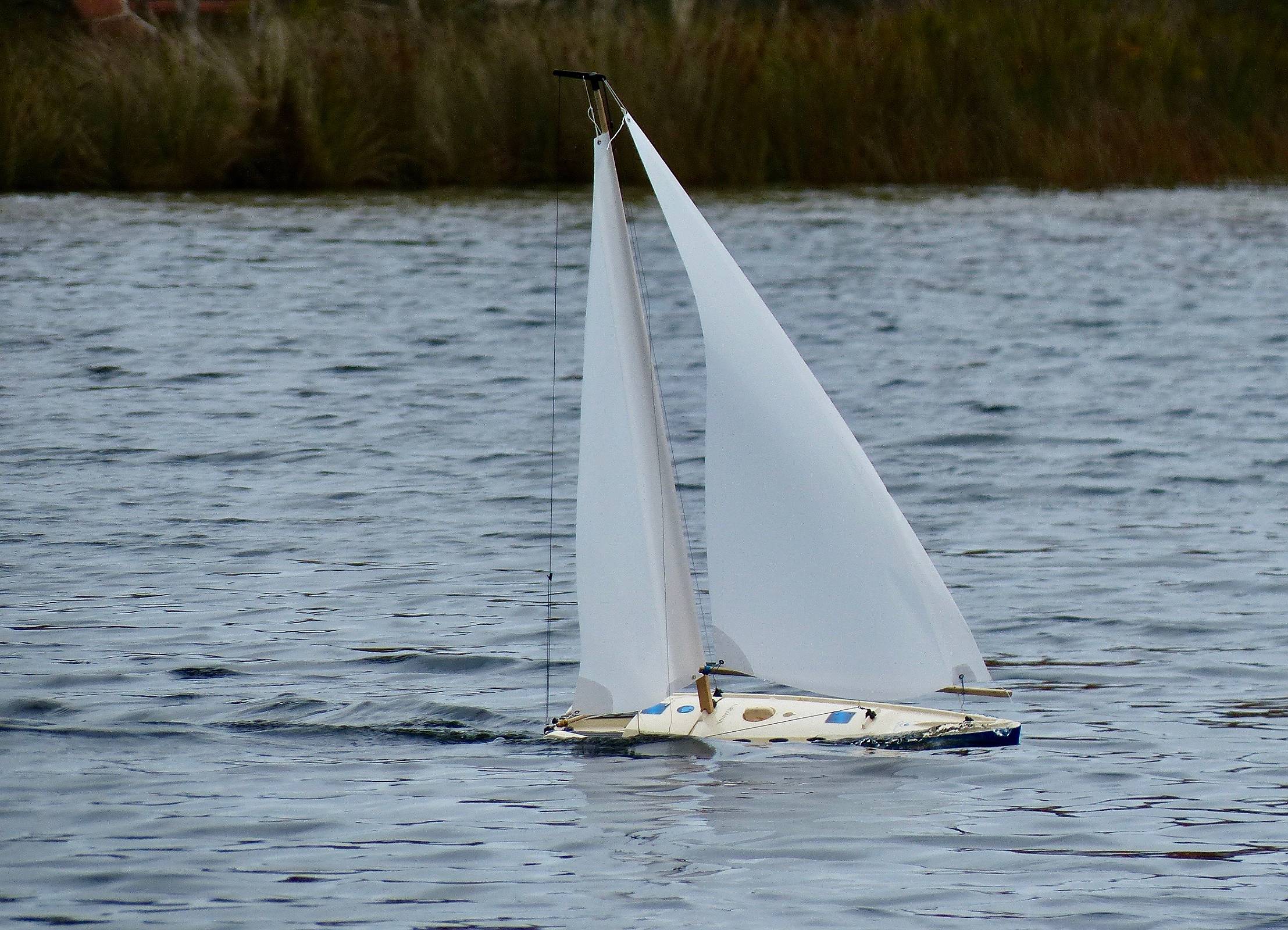

Converted my remote control "Nirvana" sailboat into an aft mast rig and gave it a test run today. Still a few bugs to iron out in the rigging, but first impressions were more than encouraging. Acceleration and handling are noticeably better. Top speed seems higher - I have never outrun the wind waves before. And doesn't look half bad either.
The mast is 100mm shorter than the original (on stand in picture) and the sail area is about the same overall. I have positioned the mast where it was most easily possible to do so and this gave a reasonable size for the smaller mainsail. Essentially the main is just a tool to reduce the drag on a bare mast and to provide the balance in the overall sail plan.
