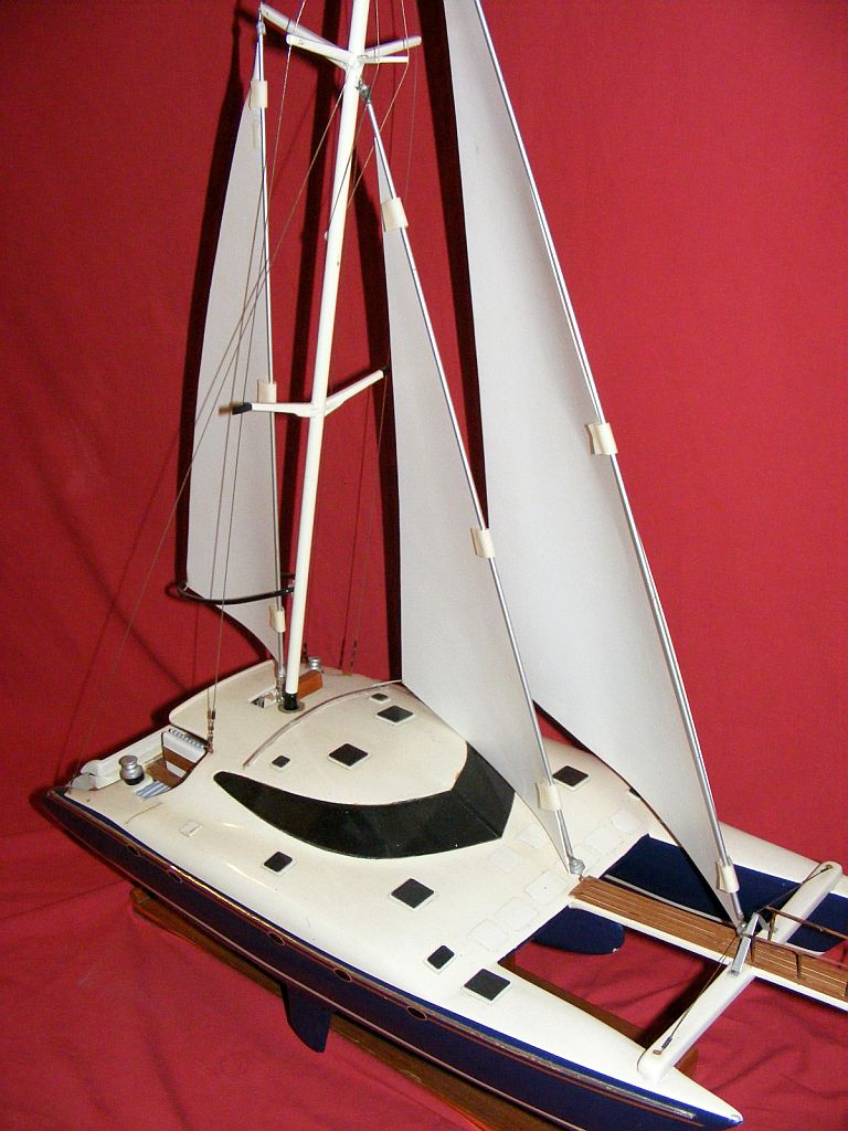

So, my plan is to sell the main and the boom and put a big furling 'main'?? behind the mast, like some of those Turkish Goulets I mentioned before, then I will not be afraid of having two sail up in the middle of a dark night....
Now, I can hear the armchair sailors and the racing fans say "you'r mad, you'll loose so many knots" etc etc, well, that statement is still to be proven, I have records of my boat performances and will put it to the test.
However, for all the reasons above "I don't care!"

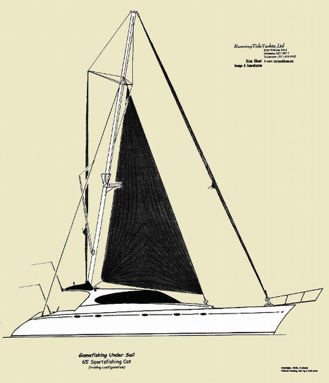

You know I can still imagine sailing a big 65-foot catamaran with this mastaft (single-masted ketch) rig right off the mooring, and back to the mooring, without the engine, by myself, with so little effort that I might take it out having only a few spare hours to kill, or for just a carefree daysail.
I wouldn’t have to uncover any sails, nor recover them when I returned to port. I'd likely start out with just unrolling that central 'mainstaysail' then add in more sail area as needed.
I would be less concerned with reefing by myself if the wind were to really come up. If I were short-handed at sea, I would have many of the benefits of a ketch rig, without the necessity of slab reefing the main and mizzen sails of the traditional ketch rig. I'd be in a constant state of helm balance as I could tweak the mizzen sail for that.
That about sums it up. I would like a 65 foot cat that I could take sailing by myself, and that might even be easier than a beach cat. Try hoisting a full batten mainsail on a 65 footer by yourself, or even a 40 footer. Most folks over 50 will have second thoughts, or will just unfurl the jib and forget about hoisting that traditional MAIN sail.
I'm 65 (now 73), and I could sail this 65 foot cat by myself with this aft mast rig. And with the balance and low power afforded by the smaller 'mainstaysail' I could sail this vessel right off the mooring or maybe right off a side-to-dock slip.
Here's a challenge Mr Naysayer..... Le Mans start. I'll be out sailing before you get the covers off your mainsail, and when we return for the day, I'll be at the bar sipping on a Margarita watching you put away your vessel for the day.
