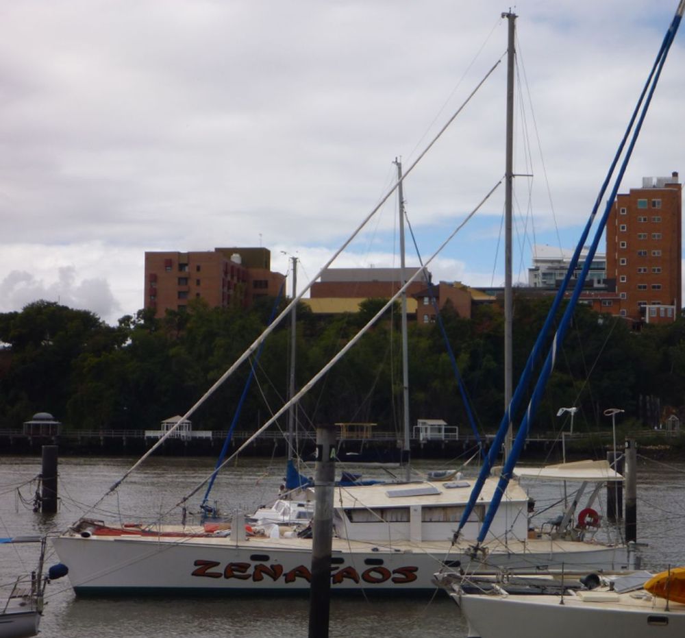

    I was simply quoting what the website quoted. I assume this was what the vessel's designer were told to execute, because of the previous experiences by the client.
    The client apparently had had several vessels before with roller furling booms.
    I brought that subject vessel up for several reasons, primarily at first because it had a similar 3-jib like leading sails on 2 mast, plus an 'upside-down, fisherman sail filling that triangular space between two of those leading leading sails.,....akin to the rig I made reference to with this Doyle CFD study, a jib-schooner.
    Naturally I also found it interesting that with the all-furling aspect he could have easier handling as I have expressed before for my aft-mast rig.

    http://yachthub.com/list/yachts-for-sale/used/sail-catamarans/hitchiker-15-metre-sailing-cat/182889

    Hard to know the details of the mast/ rig installation which caused the decision to go more conventional.
    More detail might give useful information if this really is an "ouch".

    This is not new. Brian seemed to have no involvement with it and when he first saw the pics said the implementation looked poor. Just because this guy didn't get it to work doesn't mean its no good if done correctly. My post was not intended to be disparaging. But it seemed relevant to this thread.

    Granted, it was relevant to the subject thread.
    But as you said I had nothing to do with this adaption of my ideas. You can take one look at the forestay(s) sagging in this photo and realize that is it an extremely poor adaptation. It is even a poor adaption of the Prout rig.

    Had to go back thru the subject thread to find where this subject vessel first came up. Here are my comments on it at that time:
    Posting #732

    Isn't it "ouch" either way? Either it's "ouch" because the rig doesn't work, or it's "ouch" because the rig does work, but someone is publicly claiming it doesn't.
  10. brian eiland
    Joined: Jun 2002
    Posts: 5,288
    brian eiland Senior Member
    It's an 'ouch' either way. :eek:
    BTW I wrote to the gentleman and he sent me an apology and removed that ad as written.

    To whom it may concern.
    Recently an ad that I posted implied a deficiency in the "Eiland rig". The ad was meant to say an "Eiland type rig". At no point did Brian Eiland have any input into the construction or design of my rig and I unreservedly apologise to Brian for any harm I may have caused with the poor wording of the ad. If interested in an "Eiland rig" please contact the designer for consultation and informed comment on the rig. I have posted this to right a perceived wrong and have not been asked to do so.
    Yours sincerely
    Al.
