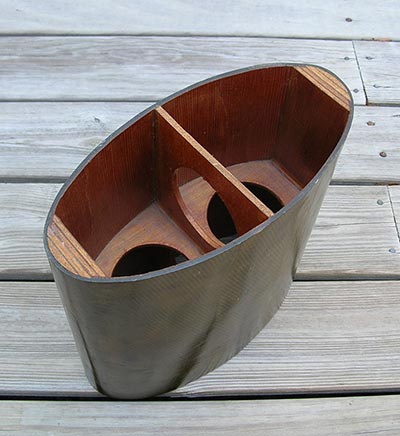

  3. brian eiland
    Joined: Jun 2002
    Posts: 4,962
    brian eiland Senior Member
    Carbon Fiber Mast, amateur built
    Not all carbon fiber mast need to be built in a commercial facility. Eric Sponberg developed some technics that some may find interesting. He has recently retired from designing, but has left us with new website that contains some of his histories and links to some of his extensive developments.
    Here is a link to his mast discussions, and a small quote:
    http://www.ericwsponberg.com/free-standing-mast-designs/

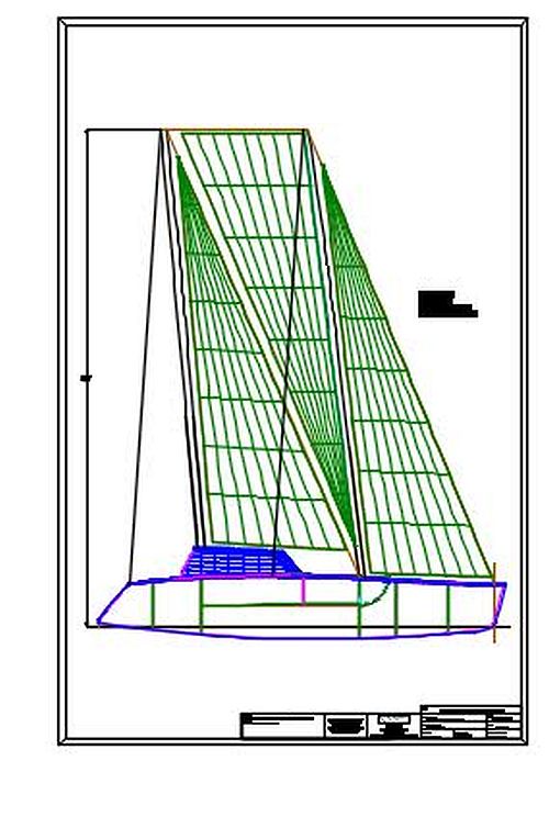

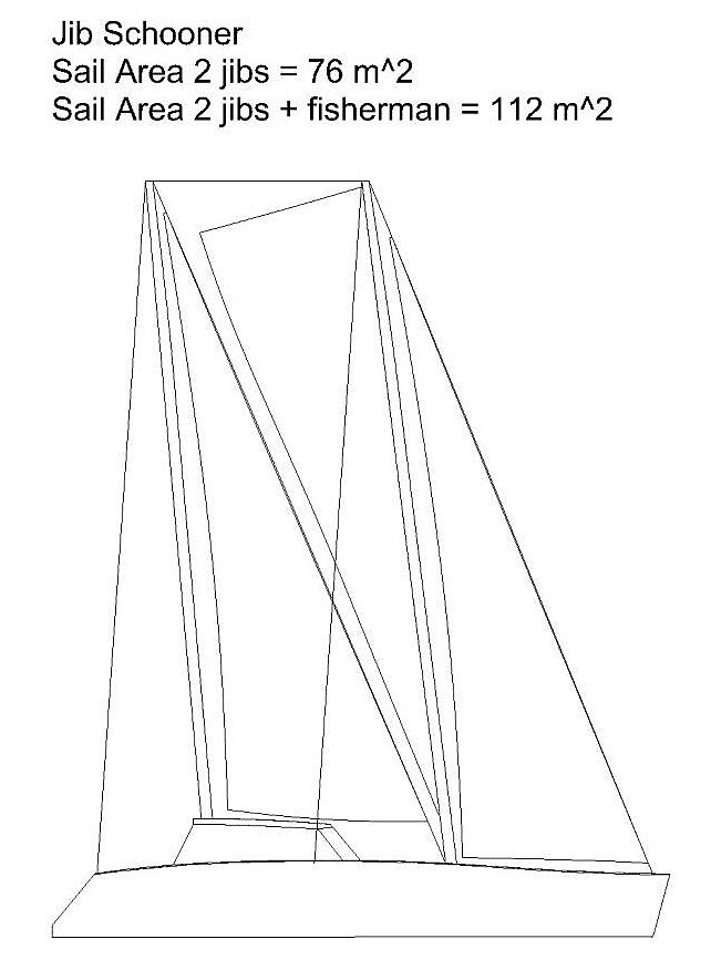

    50' cat with jib-schooner rig
    Meantime I have introduced a subject thread dealing with an alternative rig proposal termed a jib-schooner.
    50’ Jib-Schooner Sail Plan, Aero Analysis
    What intrigues me here is the CFD analysis by Doyle Sailmakers that touts the good upwind performance of the 2 parallel jibs,...without a mainsail.
    What concerns me is:
    1) the drag of 2 bare mast vs my single one.
    2) the non-overlap of the two jibs,
    3) the somewhat lacking sail area for light air performance,
    4) and the handling of a 'fisherman sail'.

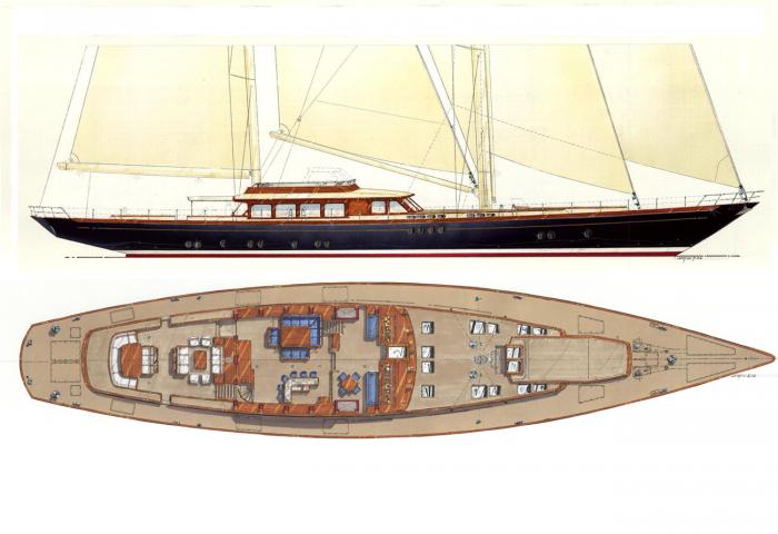

  14. brian eiland
    Joined: Jun 2002
    Posts: 4,962
    160' Staysail Ketch, all roller furling sails
    And I happened across this rig design for a 160 foot ketch
