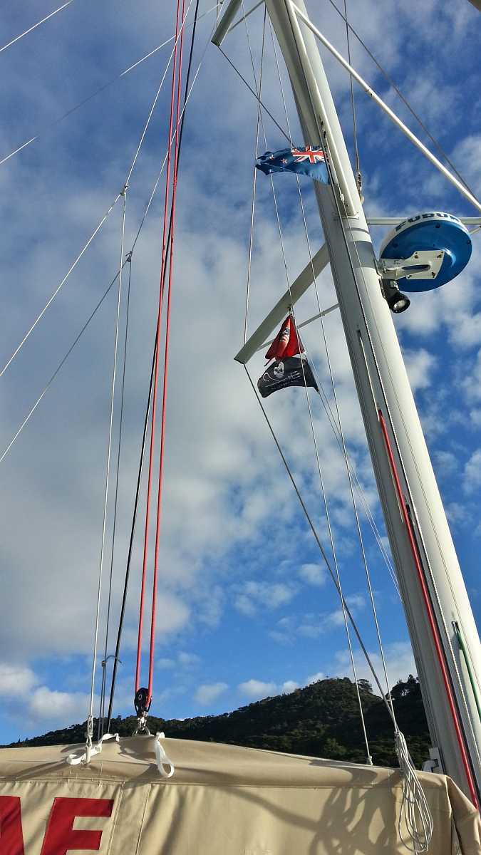

    Great threads. After reading them ages ago it made sense to fit a square top main. The info in them made it seem favorable to me. IMO you would have to have a bad preconceived idea about squaretops to begin with to read those threads and come to the conclusion they don't have many performance benefits. It would require a heavy dose of cherrypicking to ignore it all and stick to the few negative points, most of which did not even apply in my case. The most obvious benefit being the performance increase with limited mast size, which is exactly what aft mast rigs have, and is exactly what a person with an existing mast has when all they require is a new main and not a whole new rig. The extra drive up high may not be the best for tender boats with low RM, but we are talking about cruising cats here.
    Seems the cons just dont apply to cruising cats when it comes to performance. As for ease of use and cost? Well I can tell you from direct experience...
    Spiv

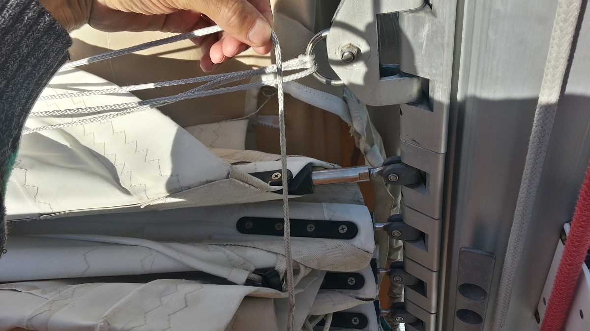

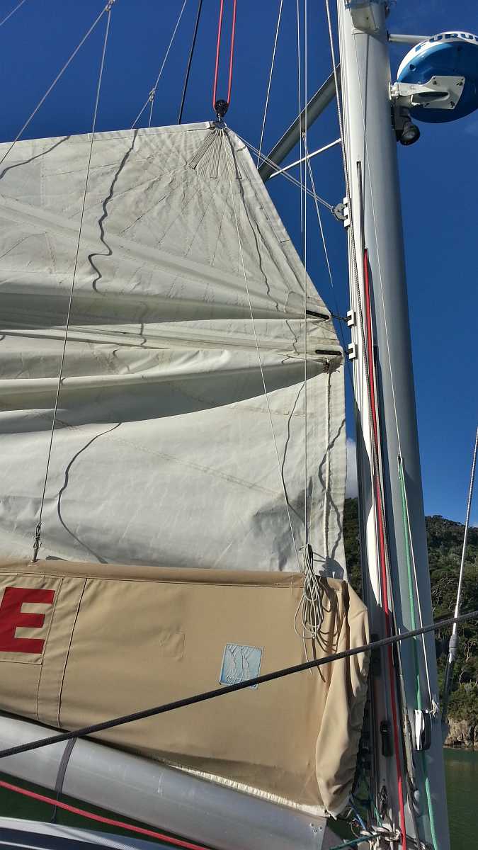

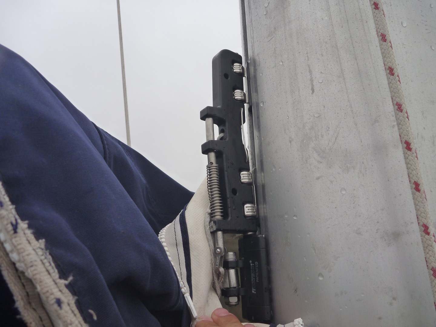

    Raising and lowering a squaretop main: Its easier to lower and store than a usual main. You just pull a string and the headboard disconnects. Then the most bulky part of the sail falls back into the bag and the top of the bag is about one foot lower making it easier to reach the zip.
    Raising, well you pull that same string to pull the spring loaded pin down and lock the headboard in after the main is raised about 4 feet. So the effort you won when packing the sail up is made back up here. Over all the effort is the same. But the device to do this costs $300, the sail it self costs only slightly more because its bigger. Not much when you just spent $18,000 on sails.
    The rig I was describing for my "one day" boat has the mast fairly well back and is a masthead rig with large headsails. The squaretop main is simply not used at all in situations where blanketing/shroud contact might occur on passages. The headsail/s will be much bigger so it wont do much for speed. If you can bring the apparent forward in the lighter stuff, well the benefit of the main is still there downwind. The boat I am talking about is very light and has much less space than a charter cat.

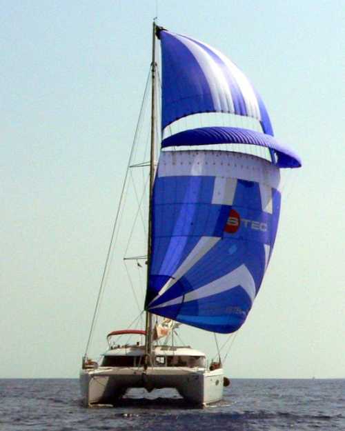

    I know Dennis, I had that system for 3.5y, trying to hook the headboard of my 18m tall sail on my own was always a big effort, to the point that at times I just could not be bothered raising it.
    Then, I installed a system with spectra line that made it all automatic, no more connecting and disconnecting the headboard manually, drop the sail in 2 seconds, raise it perhaps 1 min. See pic.
    My next boat will not have a main with battens on a track, but on a furler.
    Love furlers, see my twin downwind sailing pic. and love the Parasailor.
    Most purist will be horrified, but I am not a purist, I am a cruiser... Arrrr

    The difference with mine is that the headboard is positively captive via a pin, which makes it a little more tricky. The part is a prototype and has a few issues but I will be getting the updates.
    I like the pic with the screecher is it? and the jib wing on wing. No main needed. The dream boat I am talking about with a more aft mast and smaller main would have a large masthead genoa with a real furler (as big as my screecher), and a staysail on a furler for heavier winds. With both of these out and no main down wind it will move with ease. But as I say a lighter boat should be sailing at least on an apparent beam reach down wind, so the main will still be usefull most of the time. When its strong, well you just don't need the main downwind and the deeper angles will suit the headsails. But you do then have an efficient high aspect, high area squaretop main for windward work in stronger wind when sailing upwind with the staysail.

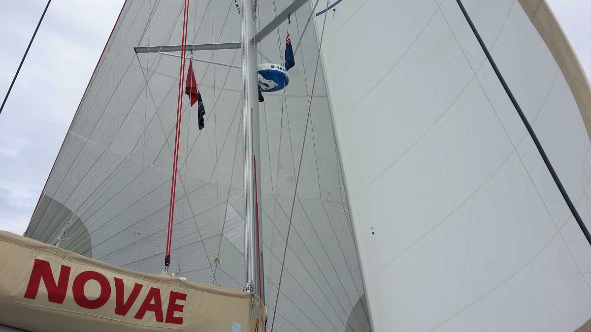

    I agree that its not a performance idea, but a cruising one. That, done well could well be faster for cruising reasons. The main reason being that cruisers often sail under headsails only because they could not be bothered raising their large mainsails. They might not raise them because they are single handing and have a large boat, or they are only sailing a shorter distance where its just not worth the time and effort to raise the main.
    The "moot point" about not needing the main anyway when cruising is not moot at all. Passage speed is important. When the main is smaller and the headsails are larger, you will be going faster under headsails alone. BUT, the important part is the mainsail (I am saying still use a decent size and high performance main) is that bit smaller so is easier to raise anyway. So for cruising reasons I think it could be faster, even if for racing reasons its not.
    I'm just using my own boat as an example, 70m2 main. 40m2 genoa. And a 70m2 screecher which is a fragile setup on a 2.5m pole and endless line furler (pic in this thread). Its not to be left up in strong winds (even furled) and certainly not for use single handed. Setting up is a PITA with the pole etc, and you would want a decent helmsman to get it down if the **** hit the fan rather than an auto pilot.
    The main is a PITA to raise and pack up alone. I think the boat would still have very good performance with say a 55m2 high aspect square top main (same height as now), and 35m2 heavy jib for windward work. I think this setup would be as fast or faster to windward than what I have now once the wind got to the point where I would have to reef my current setup (which happens fairly quickly) thanks to the higher aspect ratio. Sure in lighter winds, it will have less power.
    However, I now also have room for a larger headsail (say 70m2) on a real furler (single handed safe) so the power will be the same or even greater than before, but with this up it might not point quite as high (not as good for racing). Downwind, speed will be comparable, as sail area will be similar (the cutter rig means I can use both headsails), but it will be much faster with headsails only as the headsail area will be much larger.
    So its not fastest for racing, but for cruising its probably faster unless you cruise your boat like a race boat.
    I would just like to add, I am usually the one flying thier mainsail when everyone else is just using thier jibs (when I'm not alone anyway). Seems a normal affair in Moreton bay for the weekend cruisers to not even bother with unpacking their mainsail bag, even in light winds. For them, the main is a waste.
