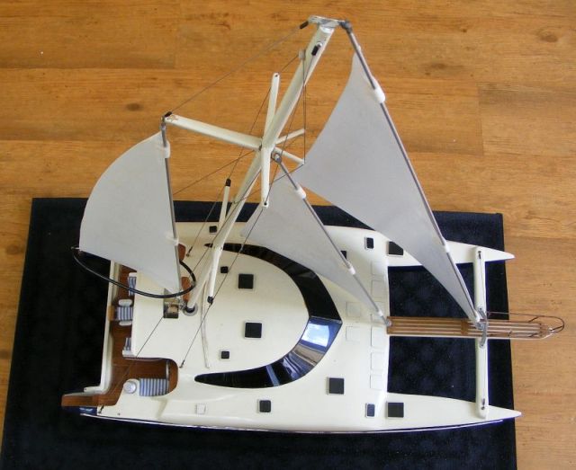

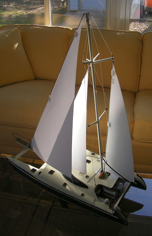

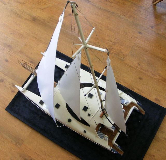

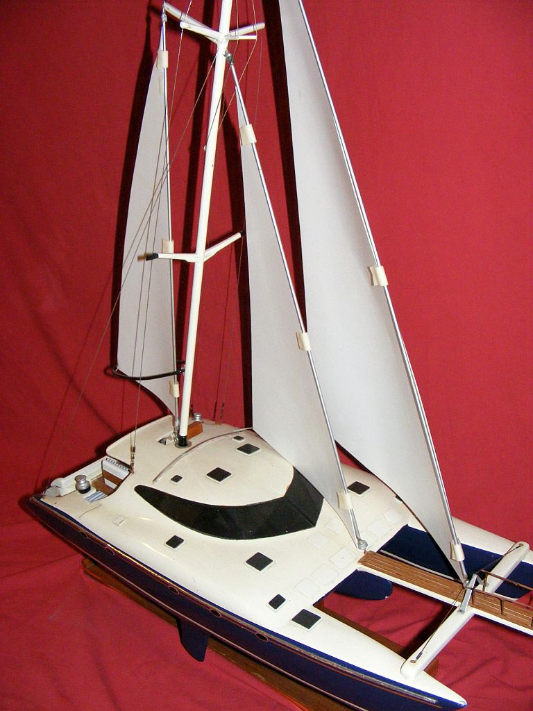

Somehow I forgot how to post that image above to a comparable size to the Comanche photo??
...few other images to compare with
