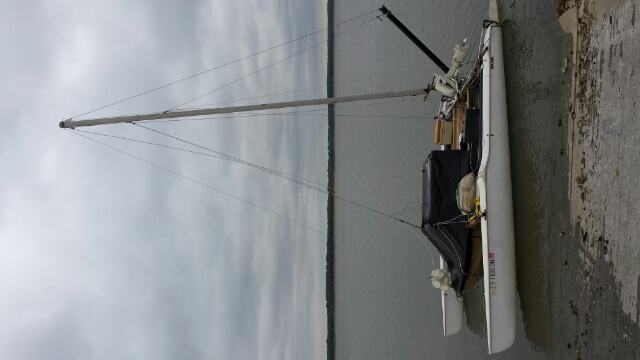

    Well went out for the first time in 20 mph winds that gusted to over 30. The rig held at least. Way too rouph for any good data. Still need to work on sail rigging layout. Lee helm is an issue. As is the need to be reefable. It is easy enough too switch sails in windy conditions at least. The pummeling was was taken well. As the out rigger mounts are stought and the boat is rigid. None of the twisting flex that I had last season.

    Hey Mark,
    I think you could clearly use some better sails. :)
    Why don't you see if you can rotate those images around so they are straight up,...:D
  6. markstrimaran
    Joined: Dec 2014
    Posts: 291
    Likes: 6, Points: 28, Legacy Rep: 28
    Location: usa
    markstrimaran Senior Member
    sails
    Ya I sure do. Sailing upwind on a 45.00 ebay sail. Modified on a 1973 Sears sewing machine. The knowledge learned is priceless. As long as the Johnson starts on the second pull.
