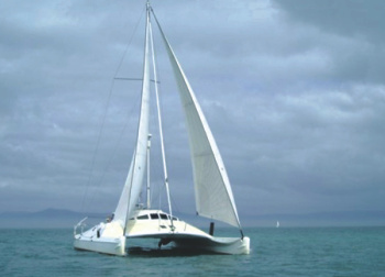

    Looking at the mast location, a jigger seems like a no brainer to me. The other thing that could be done to increase sail area without a huge mast might be to rig two head sails instead of one, and attach to the bow of each ama. I've seen this done on catamarans as in the photo I attempted to post. Hope nobody is upset about dredging up this ancient thread ;-(

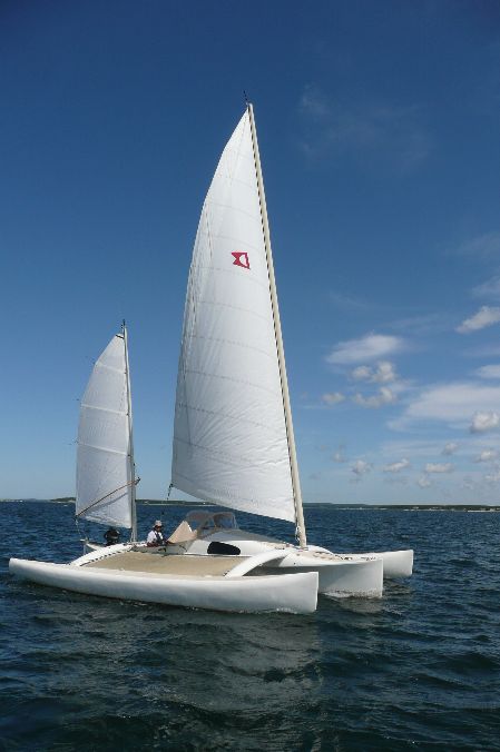

    This is really interesting stuff. I have to admit that I have trouble sorting out what I am looking at in some photos and drawings. This elegant little yawl rigged trimaran caught my eye. It's a Newick design with a ljungstrom style loose footed double main sail that is used as one sail on most points of sail, but opened out into two sails, wing and wing, for downwind sailing. There truly is more than one way to skin a cat. I've attempted to upload photos of the Newick yawl trimaran as well as one of the Viggen which shows what the sail looks like opened out sailing wing and wing, and a third of a catamaran similar to what you have been describing I believe. Looks like it is designed to fly as many as 3 headsails, one to each hull and one to the center.
