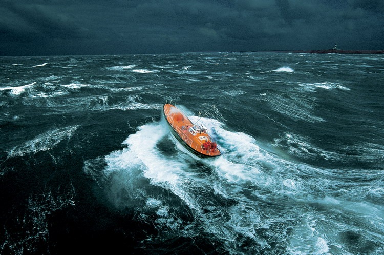

    French life boat. Brest
    http://[​IMG]

    Stability both intact and damaged are the design criteria for the vessel form. Not the height of the topsides proportional to the length. Lifeboats have to fish people out of the water and the Dutch lifeboats are necessarily constrained in draft. How much of an internal fitout do you think that vessel has ?
    You could easily make a very unsafe vessel with those proportions and there are far more as you say " successful DISPLACEMENT seaboats"with quite different ratios, in fact I'd suggest the majority.
    Coastal life boats are single use craft designed for a geographic area and wrapped around the operational compromises.

    When you look at the photos of the rescue boats/ life boats like this...
    does it make you wonder at all if your boat and your engineering could handle a situation like that? I mean, if you found yourself in a situation like that, on an earthly level, you do realize God is not going to just pluck you out of it and put you somewhere all warm and cozy? You do realize you will probably die, don't you?

    Because of the scale effects big boats are more stable than small ones, so can have different proportions
    Look at the photo above and imagine being broadside to those seas (and please don't say that will never happen)
