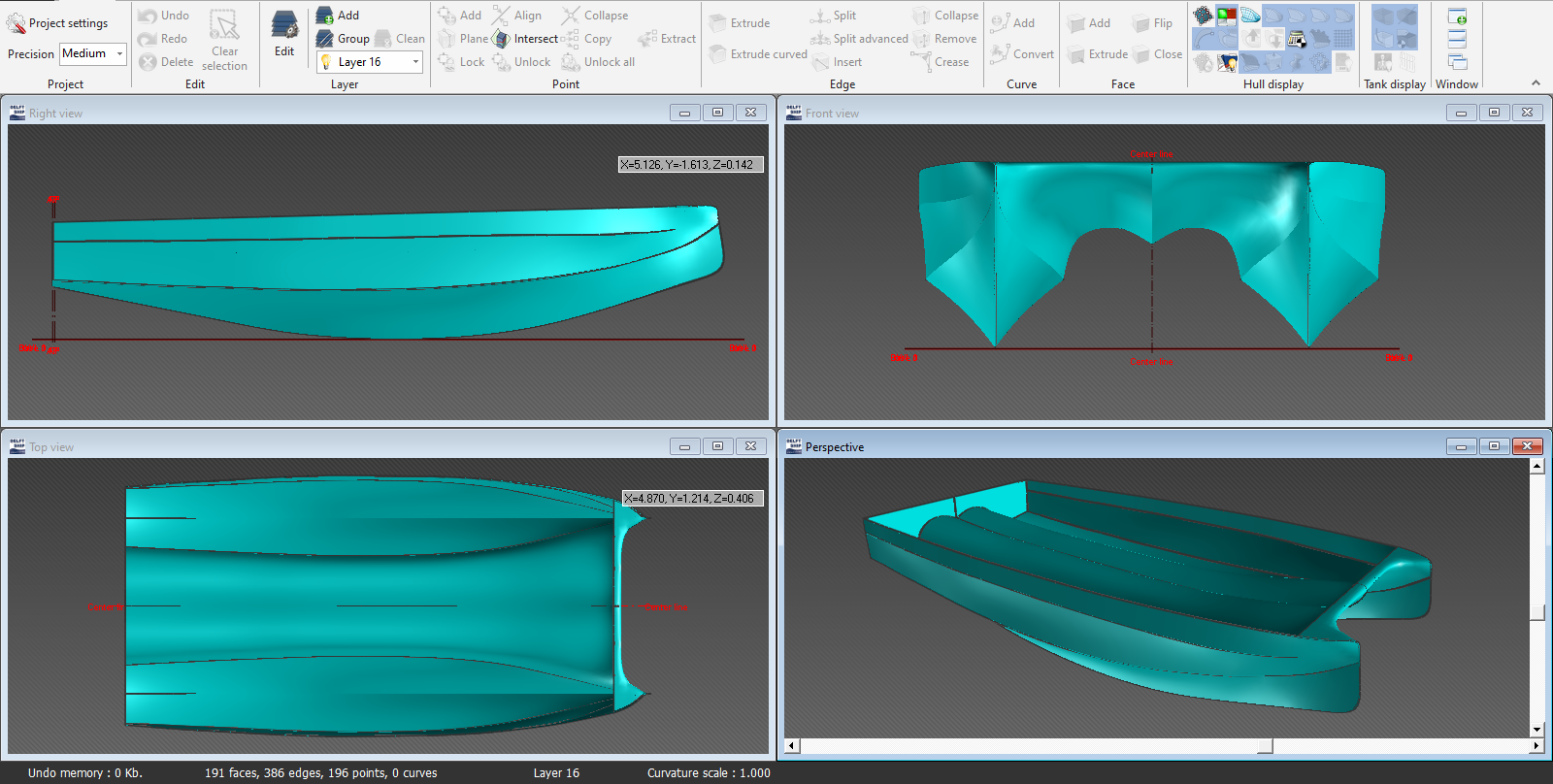

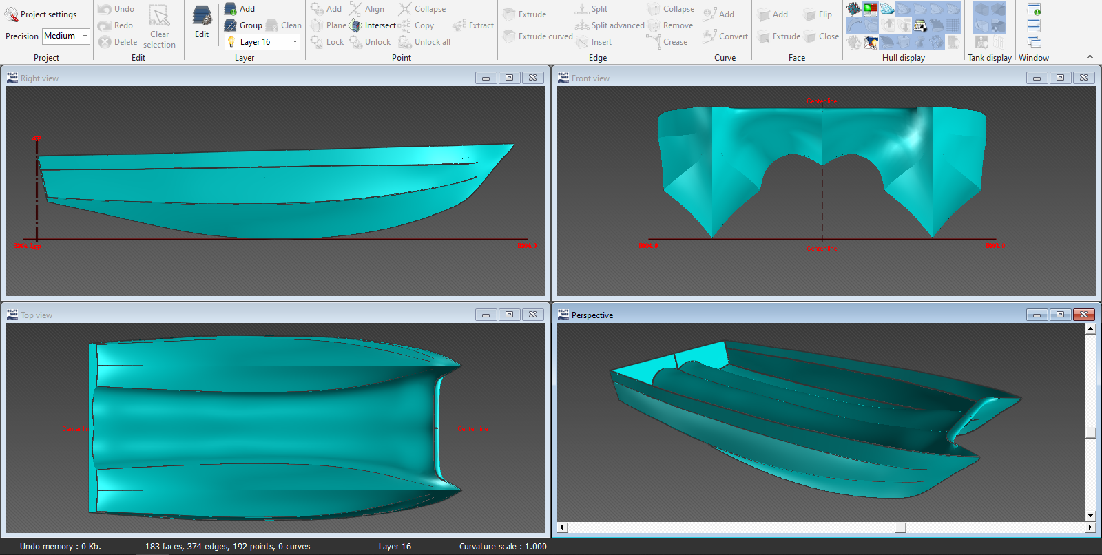

    True, very true, at the moment i'm just experimenting with the hull and running the simulations.
    Draft is at 0.7m and air gap 0.35m so added wavesplitter underneath (image attached)
    Experimenting with different bow and aft and ruining simulations for performance improvement (attached)
    The height of the catamaran from WL to the top of superstructure so far looks like 2.5m (or from floor /main deck/ to top 2m)

    Air gap 0.35m could be too low a figure, unacceptable, although it naturally depends on the design category of the boat.
    In my opinion, the shapes you have at the moment, the tunnel, the wet deck, seem unnecessarily complicated. Try to create shapes appropriate to the ship's SOR and don't limit yourself to just what you can do with the rendering software. Why such a deep "V"?

    Yes, cat is intended for coastal cruising
    The "V"shape hull allow to grip the water when beating the windward.

    The sensible thing to do is buy a used Catalac, sail it for a season and then you'll know what changes to make. Or maybe you have already done that? I agree with Tansl, leave the pretty pictures for now. Design the boat first. Then draw it. Then do the pretty pictures.
