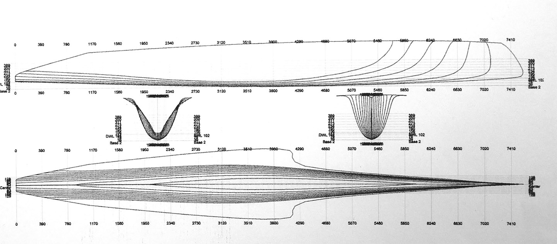

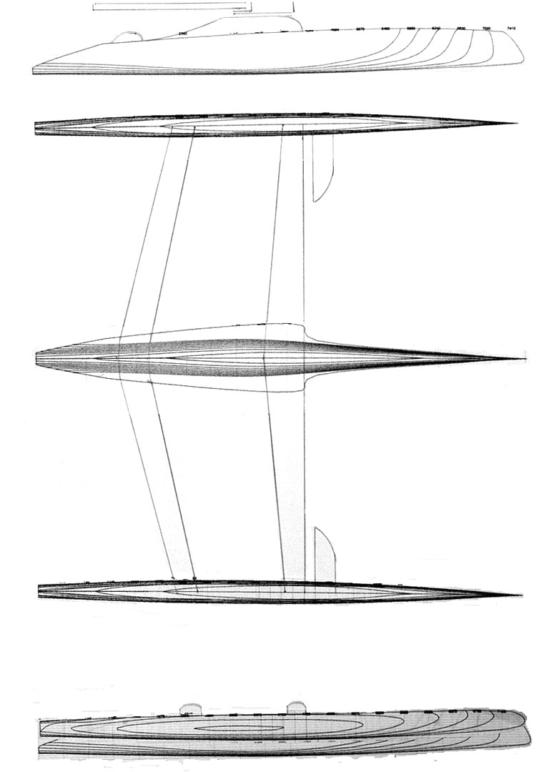

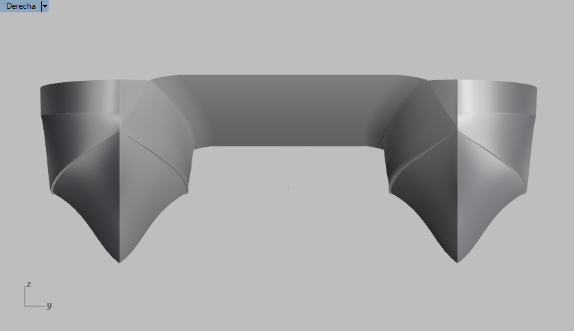

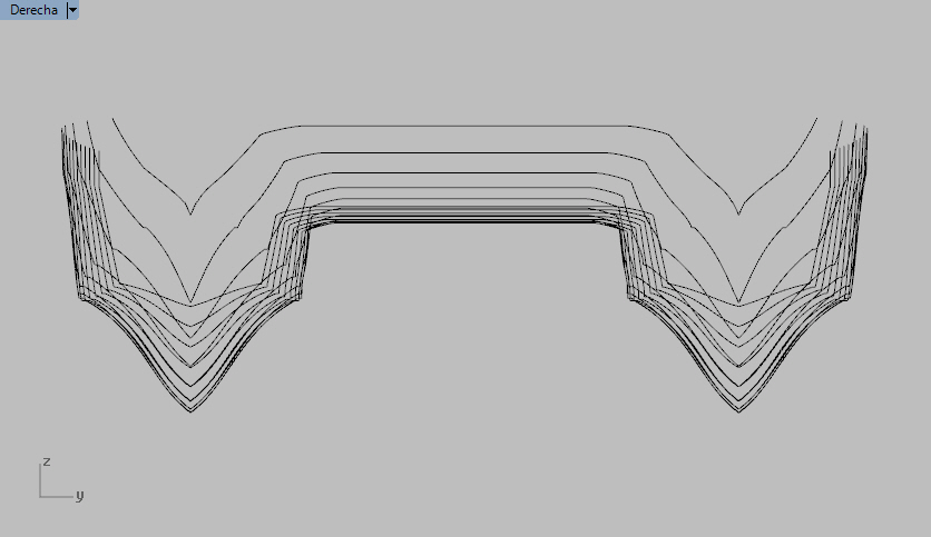

    Hi All,
    I had an idea to take as a base/inspiration and old successful catamaran, designed and fabricated in the UK in the 80s, (which is out of production by now), but still around and develop a new modern version, and if successful put in production.
    Based on old photos/videos and info i've drawn the form plans and done some calculation of the old model (non of the old drawing/calculations survived, or can be found).
    Next stage, will be to modify/model and improve the performance of the hull.
    Or should i start from scratch? forget about the old cat?

    In practice, it is a matter of starting from scratch because, as in many other cases, you start with the b ody lines plan of a similar boat and start to modify things until you get the boat that is closest to your SOR. Of course, in the case of an old design (more than 30 years), it is very likely that the scantlings are oversized, so it would be best to calculate them again. After that, all the weights and their CoGs must be recalculated and the extent to which the old fairing works or does not serve the new conditions must be checked. Perhaps the new arrangement of transverse bulkheads forces the position and spacing of the frames to change somewhat, and so on ....

    I think you would have to start from scratch really - but I see that you have drawn some plans. Would you be happy to share these with us please?

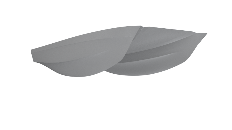

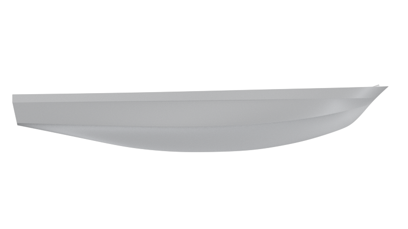

    Yes the hull design of now and then is very different (also the software and material availability - planing to go for carbon with honeycomb core),
    but at the same time i don't see anything wrong with the "V"shape hull design it has pros and cons and always can be improved.
    I really like the all set up and compactness of Catalac 9, can say is a smart design and was using many futures of the time,
    I don't try to build a performance catamaran like Outremer or HH, but more like a family weekend or coastal cruising catamaran,
    BTW there is no modern entry level 9m catamarans (except SmartCat) plus is more like a modern cat just scaled down.
    Ultimate goal of my project would be:
    1. Smart and compact 9m x 4.5m (intent for family coastal and weekend cruising)
    2. Use of Solar Power (something similar to silence-yacht)
    3. Electrical Propulsion (something similar GreenStar marine)
    4. Wing Sail.
    Everything comes to price, Yes everybody want a big catamaran, but not many can afford it as a used one start from at least 200k,
    plus it comes with the age related issues/problems etc.. maintenance of a used cat after 10 years is very high.
    Have attached some Catalac 9 model screenshots and design analyses if somebody is interested.

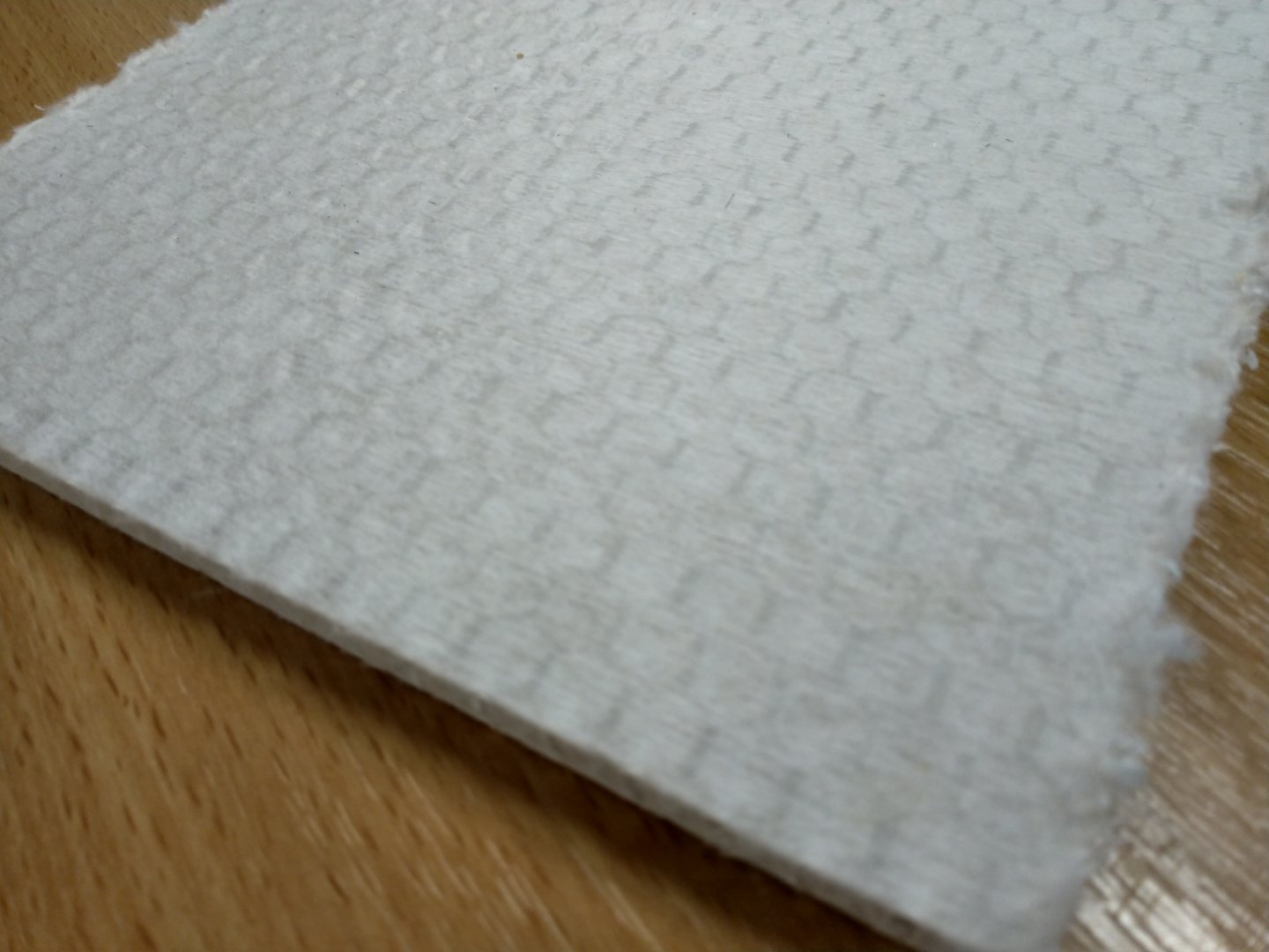

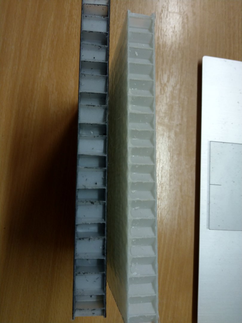

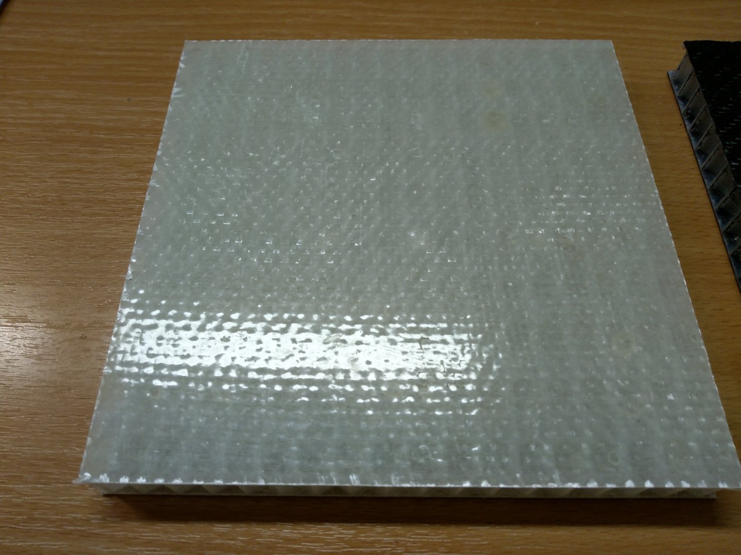

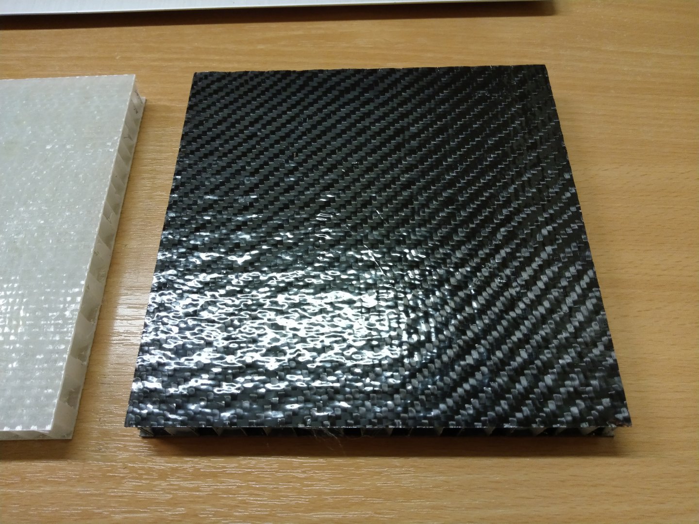

    Yes, a good mould + infusion and moving away from fiberglass to carbon is the way to go,
    I've done some experimentation and testing of performance for carbon combined with rigid honeycomb vs fiberglass.
    Attached some picture of the same in fiberglass and carbon fiber (two layers 300gms + 15mm honeycomb + two layers 300gsm)
    results of the same size samples 90gr vs 120gr also both samples are very rigid and stiff

    In addition to the 3D models that are very nice but at the moment do not say much, I would draw a General Arrangement plan, to verify that each thing has a place on the ship and that this place is sufficient for each thing.
